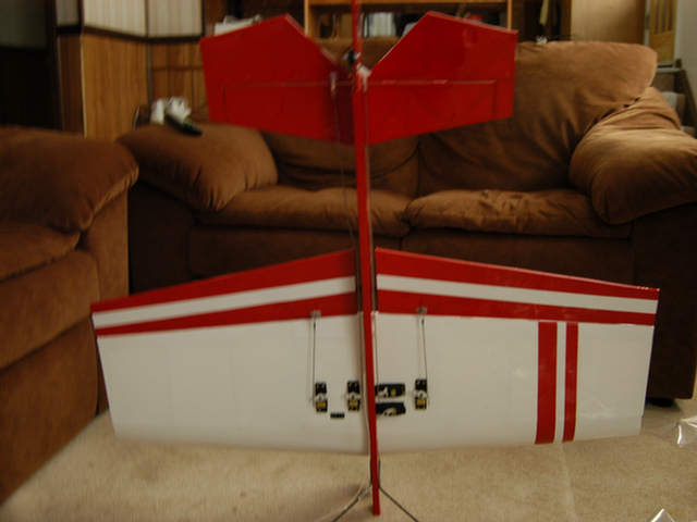

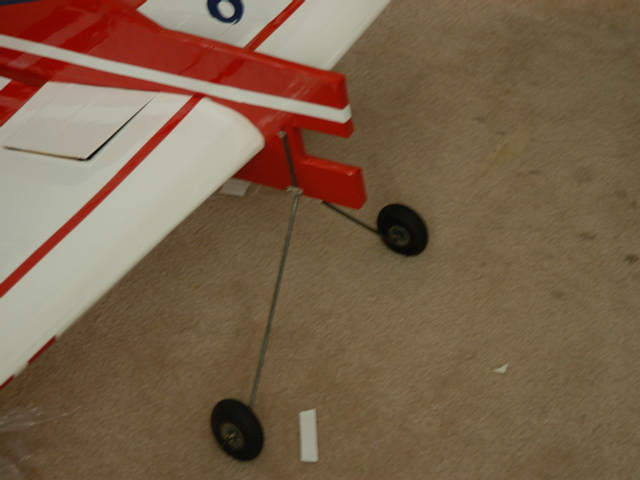

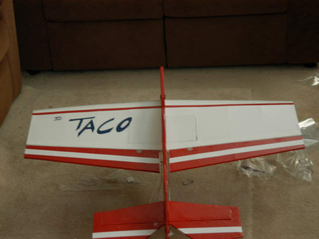

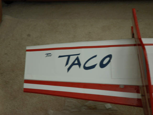

here is my BABY!!! done and fresh OUT THE OVEN!!!!! hehe... what do you guys think of my first covering JOB?

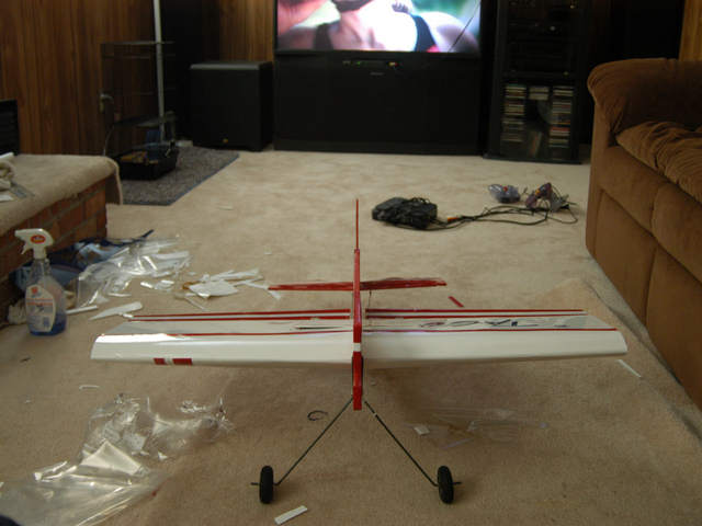

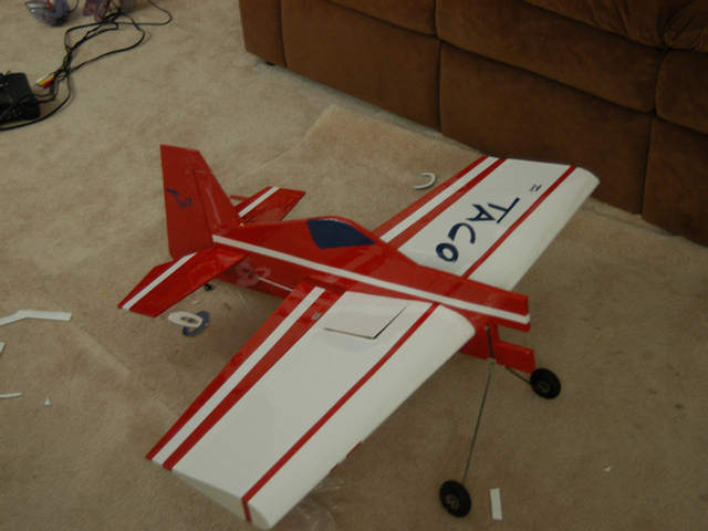

here MORE!!!!!

Hey xoon, that's a fine looking model. I'm sure you'll have a great time flying it.
One little thing I would mention, I notice you have the adjustable arms on your servos. I have used these in the past on control surfaces, and never had a problem with them. However I was informed that these are intended to be used on throttle servos only--light loads, not control surfaces. So I got with the program, and now use the solid arms for all control surfaces. As you get into bigger models, more power, heavier servo loads, etc. the issue becomes more important. They are a convenient way to adjust your throws, but not as convenient as the adjustable travel settings on digital transmitters.
Anyway, not to quibble, you should be proud of a good piece of work. Have a blast with it!

good job, yes i agree with majortom, i have heard of those type servo arm failing.

thanks for the input... i was looking at the crash forum, and saw a picture of a crashed Borrito. i made me wonder what was the CG on my plane. so here i am asking the question...
What is the CG on this plane? remember i scaled it up for a .40 engine... so can i have the percentage.. please try to be exact as possible because this is my first 3d plane and i don't want to goof anything up on the maiden... thanks a lot

Target 25 - 30 percent of wing cord for CG...

I think you can probably push it to 30 percent without it being too tail heavy... or you can set it more conservatively and fly it.... Get it trimed straight and level, then flip it inverted.... if she sinks, she's nose heavy... climbs, tail heavy...

measure your wing chord where the wing and fuse meet. When you measure it take that number and divide by 3. or divide by 33%. 1/3 of the wing chord! Measure from your leading edge back the number you just came up with. Right where the fuse and wing meet. That is your C of G.

ok... i went out to maiden yesterday. the wind was calm and the sun was almost out. took it up and all i can say is THIS PLANE ROCKS!!!! i trimmed it out needing some up elevator. then i trie out some aerobatic tricks. flat spin is flatter than a pancake!!! at low rate the roll rate was fast... and snap roll is VIOLENT!!!! all i have to say for this plane is THIS IS THE BEST PLANE. i want to thanks everyone here that helped my in anyway.. w/o you i don't think i would have made it.
the CG was right on i balanced it at 30% of my root chord of my wing and it came out balance nothing was needed to balance it. and at 30% it flew great. thanks a lot
