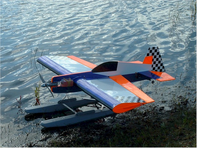

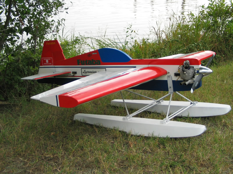

It's been done lots of times and it's VERY easy. Just use 2 pair of profile gear (tetherite or williams gear) and attach to floats.
Now on some profiles you may want to cut out a piece in the fuse to put a hardwood block somewhere for the back gear. Unless you find some wood to use to mount them.
You don't have to go any extrmemes like the Red/White/Blue plane, that's an 80"er.
