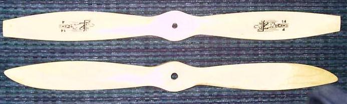

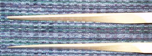

Paul, I will try to post some pics when I get a chance to take some. It is mostly trial and error. The tip profile is like a APC in shape, and the blades are thinned. I start with balancing the stock prop. Then re-shape the tip, and re-balance. Then thin the leading edge, and re-balance. Then the same for the trailing edge. Sand and seal with thin CA, and balance. Now flight test. I don't believe in tach readings the proof is in the flying, and throttle response. The prop that Jeff had started as a 12x4 Zinger. It was a little to much for my HP.40. I use a 11x4 for it. All work can be done with a sanding block with 80 grit paper, then smooth with 220 or finer. You can also try a Dremel with a sanding drum, but it is easier to mess things up. Tom

I've got some 12x4 zingers... and an Irvine .53 to run them on.... I'd love to see some before and after shots of the tip profile. You seal with thin CA?? Why not a quick coat of lacquer?

Paul, we use to purchase blanks (so long ago I don't even remember from who, Brodrick racing - or something like that) and carve our own props for pylon racing. We used CA to coat the wood props when we were finished carving on them because it was quick, readiably available, and easy. I'm sure that laquer finish would be fine too, since most of the wood props come that way anyways. I also believe that the thin CA was lighter, and would penetrate into the wood better over the laquer. This way, when you did your final sanding right after you coated it with thin CA, you would hopefully still have some protection from the elements (especially for those guys that fly in the rain LOL) after thelast time that you balance it. As 3Dreaming indicated earlier, there is allot of balancing to be done. Balance between each step. I just don't have the time anymore to mess with it.

Paul, the lacquer I had tried would soften when it got fuel on it. This made the props feel sticky. The thin CA is much faster. I didn't have time to do the pictures today , but I should have tomorrow. Tom

Here is before and after pictures of a couple props. The sizes are 11x4, and 14x4. Both started as Zinger props. The stock 14x4 Zinger on my Sledge made it fly terrible, but the modified prop is the best I've found and I've tried a bunch. Tom

Wow... That's allot of hackin' and hewin'....... What do you use for a balancer? I'm going to try this with a zinger 12 x 4 and see what I get....
Do you blunt the leading edge at all? use a pitch gauge? sand trailing edge to a point?

Trailing edge.

Leading edge. I use a Dubro balancer, but there other good balancers out there. If they still made Rev-up props in the sizes I want I wouldn't go to the trouble of carving, but the trouble is worth the results. For my HP.40 the only prop that I've found that pulls better is a APC 11x3, but I don't get the throttle response I want. Tom

Bugs, In the props I pictured the small one is a 11x4, and the larger is a 14x4. These are the sizes I start with, and I don't try to re-pitch the prop. I try not to shorten any more than needed to get my contour. I do end up with more camber for the airfoil because of the thinning of the leading and trailing edge. Tom

3Dreaming - do you go with a blunt leading edge or to you sharpen it? I though if the le were blunt it would lessen the "stall speed" of the prop... sorta like an airfoil would... Just thinking out loud...
