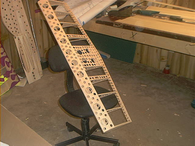

what do you all think of one with an all up flying wieght of 2 1/2 lbs. i have it all figured out i think it should wieght that.

Mine weighs 3 lb 8 oz with Saito 72 and 2 oz tail weight. I also have the DuBro FG fun fly LG which aren't all that light either. I didn't drill any extra holes but I used all contest balsa. Transparent Monokote, HS225MG's, HS81 on throttle, 5 x 1000 mah NiMH. The engine is definitely too much for the plane at this weight as it accelerates vertical like a rocket! I could get away with a smaller engine, get rid of the tail weight, and come in at right around 3 lb. I think even a 32 2-stroke would hover the plane at that weight.

holey swiss cheese batman!

yeah we are using hs 81's all the way around and a 250 mah battery. it will fly or crash , we are just interested to see what you can get away with. :stupid:

Looks like Coony's plane flew to close to the duck pond!!

WOW!!! Love to hear how it goes! How long did it take to put all those holes in? How'd you do it?

not all that long i made a cutter to cut them with. maybe an hour.
