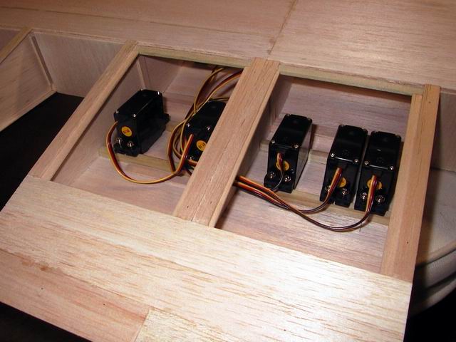

I have just began building a Knife kit, and I want to build it with inside-the-fuselage push-pull elevator and rudder as desired by Morris. I have never built a push-pull profile before, and any info on exactly where and how to install the servos for the rudder and elevator would be appreciated. The instructions don't seem to be very helpful. Thanks!
Old 12-31-2002 | 04:14 AM
Posts: 6,378
From: Bloomington, IL
Default Knife Push-Pull
These are pics from my Morris Hobbies Sledge. Not the same plane but servo mounting on a profile is basically the same model to model.
They should help you a bit.

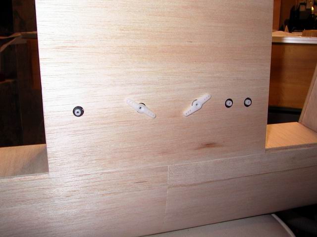

One more.

Ok I just realized that on the Knife there is alittle bit of a difference.
Your rudder and elevator servos will be on opposite sides of the fuse..

If I am seeing your pictures right, they indicate the top of the servos is on the bottom of the wing and the hatch covers on the top?
Yes, Thats correct.
It gives the servos a much sturdier mount then if they were mounted to the hatches ( if the hatches were on the bottom )
Some people do it that way..

On the sledge, why did you put both the elevator and rudder servo on each side?
Old 12-31-2002 | 04:32 AM
Posts: 6,378
Thats what the plans called for.
I though about doing it the other way but just decided to stick with the designers design.
It did make routing the pull pull cables easier though prior to sheeting as all but one enter and exit on the left side.

Wayne--In your pictures I guess I am missing something obvious, but don't the cables from the elevator interfere from the cables from the rudder?
Lee
Old 12-31-2002 | 04:45 AM
Posts: 6,378
No.
The entry points in the fuse are staggered a bit and on top of eachother. It works.
The knife will be easier as the elev and rudd servos are on opposite sides.

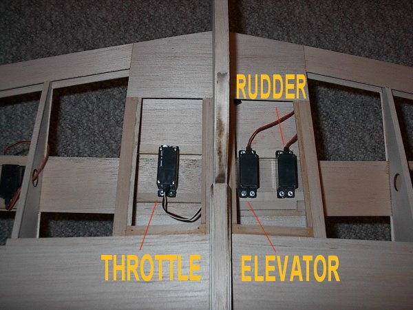

Here's a "real" Knife.
This is top of wing, looking down.
Aileron servos are outboard. Rudder and elevator are inboard, throttle is in the middle on the right side.
Spacing is determined by:
Rudder/elevator- leave enough room to clear the fuse with your servo arm
Ailerons- So the control horn on the plans lines up with your servo arm
Throttle- close to the inner as you can get without interfering with the pull-pull arm (throttle is push-pull)

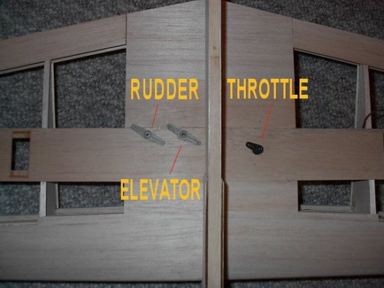

Old 12-31-2002 | 05:22 AM
Posts: 368
Bottom. Sorry, best pic I have of the setup on the bottom.
