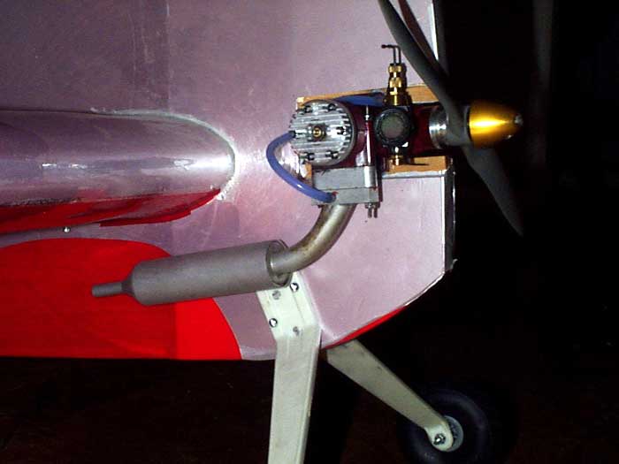

Default Loaded
MOTOR

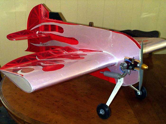

Old 03-10-2003 | 08:57 PM
  #54
Posts: 2,924
From: Nashville, TN
Default Pics Later
I've started using my cell phone as a modem (boss was tracking my RCU ways ) and I can't seem to upload images only text. I'll upload the finished text tonight.

Default What muffler ?
Billy, what muffler/pipe is that you have on your Irvine there ?
Old 03-10-2003 | 09:16 PM
  #56
Posts: 2,924
From: Nashville, TN
Default Morris Gee Whiz Bee Progression
I found that pipe in my LHS. I said "hey, what the h3ll is this?" He said it was an old pipe Irvine put out for their .40s. It's called a magic pipe or something (in college I had my own special kind of magic pipe). It is nowhere near the UT muff but I'll give it a try. It sure looks cool and it was cheap...$20 I think.

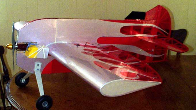

Default Opposite
Tank side

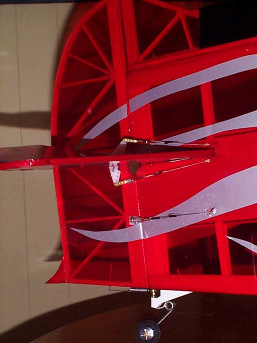

Default Tail
servos

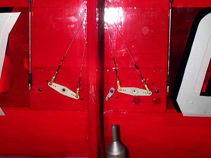

Default In Wing
Pull pull

Default DuBro LG?
Billy - are those the DuBro LG on that GeeWhizBee that I see? If so, you better keep your eye on them. You've got the bolts in the wrong place. You have weakened that LG severly. I've seen numerous ones of the DuBro LG mounted that way break and go thru the wing on a normal landing. Watch it!
Just some friendly advice.
Kevin
Old 03-11-2003 | 02:02 AM
  #63
Posts: 1,280
From: conway, NC
I think they will be okay if he just moves his bolts to the thick part on the sides. All I buy are these same gear and they work perfect................John
Old 03-11-2003 | 02:51 AM
  #64
Posts: 2,924
From: Nashville, TN
Yikes. Didn't even think of that. I was just trying to get it to line up with the blocks. All my others go through the fat part. Guess I'll do that tonight. I wonder if I will have to move them. Could mess with my CG.
Old 03-11-2003 | 03:26 AM
  #65
Posts: 2,924
From: Nashville, TN
What a drag. The Dubro gear is wider than the blocks in the fuse. I'm going to try and drill through the blocks and braces. They are glued pretty well. The only other thing to do is use the stock gear and then my CG is blown and my gear is just aluminum.
Old 03-11-2003 | 04:26 AM
  #66
Posts: 1,280
From: conway, NC
Billy, I would just put 4 in the center part. Two at top and two at bottom. Use washers. I have one like that and havent had any problems.........John
Old 03-11-2003 | 04:43 AM
  #67
Posts: 2,924
From: Nashville, TN
Default Good Now
Well she has almost no AOA but the gear is in securely. This thing should handle like a race car on the strip.
Ulf - Here is a better picture of my Irvine pipe.l
Old 03-11-2003 | 05:54 AM
  #68
My Feedback: (12)
Posts: 5,133
From: Pampa, TX
Default Magic Flute..
I mean Magic Pipe...well actually I think it's called the Irvine Super Silencer, but I won't tell anybody. Magic Pipe does have a bit of nostalgic familiarity about it

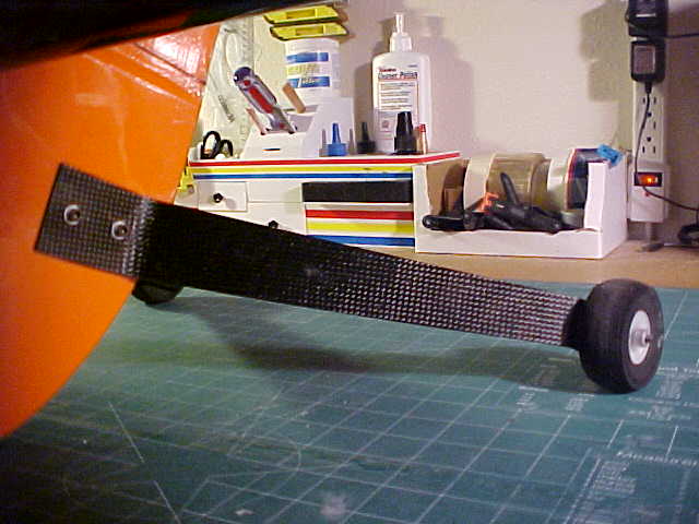

Old 03-11-2003 | 03:06 PM
  #73
Texas 3D's Avatar
My Feedback: (16)
Posts: 2,666
From: Houston, TX
Hey Billy, here is my CF landing gear on the GWB. Throw that Dubro Gear out, and get you a Tetherite Gear or CF Gear from Jeff. This particular one I got from Kevin last year. Came off my Goldberg Extreme (so did the wheels)
