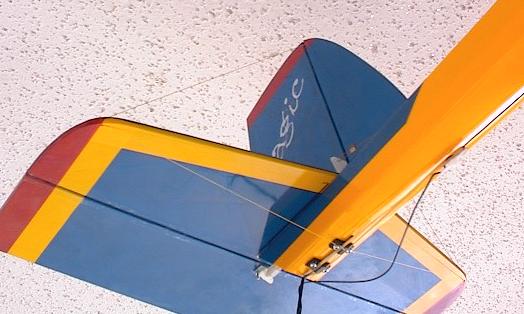

There was a clear plastic tube about 2 inches long by3/16 diameter in the bag with the braces. I went around the tail with kevlar thread.

Cabane, good idea. How did you attach the thread to each tip of the stabs?

I haven't built a Magic -so I don't know the intended use of the clear tubes BUT
I've seen ny-rod put in a stab & fin for kevlar thread to run through to make flyin-wires.
You just drill a hole the size of the tube - ca it in place and cut it off flush. Then when you run the thread thru, it won't cut into the wood.
Just a thought
eddie

But in order for the flying wires to be effective dont they have to attached to the stabs as opposed to simply passing through them?

Duh. Using the tube for clevis retainer didn't even register. I automatically use fuel line.
I just threaded the thread thru and injected thin ca in the surrounding wood with a hypodermic.
