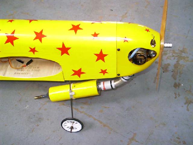

A good trick that I found to bend your stingers is to insert as many small tie-wraps as you can possible get into you stinger tube, then you can bend it gently without kinking it. Then you pull out the tie-wraps. Thats a little easier than melting solder in and out of them.

Good grief ....I just got some K&S 1/4'' tubing from the shop and I declare it looks awfully small for an outlet. Does it really work okay??????????.....John

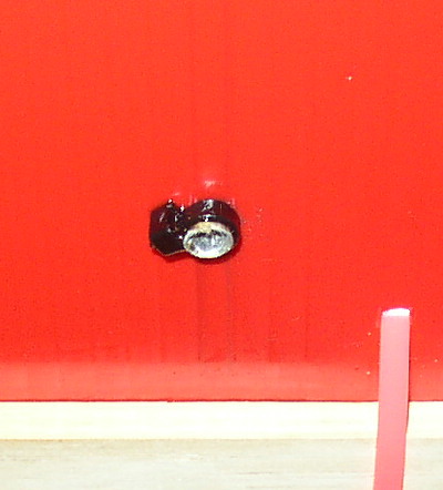

John, yes the 1/4" tubing works good for anything .46 and smaller. Here is a picture of a mousse can covered with monocote to match my airplane. Tom

Does the monokote stay on good? Did you just pull it around and seal it to itself?...........John
