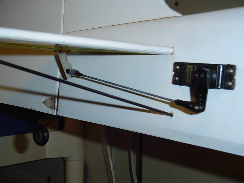

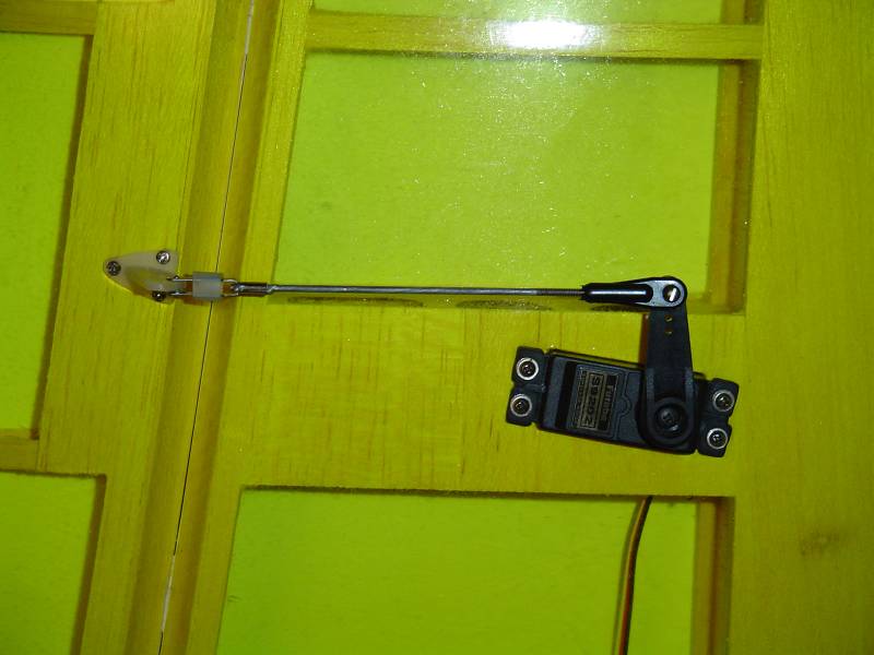

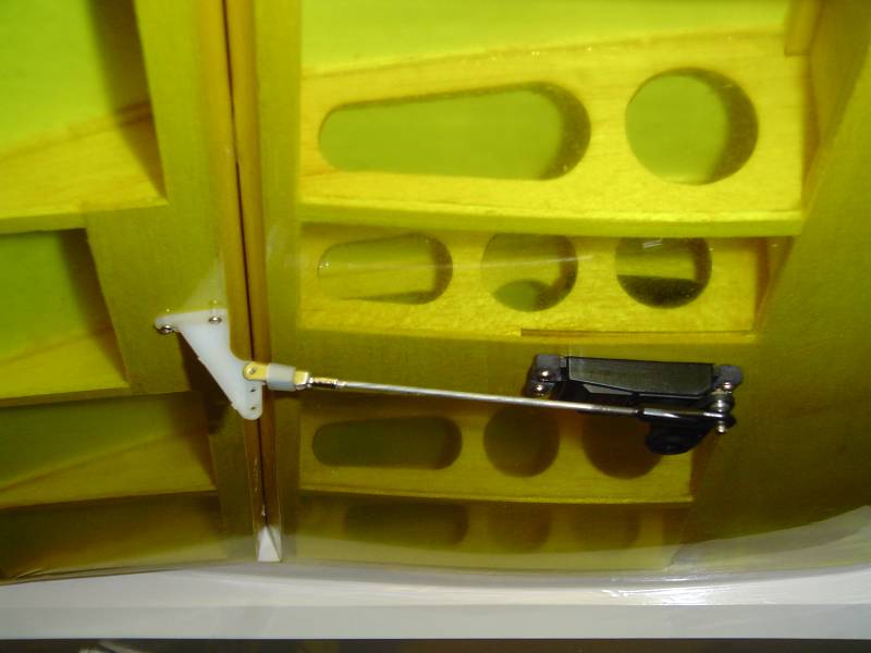

These are Du-Bro ball links. For a high deflection surface these do create a slop free no bind setup.
david

I use the CA hinges. If I need to buy them I buy the Great Planes ones. On the Fusion I used the supplied hinges.
David
