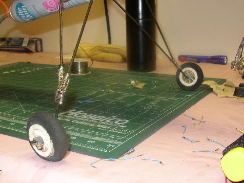

Default The Magic Stands Again ! ! !
Well I had to show off my not so pretty handy work on the Magic gear. But I guess I'll prefice this by telling you that 2 weeks ago while in houston, I flat spun the Magic into the ground due to having my rudder chewed off by a propeller (mid-air) of an oncoming plane previously in the flight. Needless to say that when the Magic smacked the ground, the gear that was already held together at the lower tack welds, were then held together with duct tape, broke into 5....yes 5 seperate broken/seperated peices....LOL. One of the pieces happens to be about 2 inches of the lower axle.
Let's just see how long it takes me to bend them up again

TailSpnr,
Those landing gear don't even look used!
LOL!
Do you remember what mine looked like when we were at Houston?

Tailspnr,
Go to the hardware store and get a small cylinder of MAPP gas. It will work with any propane torch tip you may have laying around. In addition, get some 3/32 prefluxed brazing wire. You can fix Magic gear and/or make your own out of 1/8 music wire from your LHS.
I've busted mine a bajillion times, but they never break in the same place twice since I started brazing them myself.

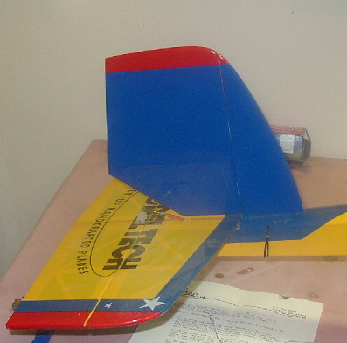

Lazy Pilot, Ive already got the mapp gas. Had to buy it last year to repair the water jacket for my boat.
I was at the LHS the other day and looked at their music wire selection and the proper diameter of wire seemed extremely heavy as compared to the stock Magic wire. But Im sure Im gonna have to figure out something.
Take a look at my new rudder. Latch...you remember what it looked like. I actually made this just a hair taller and about a 3/4" deeper.

I had broken my gear when the engine leaned in a low hover. So I too made a trip to the LHS and bought 1/8 inch music wire. The only 2 pieces he had were really shiny, chrome like. I bent the pieces up and TIGed the together. The metal was really crappy and the weld mad it really brittle. So I had the LHS just get a set of replacements. Now its ready to hit the field again(LOL).

TailSpnr,
The rudder/vertical stab looks great!
