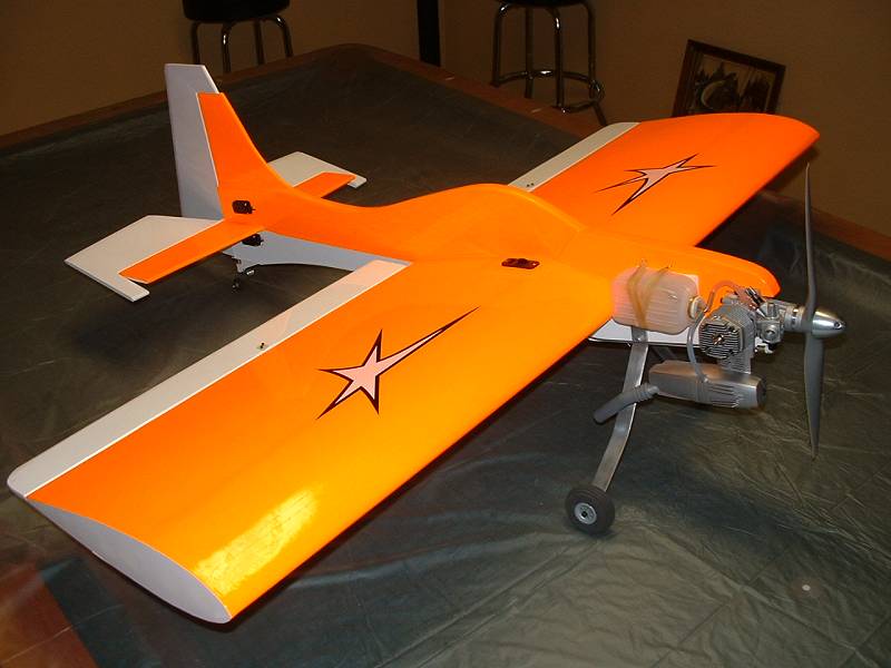

A size 40 would be fine. I put a evolution 46 on mine way over powered.

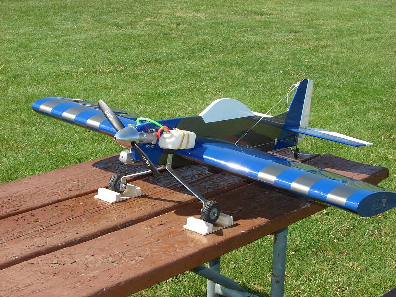

I put an OS 46 in the one I built for my son. It performs great.

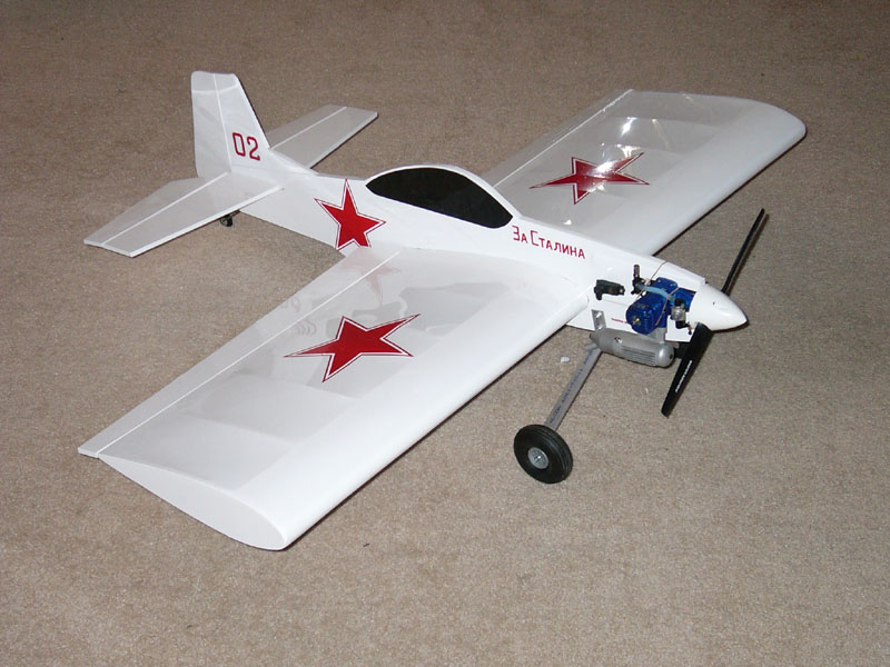

I had the LA40 on mine and it was more than enough power. Good times.

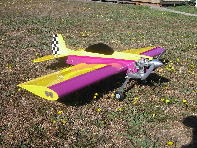

I have put an OS 55 AX on mine...

DITTO on the AX55-opps, this ain't a fun fly. Same thing though. 46AX with a 12.25x3.75 prop so nice-55AX with the same only better.
