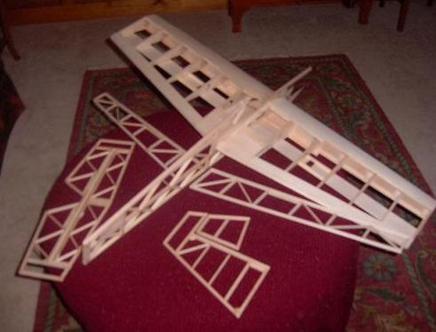

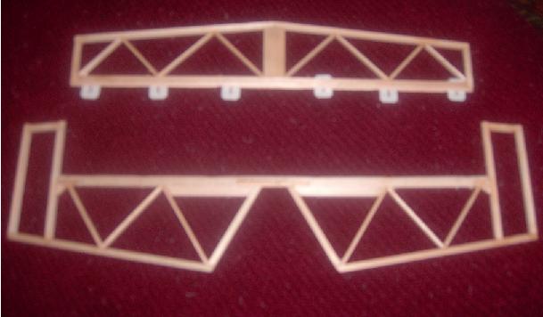

That picture is for anyone interested in the new elevator, or at least my version if it. Did I get it right Jeff?
As far as the rest of it goes, here it is. It's all done except for the fuselage. It would be completely done, but I am waiting for the rest of the kit to get here!

Brian, my redesign is slightly different but what you have should work. you might lay a triangle in where the hinge line square balsa and the counterbalance meet, just a strength suggestion probably will be fine as is. You can be my tester for that layout. Jeff

"you might lay a triangle in where the hinge line square balsa and the counterbalance meet"
I did, it's pretty small though... How much of a difference can I expect? Is this a touchy plane with the throws way up there?

How much of a difference would it make and would it be worth it to change the elevator after it has been built but not yet covered?

Smallfly did put a counterbalance on his and no difference. My counterbalances are 2 1/4" and do make a difference, and yes I think if you had it framed but not covered, do make the change. I really like the improved performance but I am picky on performance.
Brian, I guess I could not see that triangle piece in there. That is great it should hold the abuse. I have a sledge that I have been flying since last fall and I am going to cut the whole stab out and modify it too. That will be some work but like I said, I am performance driven. Jeff W.

Brian, I did not notice this at first but be sure to put a cross brace in that counterbalance area. I would go from top outside corner to opposite corner at the bottom. Jeff

I thought about that, but then decided against it. Not worth the tiny bit of weight it will add...The counterbalance is just as strong if not stronger than the rest and can't imagine it breaking. As you can see, I left that out of the rudder too.
I think a lot of sticks can also be left out of the fuselage. Actually, a 1/4 inch stick frame instead of 3/8 would be fine in my opinion. The fuselage is stronger than my other profile and it's not evenm sheeted yet! Holes in the wing ribs and cap strips on the bottom of the wing isntead of that 2.5 inch sheet is another thing I would change. Hopefully I don't kill this plane too quick, but when I do I will make those changes to my next one...
Besides that, it is a great design! It's definitely strong enough to take my abuse and still very light.

Well, that is the nice thing about a kit, if you do not like it you can change it. Try that on an arf! Have fun with it, mine gets abused and has held up very well. Jeff W.

BottleRocketWar - I say that if you leave out those cross braces that Jeff is recommending, then be sure let your buddies know that you did before each flight, because I sure as heck would want to make sure that I am near a good strong structure. <GRIN> Without those braces, the c'balances will flex too much and be practically useless, until they break off <LOL>.
BTW - Try that 1/4" fuse - been there - done that! Don't waste your time and money uless you are make a 15 size Fun-Fly.

My Tower Hobbies Extra Special was built with 1/4 inch balsa and sheeted. I just retired it after 400 flights and never had it fail, except when it fell back in the tail touch at full throttle... I assumed this Sledge would be built the same way, I had no idea how big this fuselage would be. It sure is strong though!!
I can't imagine these counterbalances flexing any more than the rest of the airplane... Seems very strong to me. I built them that way on other airplanes and never had a problem. They are not that big...If there is enough force to flex or break them, you can bet the rest of the airplane is going to fall apart too. I am not gently with my airplanes, but I do know how to use the throttle. We will just have to wait and see I guess...
