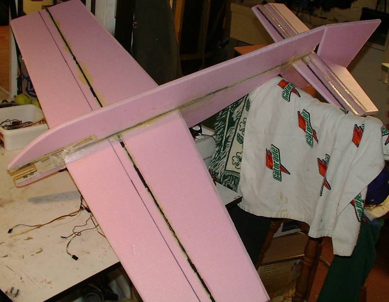

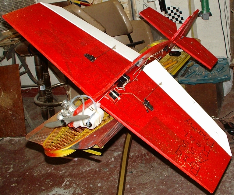

I have a couple.........
I used the Swany method for stiffness....CF Tube down the fuse.....and also in the wing.
It's also important to use Bi-directional tape, with #M-77 Spray glue, down both sides of the fuse, and for all the control surfaces. Don't use CA hinges...they won't hold in the foam!!
Put some Bi-Di along the bottom of the fuse, if you don't use landing gear.
The bird is ready to fly, with an AX 55 at 3lbs. 4oz!!!!
Enjoy
Enjoy

Too sweet. And I have to goto home depot tomorrow anyway...I guess I will have to build this to fly while I am finshing my CNC foam cutter...Are you using 1/4 OD CF tube?
I've got an OS .46FX that needs a home. At 3lbs, I'm almost sure that's in the hover realm....
Thanks for sharing your pics. I'll post some pics and CAD files when I get mine done.

Nice. Friggin Ugly Nitro Knocker. Whats the weight. I have an old os 46 (not an ax, fx or la) thats on a dazzler that I hate. That may be good engine for that plane. How indistructable is it? Anyway first I have to finish my extra, then cover my mojo, and then replace my airfoilz electric plane (a series of hover accident broke it in two twice

RCManiac119 reported 3lbs 4oz with an OS55AX. It uses a 5/8 Liteply plate to mount the engine, 2 1/2x36" CF tubes in the wings and fuse (a la mojo) to strengthen it, and a smaller CF tube (i think) in the horizontal stab. Apparently, that insulation foam is completely fuel proof. May have something to do with the paint he used, I'm not sure. I've seen horrendous crashes with perfectly fine carbon fiber pieces left over. If any part of the plane IS damaged, only about 10 of those 50 bucks is going to be damaged. The rest is in glue, a huge sheet of ply, and the CF rods. Also, foam is pretty easy to fix. One more point is that damage is done to a plane by a rapid loss in momentum (a crash). Less momentum=less crash. The plane weighs 3lbs. It's also not designed to fly fast AT ALL. momentum=weight*velocity (p=mv). Low weight times low speed = low momentum, less damage in a crash. PLUS, it's designed around the all-mighty Mojo. As I have no experience with the plane, though, I can only speculate.
