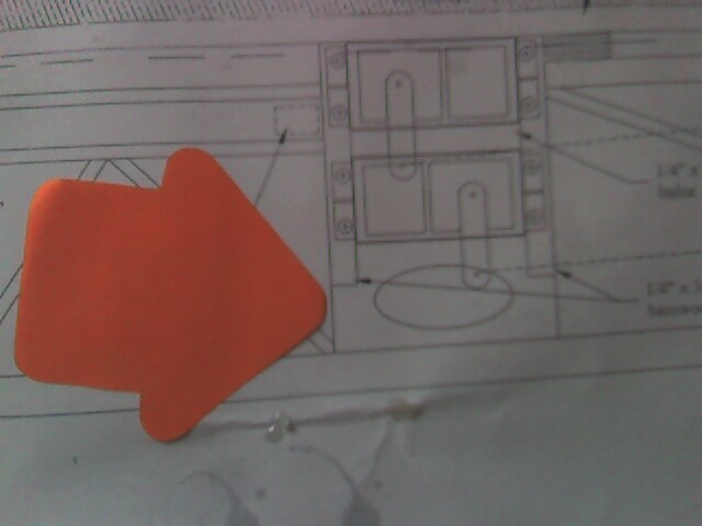

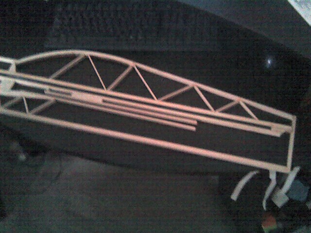

ok so here are some pic i been workin on this for 2 days on and off. i have a ?? to pics show what i am trying to say. on the rear servo tray th oval pice i cant find also the 2nd pic just in front of the rear stab i am i to use balsa block there then the stab sit angist that??

The piece in the kit doesn't have the oval cut.

ya i just happen to have that pice on my table and said o i think this is it. as i said b4 this is my fisrt kit i think a profile was a good way to start. i will have more pic's up soon

On your first picture that piece is a laser cut piece that goes in the tail under the servos. The oval is a cutout in that laser cut piece. The second picture shoes where you put in the balsa block in front of the stab. So I think you've already answered your questions. Keep it coming!

ya flexnbeef was right the oval wasnt cut in to that pice and thats whay i was lookin for. i am sheeting the the plane now i get pics up later
