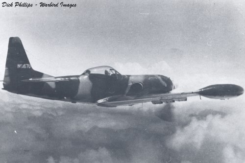

ORIGINAL: Red B.
FYI, the Mustang III was the British designation for the Merlin powered North American P-51B and P-51C.
I have been wrong before and when so, I am quick to stand corrected...
As for the reversal; it does happen. It is probably more prominent in some planes, while in others 'it ain't worth mentioning'...
...I am referring to the initial effect, with the tail still down, of course.
The cockpit canopy seems to closely resemble that of the Supermarine Spitfire... It is not the 'flat-top' canopy of the American P-51A/B/C...
