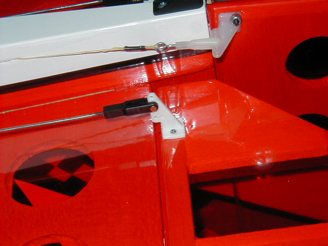

I am using the technique described by Don Incoll. I bought a Spool of Kevlar thread from Tower Hobbies. It is tied directly to the hole in the servo arm and secured with a drop of CA. On the other end it loops through a bent peice of 2-56 rod in a regular clevis. Seems to be very strong and light.

Kevlar works great... try using small eyelets on 2-56 nylon clevis at both ends. It makes it real easy to tie off and then plenty of adjustment. Very simple and easy to replace also. Just make sure to use tubing on the fuse exits. Kevlar will chafe especially if it is a fiberglas or c.f. fuse.
I bought a whole spool of Kevlar used for control line flying for 8 bucks, should last for many airplanes.

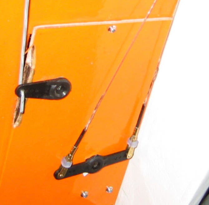

I don't think it would work with Kevlar, there is no coating there to melt. I have been using 60 lb test fishing leader for years. Can't beat the 3 cents a foot

Any fishing, camping, hunting store should have something similar. Mine came from Gander Mountain. The brand is Mason, see below...works great. Trying to undo nylon melted to nylon in the "shear" is pretty dependable.

Tie off the Kevlar line with a double knott then a drop of thin c/a on the knott and it will not come loose.
Kevlar has very little if any stretch in it.

I've used the Dubro Pull-Pull systems for years until recently. I now just buy the plastic coated wire braided leader from a fishing store (Bass Pro Shops) with their crimps. I then just buy the threaded couplers & clevises from the LHS. I thread the fishing leader through the crimp the same way as it is illustrated on the back of the Dubro package and haven't had any trouble in years.

You don't need the brass tube at all. I just use a short (1/2in.) piece of heat shrink tubing. I run it through the heat shrink a couple times, heat it a little, than a drop of CA. Works for me.
