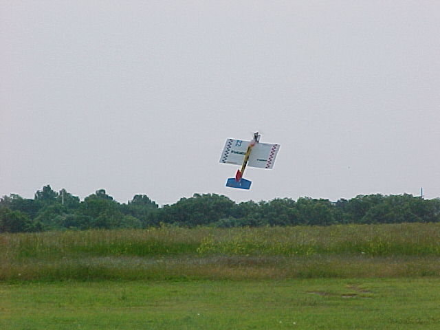

I did up a one page drawing for the SPA3D and some text instructions, if anyone is interested. Let me know if there is enough info here to build the plane from.
One page plans
http://members.cox.net/spad/pics/spa3d02.jpg
Building instructions (Text)
http://members.cox.net/spad/pics/spa...tructions.html
Reference Photos
http://members.cox.net/spad/pics/spa3d01.jpg
http://members.cox.net/spad/pics/spa3d03.jpg
http://members.cox.net/spad/pics/spa3d04.jpg
http://members.cox.net/spad/pics/spa3d05.jpg
http://members.cox.net/spad/pics/spa3d06.jpg
http://members.cox.net/spad/pics/spa3d07.jpg

I think you could build one from the drawings alone..........great job! Dan

is this better than the PQHOR?
I'm looking to build sommit a bit knock about coz i can hang good, fly great, but I'm $h*% at just sport freestyle, i fly my planes like i wanna take them home ( which of course i do ) but the skills at flying inverted low, low KE and just being stupid arnt there. need sommit to get over that fear factor and improve the natural reflexes

Wow Tattoo..you really have the bug!
That's what happens when you have a lot of retired combat equipment laying around
I think it is, but then I'm just one person...so I guess in all honesty the jury will have to be out until some more flight reports come in. Kraut built one just like mine, and he hopes to fly it soon. He's a much better 3D pilot (ouch it hurts to admit that) than me so his report should be interesting. Just from the ones I flown, the Spa3d is more stable in straight up hover (no falling backwards at all)--it's about the same in upright harriers--it's better in inverted harriers--upright flatspins are sightly better--inverted flatspins are way better--positive G pitch response is about the same--negitive pitch response blows the PQHOR away with awesome low throttle waterfalls. I also think full throttle straight and level is more stable, with no tucking whatsoever. The build is also easier, especially cutting out the profile fuselage in the front, and I really really really like the fuel tank mount for hassle free simplicity, and the tank being closer to the airplane's CG. I also like the tail wheel installation...I moved the vertical forward so that the tail wheel wire goes through the aluminum fuselage, and that adds a lot of support with less chance of ripping out the rudder hinge with tail wheel abuse
Thank you! That means a lot to me...I've learned a lot on the forums about trying to present a design. Certianly no professional, but I'm getting better at it!
