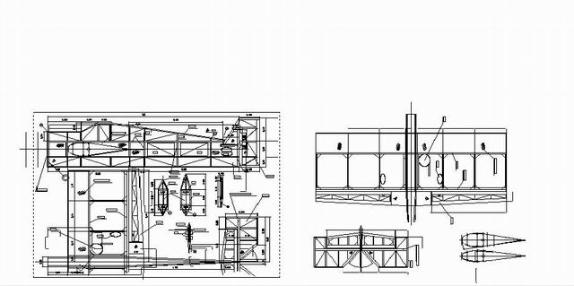

Might as well post the plans for everyone so that Kamlooper doesnt get flooded with emails.
Fun 15 DXF File
Have at it
Old 03-24-2002 | 10:25 PM
Posts: 29
From: Sucat Paranaque Philippines
Default fun 15
Thanks MIL,
I tried opening the file using TurboCad and I've attached what I got. Is this correct? Looks like there are some missing parts. What CAD program did you use to open this file?
Thanks.
Old 03-24-2002 | 10:51 PM
MiL
Posts: 281
From: Bend, OR
Default fun 15
Thats what i got too, i used Autocad 2000.

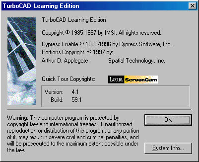

Old 03-27-2002 | 11:11 PM
Posts: 289
Received 6 Likes on 5 Posts
From: Kamloops BC Canada
Default turbocad learning
turbocad learning
Old 03-28-2002 | 02:05 AM
Posts: 29
Default fun 15
kamlooper,
There's our problem. You're using an older version of turbocad. It seems that IMSI doesn't offer v6.5 for download anymore. Let me know if you can receive a 7.5mb attachment via email and I'll send you a copy of ver 6.5.
Just in case you want to stick with ver 4, I'm attaching a copy of the ribs which I edited with ver 4.
Hope this helps.
