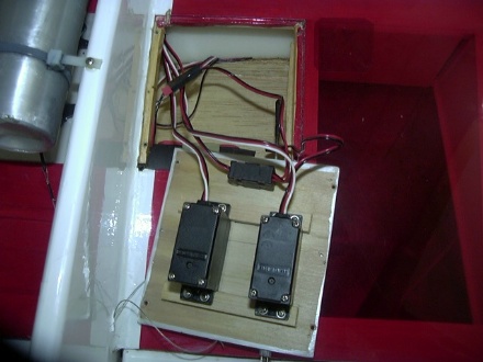

Joined: Dec 2002
Posts: 598
From: st. augustine, FL
AERO330LX,
profile servo installs are really easy. i throw away the mounting instructions and mount servos to hatch using small hardwood rails of the correct thickness for the out put arm to stick tru to the correct height (usually top of case has to be flush too under side of hatch ,or just slightly recessed). then when you remove hatch servos come with it leaving everything accessible.hatches are 1/16 ply rails are far enough out so screws holding hatch in place don't split it. then harden screw holes with thin c.a. have done this on my knife (75 flights) and my taco...if you would like i think i have some pics i will dig them up.

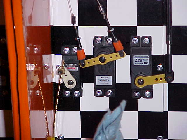

My Feedback: (16)
Posts: 2,666
From: Houston,
TX
My Feedback: (-1)
Posts: 450
From: None
Texas3D,
Very nice work. I can tell, you pay alot of attention to the little details. It makes them nice too. Things like the orange fuel line that matches the color scheme, hardware modifying, good rods, and good geometry on the linkages, hex head servo screws, etc... . The covering job is really nice too. I think it really makes them fly better when you're real careful on the setup like that, and it looks good too!

Joined: Dec 2002
Posts: 598
and the final one of the hatch off on Knife. to me this is easy no problem install...i also likem the pull pull system better than rods
hope this helps

cool install Hacker.

My Feedback: (16)
Posts: 2,666
From: Houston,
TX
Originally posted by Aero330LX
Texas3D,
Texas3D,
LOL
