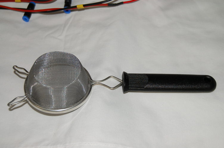

Keith, Sorry for taking a few days to reply. I just got back from a short trip down to Seattle where I finally saw the SR-71 for the 1st time at the Museum of Flight!
Go to your nearest dollar store and pick up a strainer that roughly matches (slightly smaller) the intake fairing on your motor. Remove the handle(s), cut a hole in it and insert a rubber stopper or equivalent, and you've got yourself a FOD screen on the cheap! It'll run you somewhere around $3... Either that or I can recommend a few sources that are pre-made but more expensive...
The glow pug life span differs greatly. I don't have any numbers here, but they can last a very long time if you treat them right. I have not changed the plugs in any of my engines for quite some time... Many factors can effect plug's lifetime: filament diameter, plug voltage, number of starts, average length of glow voltage applied per start cycle, how good you are at pulling out the fillamement with evenly stressed coils, etc...
To achieve best results anneal the plug before pulling out the coils. Do this with a glow ignition and pulse it to make the coil come back to room temp slowly. Next get a pin or pointy exactro knife blade and deflect the first rotation of the helix out. Follow that with next rotation and the 3rd if necessary, such that they are close to evenly stretched when the total exposure matches up with the 2mm spec in the manual (on page 10). The motor comes with an OS A3, but any plug without an idle bar should work... Personally, I try to run a plug voltage that's as low as possible. I started around 2.1V and went as low as 1.7, while still getting reliable ignition.
Kelly

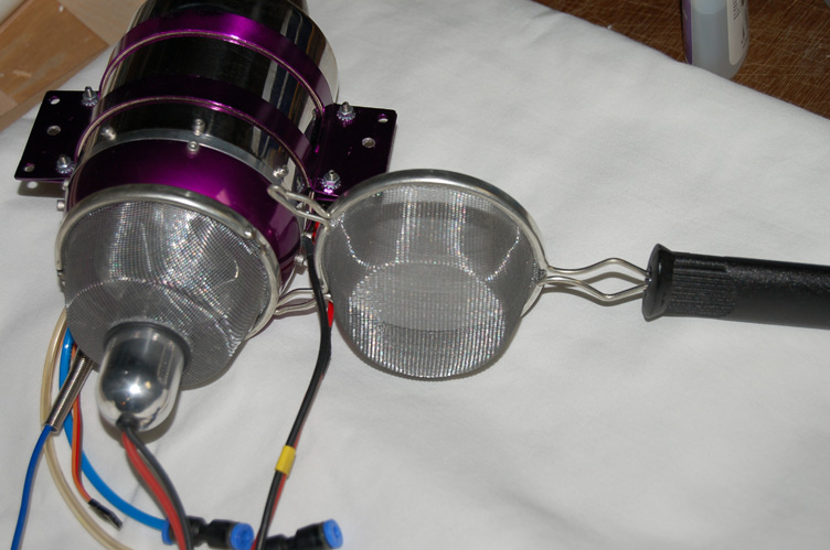

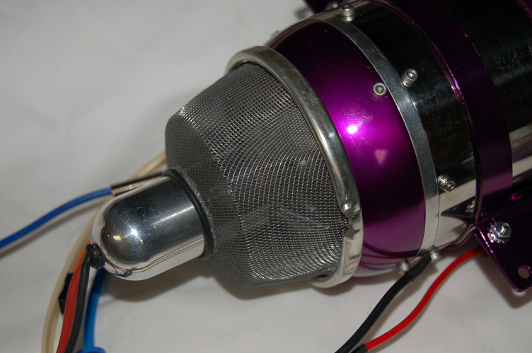

Here is the system I use for my PST's. It is a 3" tea strainer that can be purchased at any store that sells dinnerware. Just cut off the handle and the two ears oppisite the handle and you have a ready made FOD screen. Carefully cut the hole in the middle to fit the starter and seal the screen with thick CA or grommet. Slide it over the starter and hold in place with an O-ring on the starter hub.
Roy

Kelly and Roy,
Well...you can't get much cheaper than that! How simple! I'll get a screen today and modify it. Thanks for the tip and pictures.
I'm glad to hear that plugs can lasts a long time. I was under the impression that plugs had a short life span. Just one of those nagging things that bug you until you find out different. I have seventeen flights to date and the engine is running great. I changed the fuel system as you suggested and everything seems fine.
Keith

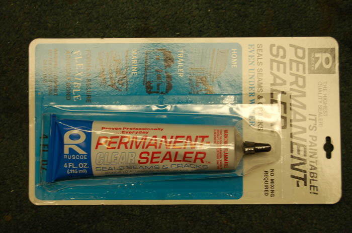

A few addition comments I forgot to mention... You should try to find a strainer that as coarse as possible, in the interest of minimising the pressure drop across the screen. Other than that, you need to have a good look at the screen after cutting to make sure there aren't any loose screen fibers. Once its been checked, Roy's idea to seal it with an adhesive is also a good follow up. I'd recommend trying the black rubbery CA glue or a silicone of some kind. Thick CA has a habit of becoming brittle in some cases, which could negate the point of the FOD screen some time down the road.
Good luck!
Good luck!

Excellent point about the thick CA. I have found a sealer that does not get brittle and stays flexible and withstands fuels. It works to hold the cut metal pieces of the strainer in place but remains flexable.
Roy

From the pictures, the tea strainer is too fine [X(]. You will need a coarser one. My estimate is that you are reducing the compressor frontal area by more than 40% with that very fine tea strainer. We use "sink drain" filter instead of tea strainer. You should be able to find coarser screen in the kitchen and plumbing section. Sorry, but such restricting screen will limit your J600R's performance and may cause compressor stall.
Regards,

I have 40 flights on my 600R now and am completely satisfied with its performance. The early glitches are a distant memory. Unfortunately, I'm leaving for my next duty assignment and will be gone for nine months. What is the correct procedure to place a turbine into storage? I'm familiar with 2C and 4C engines but wondered if the turbine has special requirements I may not be familiar with.

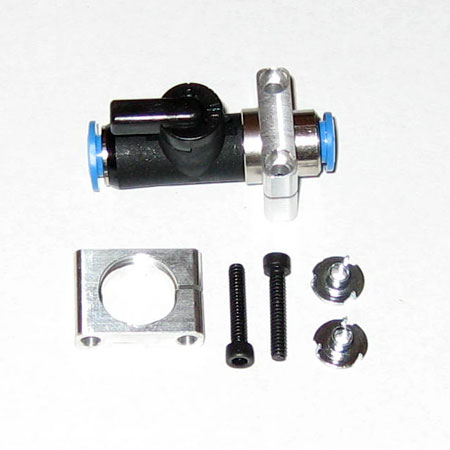

Is there a 4mm ball valve available with a mount flange? The ball valve provided with the turbine does not have a mount flange....on my new model a flange would make mounting a bit easier. Cost?

Festo's manufacturer of ball valves does not make a variant of the valve with bolt down features (although it sure would be nice if they did...). They do make a bulkhead union style valve, but that's not really a good solution for most, so the mountain clip solution that was suggested earlier would likely be your best bet.

Todd has a small device that works like a collar that fits around the valve. It is a two piece aluminum unit that has some mounting attachment that allows you put the Festo valve in it and then attach it to the aircraft. I picked up some from him and wondered why I had never thought of it myself.

Doc Yates; thanks for the tip on the mount for a ball valve. Wow, very simple! Why didn't I think of that!
