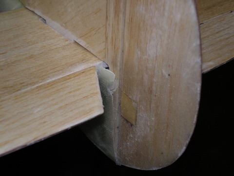

Sahartman, could you post some pictures of the napier, I would especially like to see a picture of the rear stab area. I've been thinking about getting one for a long time.

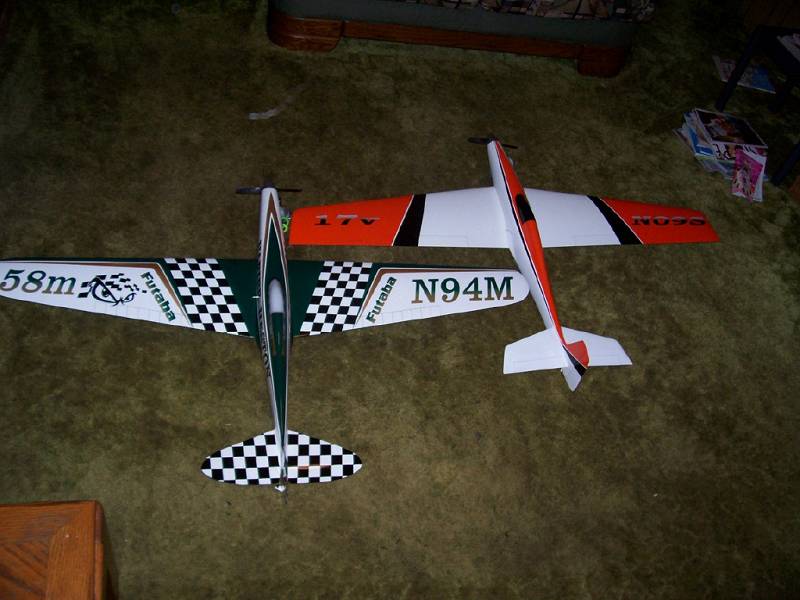

Here is my Napier

Both are from Lyle Larson (California Speed Pros)

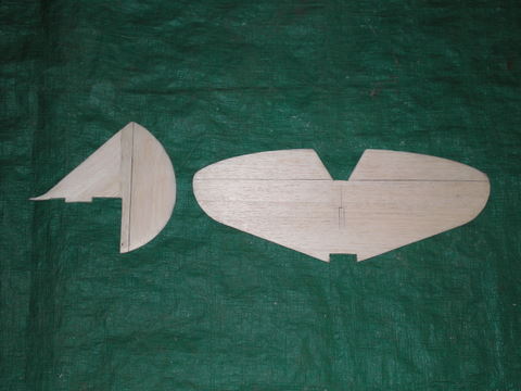

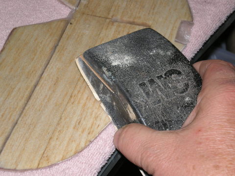

Let me see if this works. Some tail pictures are attached. Mine is still being built.

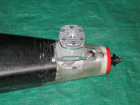

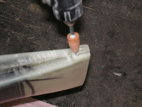

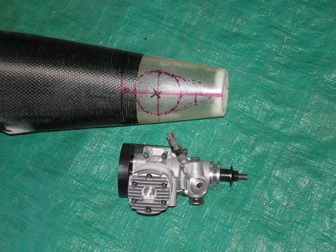

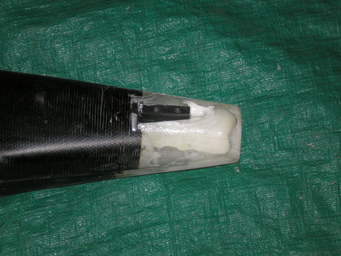

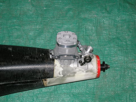

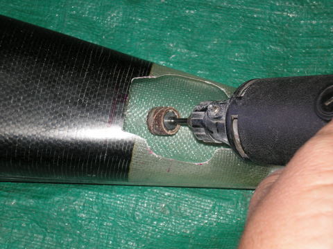

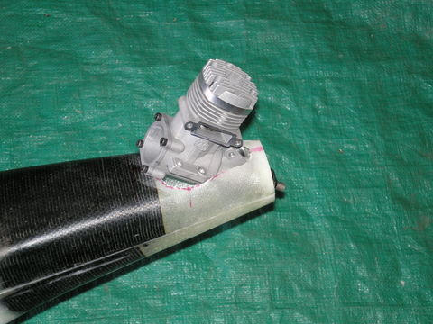

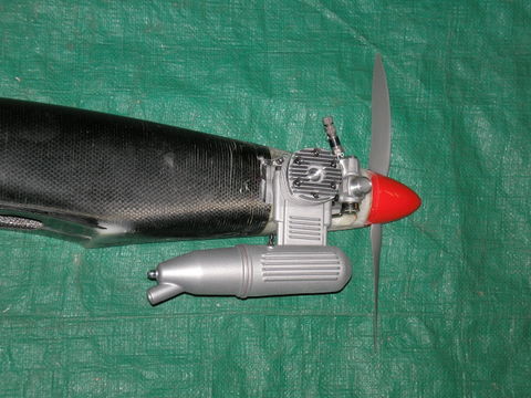

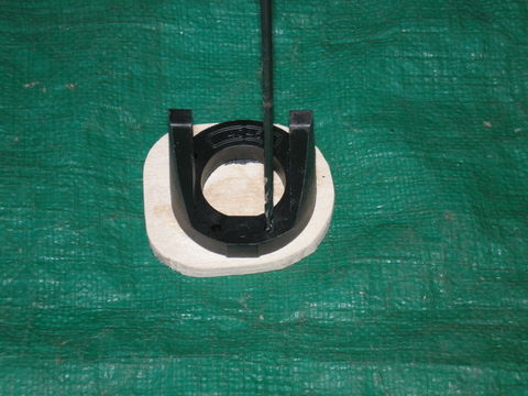

I started the Napier with the idea of going fast without spending a lot of money. In some of the forums a sport version of Q-40 with Thunder Tiger Pro 40s was discussed. Below is how to install one in a Matney Models "Napier".

I am near Amarillo, Texas and it looks like there are a lot of racers in Missouri and the surrounding area. The Amarillo area flies the Club 40 racers.
It appears that there might be enough airplanes around to fly Q-40 Sport Class with a Thunder Tiger Pro 40. I am about 7 hours from Wichita, Kansas. Around 8 hours from Joplin, MO or Kansas City.
Kevin Matney from Matney Models indicated that he has Jett motor mounts drilled and tapped for the Thunder Tiger (TT) motor. A lot of the current Q-40 models are equipped with a Jett motor mount. You might be able to change out your existing mount and install one for the TT.
