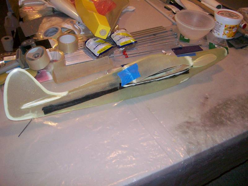

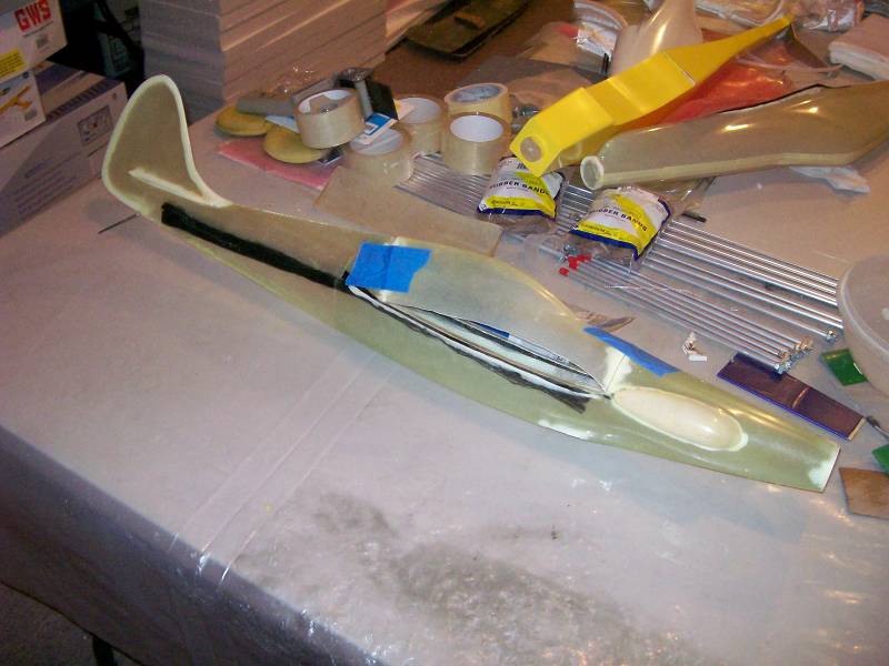

This is the Stinger from the video.
It had some defects on the seam and in the corners that had to be fixed. I used the re-molding technique where I put filler into the voids and put the fuselage back into the molds. I had to do this several times before I felt it was good enough to ship.

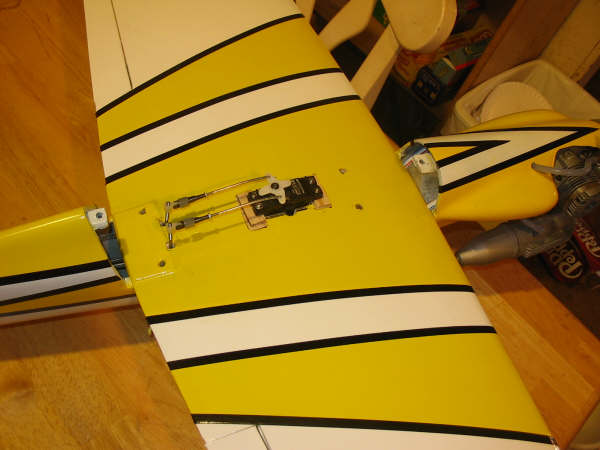

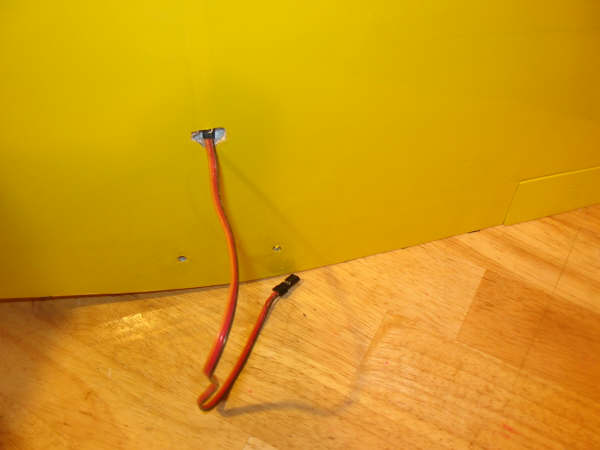

Here are some pictures of a Stinger wing, hatch, and radio installation.
Thanks to Left_Turn for the photos.
This is a nice installation with the hatch bolting down after the wing is bolted down. Easy access to the wing servo and no open holes for wing bolts.
