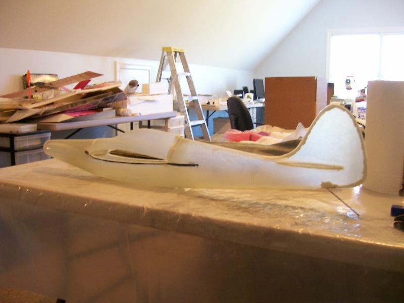

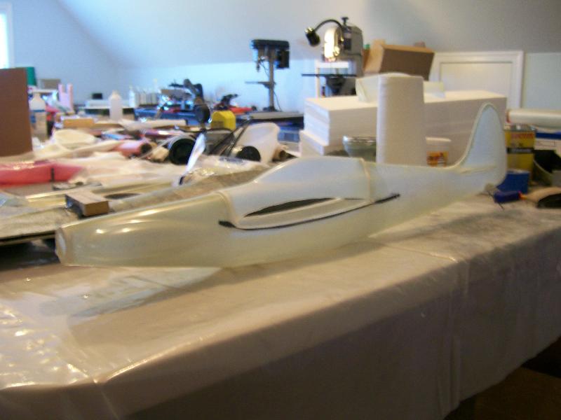

Last week I got inspired to work on the Stinger molds. I have completely renovated my shop. It is now painted and carpeted. During the move, one of the wing templates was lost. But last week I made a new set of templates and got the FeatherCut working again. I got a couple of sets of cores cut.

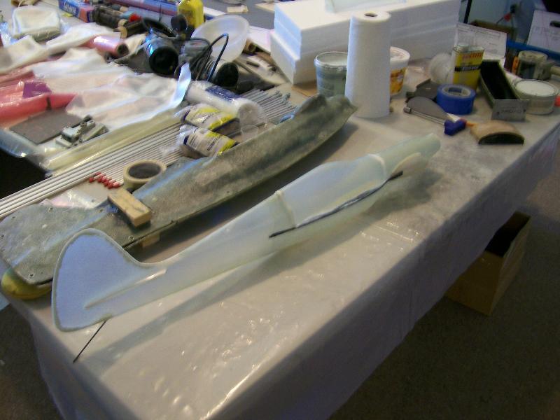

The first part of last week was spent sanding the molds. I used wet or dry 3M Imperial paper in 400, 500, 600, 800, 1000, 1200, and 1500. All sanding was done wet. It’s still a mess sanding black epoxy. I then used 3M Marine Super Duty Compound and rubbed the molds out. I finished off with 3M Marine Finesse-It. This was the first time using the Finesse-It and I believe the last. Pulling the parts was pretty hard and I believe the Finesse-it blocked the wax from getting into the epoxy surface. Almost another disaster. The first hatch I made had to be coerced out with popsicle sticks. The second one did much better.

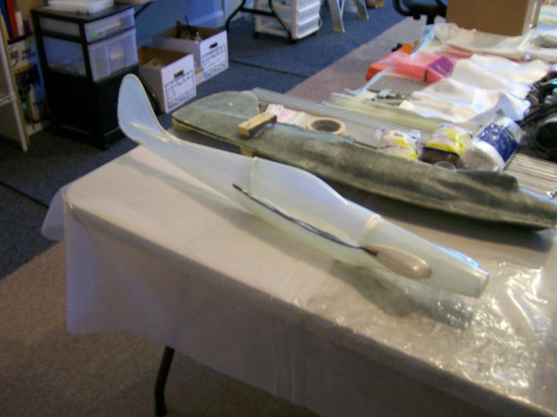

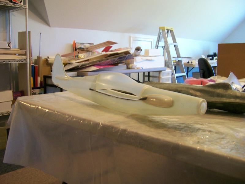

Yesterday I laid up a fuselage. I had thought about making a sacrificial part just to see if the molds would release. But I had taken extra precautions, so I went for it. It was a long lay-up. 3 hours from start to putting it in the hot box. It was fully joined in the mold. I had pinched the seam behind the hatch and had to mess with that a little causing one void, but it is fillable.
Getting the fuselage out was a bear. I had not primed the molds, so it was easy to see where it was not releasing. I used a rubber mallet to help the stuck spots. If I had primed it, I would not have know where to hit it. Hopefully it will be easier to pull parts in the future. I think the Finesse-It caused the difficulty.

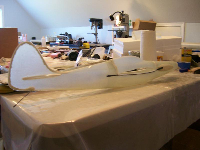

Looks like a great job on the first part, Don!
I have never used the Finesse-It, I am guessing it is a final polishing compound? I have been using just plain old turtle wax rubbing compound followed by polishing compound to finish my molds, and it seems to work great for me, so far. I do wax and buff the molds with Partall#2 or Meguiar's 88 once a day for a week for the first pull, or just a couple of times after a few parts.
I found a new (to me, anyways...) polishing compound I am going to try called Meguiar's PlastX. It is for polishing out scratches and swirl marks on plastic headlight lens covers, so I am thinking it my be able to polish just a little past the regular polishing compounds from Turtle wax. I can let you know how it goes, if you are interested.
I see you use West System additives, are you using their resins also? I used to use the 105 - 206 for sheeting wings, but went to MGS for the longer working times. Are you using the 209 hardner for longer working times? Just curious how it is, if that is what you are using.
Again, sweet looking fuselage!!
I have never used the Finesse-It, I am guessing it is a final polishing compound? I have been using just plain old turtle wax rubbing compound followed by polishing compound to finish my molds, and it seems to work great for me, so far. I do wax and buff the molds with Partall#2 or Meguiar's 88 once a day for a week for the first pull, or just a couple of times after a few parts.I found a new (to me, anyways...) polishing compound I am going to try called Meguiar's PlastX. It is for polishing out scratches and swirl marks on plastic headlight lens covers, so I am thinking it my be able to polish just a little past the regular polishing compounds from Turtle wax. I can let you know how it goes, if you are interested.

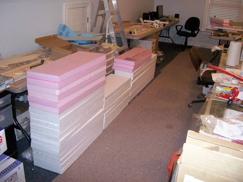

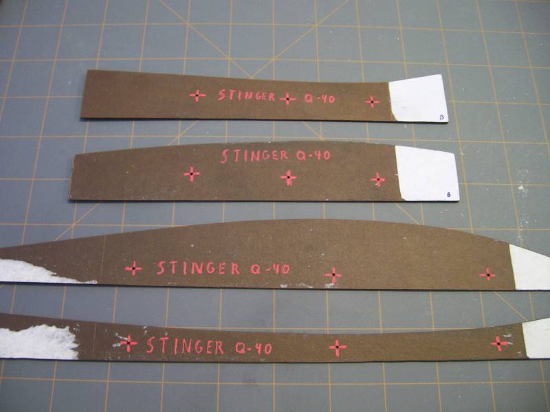

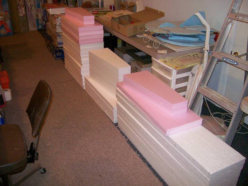

This weekend while I was cutting Stinger cores, it occurred to me that even though the Feather Cut has been around a long time, a number of people have not seen one used. While it is no match for CNC equipment, it is much less expensive and is quite convenient for do-it-yourself types or for planes where the templates were made for hand cutting cores. It takes a job that normally two people would have to do, and makes it manageable for a single person. But I do look forward to the day when I have my own CNC system.
For Q-40 cores, I cut a 4’ x 8’ sheet of foam into twelve 32” x 12” rough cut blanks. Then I use a jig to cut the blanks to a precise size. Since some of my cores are longer than 24”, I’m not really wasting much foam this way, and the edges are nice and square. I use a 52” bow for cutting the blanks to size. For Quickie wings I cut the blanks to 48” x 10.5” and I just deal with the edges at the tips not always being perfect. Usually taking 1/4” off each end or more on one end and less on the other to keep the 47.5” does the trick.
I made a video of cutting a blank to size on the jig and then cutting the core. I posted it on YouTube so interested people could see the Feather Cut in action. The first part of the video where I cut the blank to size is not lighted well. But I did not feel like redoing it. I pulled out my halogen lights for the Feather Cut part and it is lighted much better.
See [link]http://www.youtube.com/watch?v=YtbYKgalYXk[/link] for the video. NOTE: You will enjoy the video more if you click on watch in high quality in the lower right corner of the video screen.
It also occurred to me that building a wing and stab are the hard parts of putting a Stinger together. So I came up with an idea. I’m going to offer a “Stinger Starter Kit” that includes 2 sets of foam cores and a full size set of plans for $30 shipped in the US. That way, you can build a wing or two and when or if you are ready, you can get the fuselage and put a plane together. The cost of the starter kit will be applied to the cost of the first kit if you build the wing and decide to finish the plane. So you and a buddy can build wings, or you can mess up a set of cores learning and still have a good wing. Or maybe you even get two good wings out of it.

Believe it or not, I do a 3-4 hour lay-up using 105/206 (20 minute pot life). I typically mix 8-10 batches of epoxy per fuselage. One for the filler per side, then one plain for the 1.4 ounce and the 6 ounce layer. This is sometimes just barely enough for a full wet out and I have to mix another ounce. Then I do the other side. I then mix an ounce and put the doublers in. Then comes the big tedious trim. I do the parts that are flush with curved toenail trimming scissors. Then I mix two one ounce batches. One gets filler and goes in a syringe. The other is used to wet the overlapping tabs and recipient sides. Then I join the halves. I have to really hustle and there is no time for interruptions. But I put it in the hot box and 12 hours later I can pull it out. I do like using 105/209 for the much more relaxed time (50 minute pot life), but then I have to cook it for 36 to 48 hours before I feel comfortable pulling it out of the molds. In the winter I keep the shop at 65 degrees. That buys me more pot life and a lot more thin film time. 105/206 is a real challenge in the Summer unless I really crank the A/C down. Sometimes I run out of time and don't get my syringes cleaned out while the filler is not too hard for acetone to break it down. Then I have to clean them after it has hardened which is about a minute a piece job.
I would like to go to another epoxy system, but WEST works every time as long as you match the resin pump count to the hardener pump count. When I can get a dispenser or two I will try a new system.
Another thing is that WEST is available in Charlotte as well as most reasonable sized cities at boat shops. They will have 105 resin and 205 and 206 hardener on the shelves. Unfortunately they usually don't have 207 or 209.
I like the flexibility. I just got through glassing one side of a Quickie fuselage and one side of the tail surfaces with 105/207. It is in the hot box and I could probably add another side by bedtime. 207 sands really nicely. I haven't found much use for 205. It's to short of a pot life (12 minutes) to do much and then it takes 4 hours until you can handle it.
Of course 207 and 209 are expensive at $50+ for the matching size for a gallon of resin.
I make my surface coating resin for molds from 105/209 and let it cure outside of the hotbox. That way I don't get any bubbles. Then as I lay up layers on the mold after a few layers I start putting it in the hot box. So by the time the mold is finished, the 105/209 is Shore D hardness and the mold is ready.

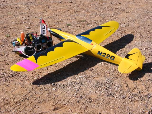

I didn't mean to take over your thread Don, I figured a couple of other pictures of the "Stinker" from different views might be helpful.
The plane flies very well with a TT40 and a 9X6 prop. With the slicker air-frame than a quickie,,,it would probably do better with a 8.5 X 7 without loading the engine too much. It actually has very good slow speed characteristics also and lands smoothly.

I had a Kangke F3D/30 (which was grandfathered into Q-40 Sport) with a TT Pro 40 and the best props on it were the 7.4 x 8 and 7.4 x 8.25 ... In terms of sport props, the APC 8x8 was actually pretty good but required smooth turns.
If you ever try the 7.4 props, make sure you change the rear bearing first as they will turn in the 18K+ range on the ground.
