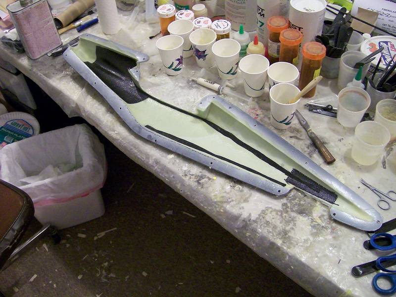

Here are a couple of photos of a Swee' Pea lay-up that show the carbon fiber. The nose was already very stiff on the Swee' Pea, but with the carbon fiber, it is VERY stiff.

Old 05-25-2009 | 02:11 PM
  #28
DonStegall's Avatar
Joined: Aug 2005
Posts: 1,840
From: MonroeNorth Carolina
Default RE: The Swee' Pea is next
Here is that fuselage. You can see the carbon fiber through the primer somewhat.
