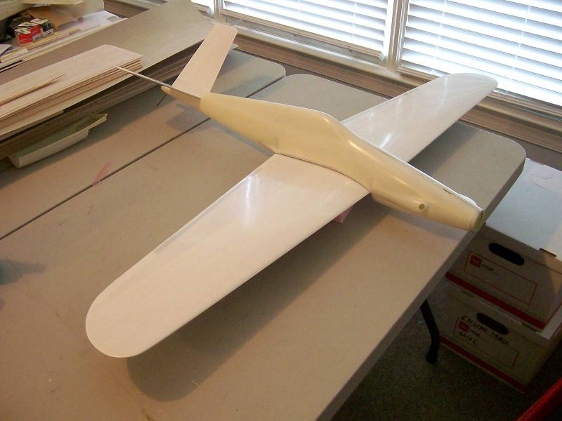

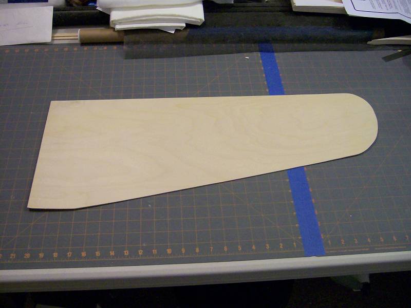

Next on my lay-up list is the Swee' Pea.
I have one on hand that was primed in the mold. But it does not have carbon fiber in the nose or tail and I have someone wanting one with the CF.
I have molds for the tail and wing, but I'm going to make templates for foam cores. The original wing was only 52", but I'm going to stretch it out to 56".
The original plans also have a ventral fin option that mimics one version of the real Swee' Pea.

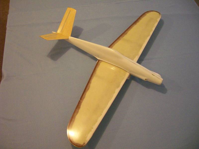

I've had some interest in the Swee' Pea lately. I snapped off a pic last night and one this morning with my mock up wing. I am getting back into full production of the composite Swee' Pea kit. As well as a fiberglass and foam version. The fiberglass and foam kit is $125 plus S&H. I will post the composite kit price soon.

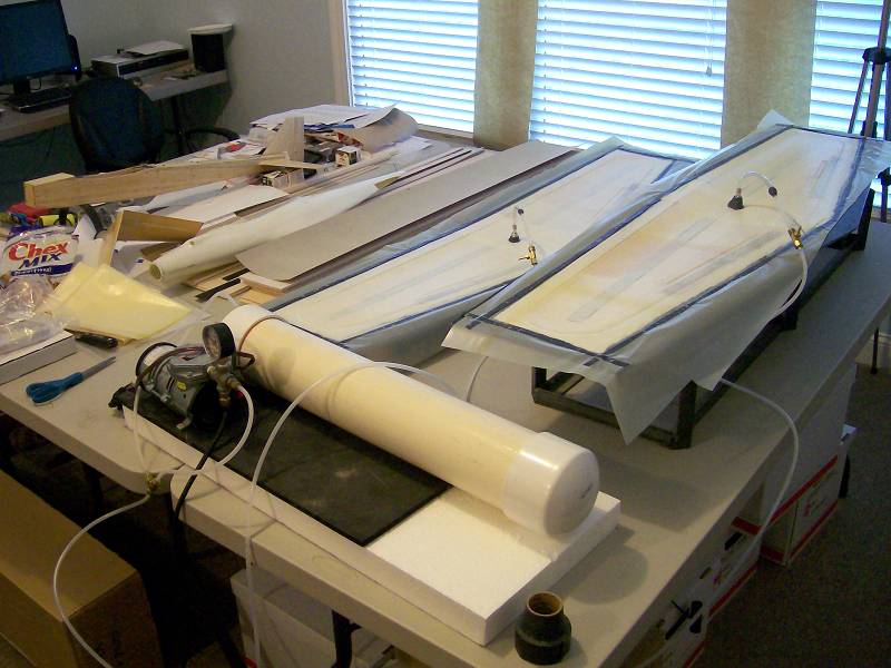

Old 04-18-2009 | 05:38 PM
DonStegall's Avatar
Joined: Aug 2005
Posts: 1,840
From: MonroeNorth Carolina
Default RE: The Swee' Pea is next

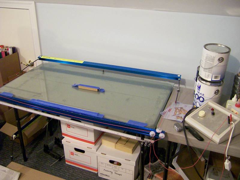

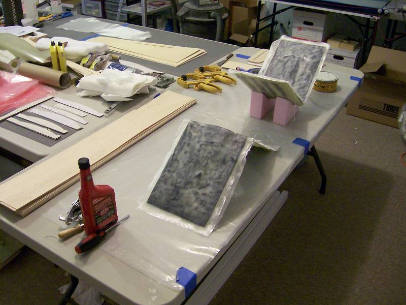

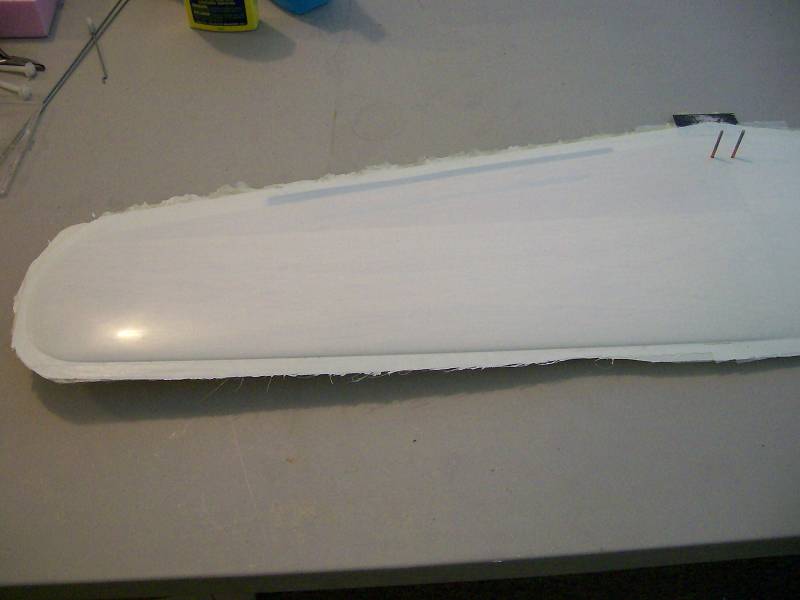

I'm making a couple of molded composite Swee' Pea airframes.
I laid up another wing today. Here are some pictures I snapped as I was doing it. I might try to notate the pictures later.

Old 04-18-2009 | 10:05 PM
PylonDave's Avatar
Joined: May 2006
Posts: 469
From: rancho cucamonga, CA
Wow Don, it looks like you are setup for production!!!
Old 04-19-2009 | 06:51 AM
DonStegall's Avatar
Joined: Aug 2005
Posts: 1,840

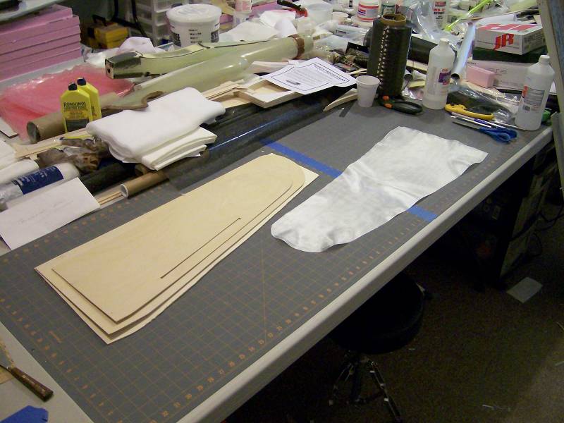

Dave,
I'm lucky to have a big work area. I designed my house and I designed a 37'x20' room with a 10' ceiling in it upstairs. And I negotiated with the contractor for my Dad to be able to work onsite and he added a 23'x13'x8' room as well. I'll shoot some pictures. It takes a lot of room to do composite wings without having to shuffle stuff around. That's one of the reasons why I recommend that people start out with small pieces like V-tails before they graduate to wings.

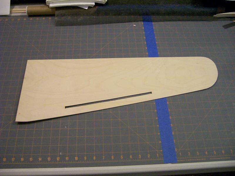

Templates are essential to making composite parts and enjoying the process. Just like building a regular plane, you need plans. I make templates for every part that is repeatable. Here are the templates for:
1) the wing skins
2) the wing cloth
3) the wing peel-ply and breather

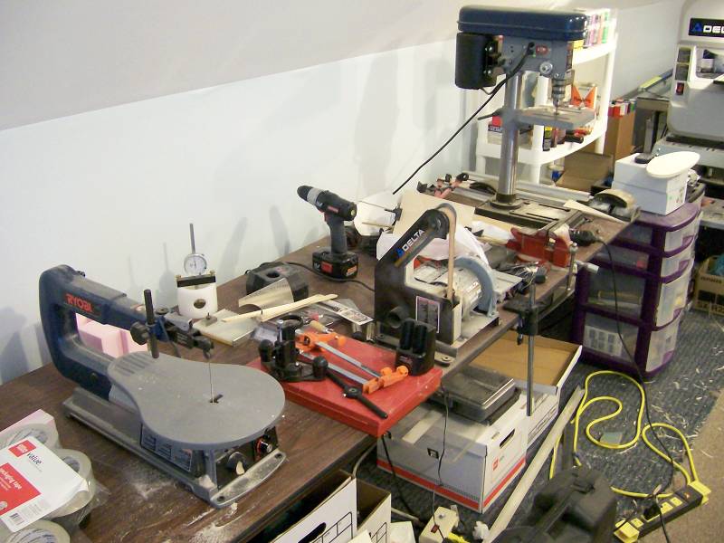

Old 04-19-2009 | 06:59 AM
DonStegall's Avatar
Joined: Aug 2005
Posts: 1,840

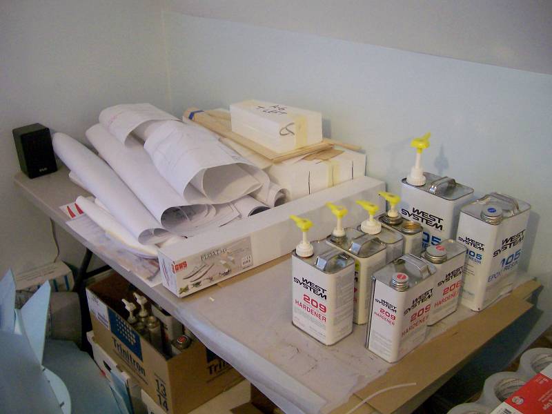

And I do have a lot of space. I have a number of 6'x2.5' tables and some other tables.
BTW, I have a new name for the business. It is [link=http://HouseOfPylon.com]HouseOfPylon.com[/link] and it now takes you to www.StegallHobbies.com ... I have not started changing the web site yet. What do you think of the new name?. I think it is more representative of what I do.
These are pictures of the perimeter of the shop.

Old 04-19-2009 | 07:04 AM
DonStegall's Avatar
Joined: Aug 2005
Posts: 1,840

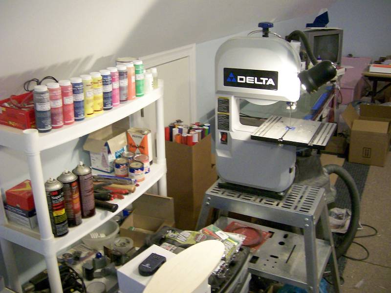

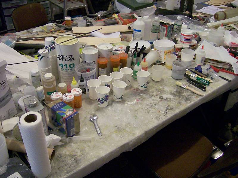

Here are pictures of the interior of the main shop.
Note that you don't see a lot of planes and parts sitting around. Most everything lives in the other room on shelves. The other room has the table for vacuum bagging wings and tables for vacuum bagging tails and smallers parts.

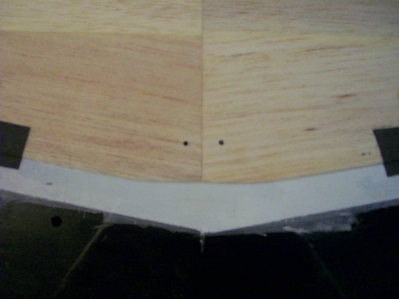

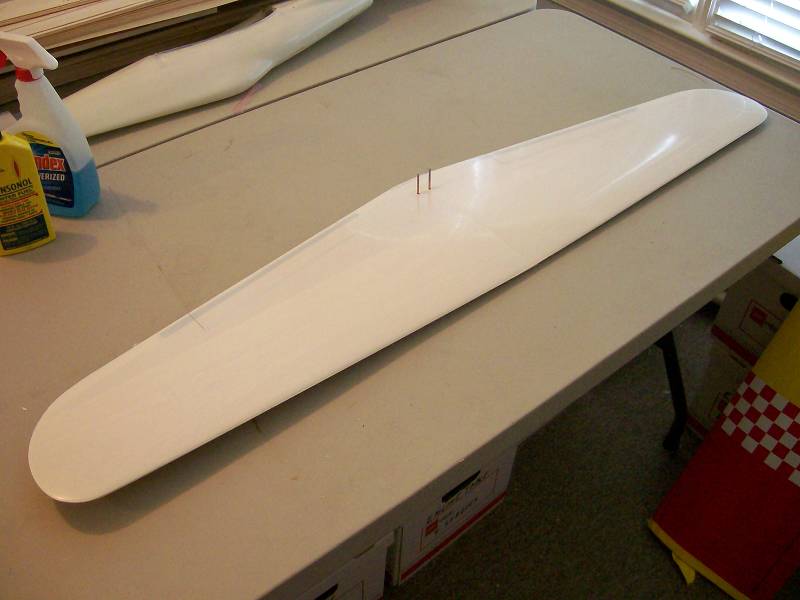

The skins came out fine. I let them stay under vacuum for over 36 hours. I was too tired last night to do a tail anyway.
Here are a couple of pics

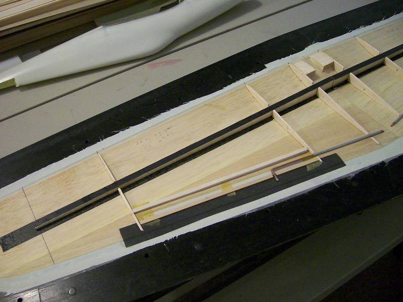

Old 05-11-2009 | 06:40 AM
DonStegall's Avatar
Joined: Aug 2005
Posts: 1,840

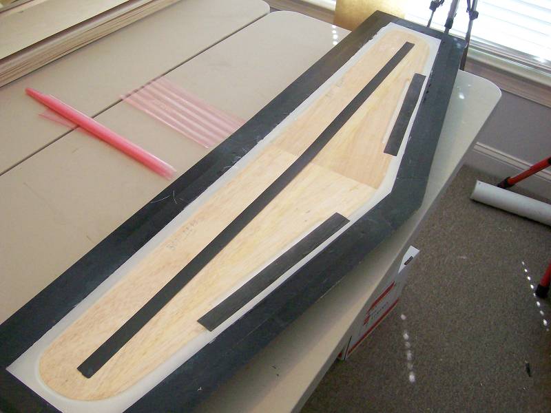

I used to make the Swee' Pea wings from 3/32" balsa. I used 1.4 ounce cloth on the outside and 0.7 ounce on the inside. The problem was that the trailing edge is hard to do with the thick skins and the complex curves of the tips don't always lay down unless you use soft contest balsa. So I decided to switch to 1/16" skins. I'm using 1.4 ounce cloth inside and outside.
This change requires a whole new set of templates for the internal structure. The internal structure consists of the spar, ribs, blocks for the front wing hold down bolts, and pieces in front and behind the hinge line.
I've got to cut some cores and sheet a couple of wings today, but making the structure and closing this wing is my priority for the next two days. Since I don't have any CAD drawings of the wing, I have to use mechanical methods to make the templates for the structure. As I will be creating documentation, it only takes a little extra time to post here, so I'm going to post pictures and words. That way you and my customer can see how I do the work.

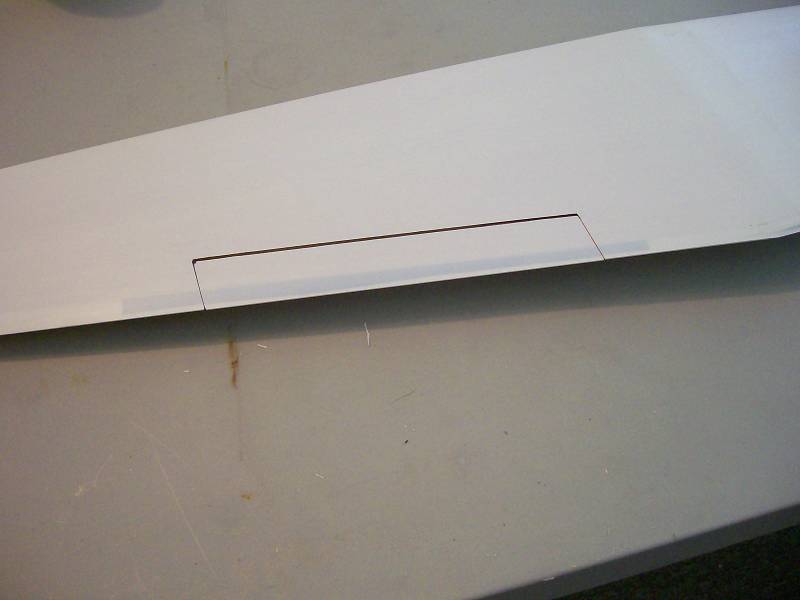

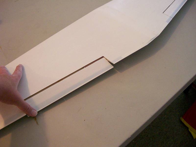

Because of the frame on the top mold, I can't drill the torque rod holes from the bottom side. So I made a jig to drill them from the top. It is indexed on the nearest two clamping holes.

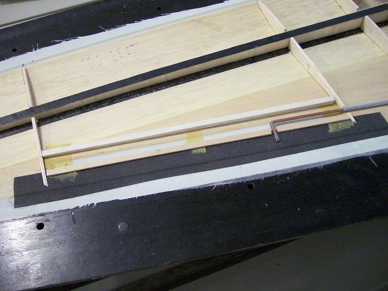

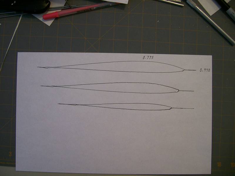

Reference lines are drawn for the ribs and the spar end location.
Then a profile gauge is used to get the shape of the root and tip locations so that the spar size can be determined.
The spar size is critical. If it is oversize, the wing will not close properly. Either the seams will be too thick, or they won't be sealed. If the spar is undersized too much, a lot of extra glue will be required and that adds weight in a hurry.
I drew the root and tip sections. The root measured just over 0.8". With 1/16" skins plus the cloth, this sounds about right since the wing should be close to 1". I have a fiberglass mockup wing and I will check it from the outside to see just what the maximum thickness is at the root..

Using the profile gauge, I created drawings for the ribs. You can see the gap at the rear of each rib, this is where the glue will fill in the gap. I will work on reducing this and making the skins come closer to the edges so that less glue is needed for the edge join. But for now, I need to get the wings made.

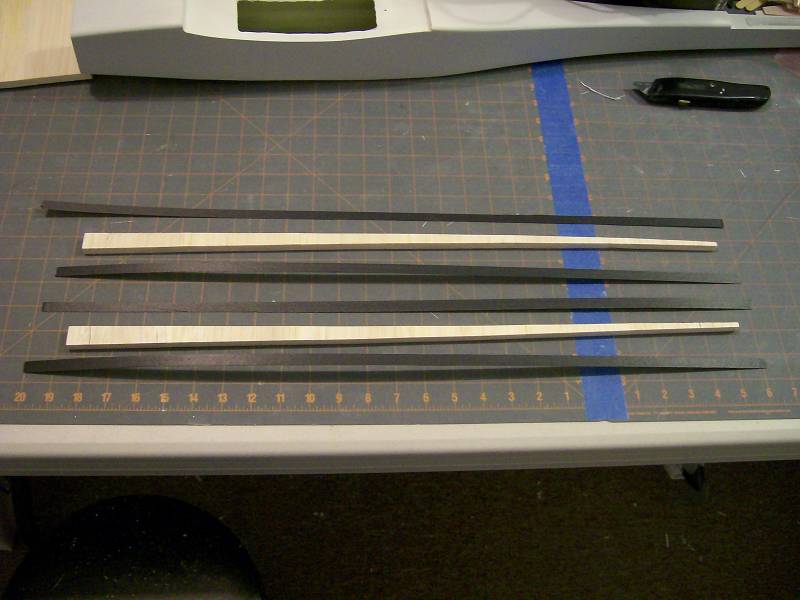

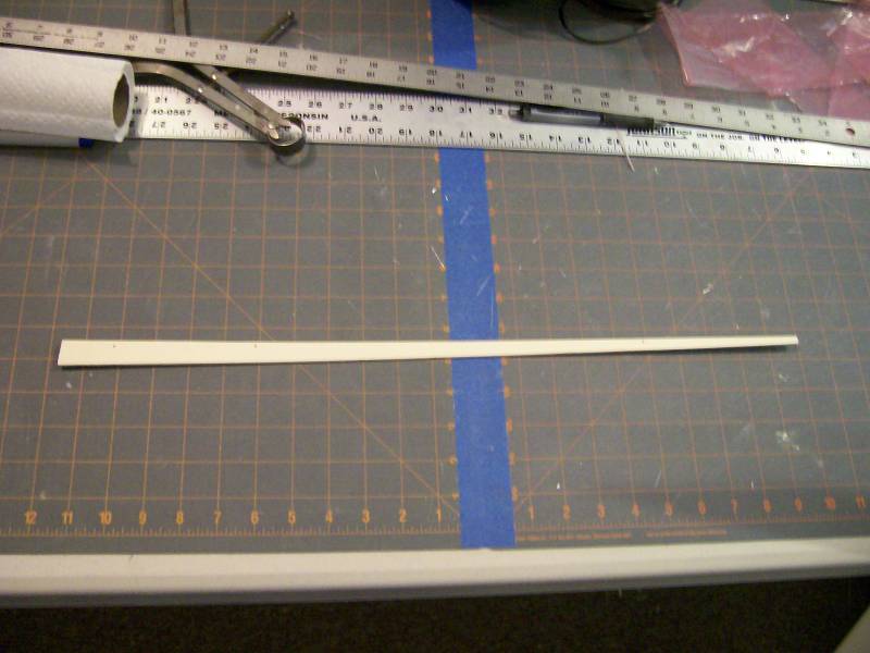

Old 05-11-2009 | 10:57 AM
DonStegall's Avatar
Joined: Aug 2005
Posts: 1,840
I made the template for the spar. I reduced the size by .050" to allow for .014" carbon laminate top and bottom and .020" of gap. That will be pushing it in terms of size, but I think the balsa skins would compress enough if it is oversize by a few thousandths. Plus when I make the balsa spars I will make sure they are not oversize at all.
I made spar material out of a piece of 3/8" x 4" x 48" contest balsa. It weighed 3.7 ounces. I cut it into 8" pieces and glued it with TiteBond yeilding a 24" x 8" piece. This should make spars for at least 6 wings.
While the glue is drying I'm going to cut cores and sheet a couple of wings. So I have to move the spar material off of my cutting table.

Old 05-11-2009 | 07:28 PM
DonStegall's Avatar
Joined: Aug 2005
Posts: 1,840
Here are the spars and the CF laminate before assembly.
Epoxy and cabosil was mixed up and put on the spars. Then the CF laminate was placed on the spars and they were put in presses.
They'll be ready tomorrow.

Old 05-12-2009 | 06:34 AM
DonStegall's Avatar
Joined: Aug 2005
Posts: 1,840
The spars came out fine and the measurements are good. One tips is about .260" and that is .010" over what I wanted, but my measurements were based on pen marks and the profile gauge, so I'm not going to worry about it.
Here's a picture of the spar on the wing.
Oh, the weight of the spar was not bad. 1.1 ounces total. The breakdown is that the wood for each half weighed 0.2 ounces and the CF for each half weighed 0.2 ounces. So I only used a little over 0.1 ounces of glue per side.

The completed torque rod. A 5" long piece of 5/32" aluminum tubing is used as a bushing. The torque rod extends several inches into the aileron as it costs little in weight.
Note that two ribs will have to be notched for the torque rod.
The torque rods are heavy because they are steel. At 0.6 ounces each, they contribute to the weight. But you have to have reliable control. And these are absolutely solid with no solder joints, collars, or screws to come loose.
I think I'm going to start offering these pre-made for my Quickie 500 sheeted wings.

Here is the top of the wing with all of the structure in place. Everything is glued down except the spar. The ribs were CA'd in place as were the pieces in front and behind the hinge line. These pieces seal the wing from air entering from the hinge. The torque rod bushings are just tacked down with CA to keep them from shifting during the join.
Don't know if I'll have time to take any pictures of the glue. If I can, I will. I have to fill the edges, and then put it on the structure, and finally run a bead around the edge. This is the part of the process that makes a wing usable or a piece of trash.

I did manage to get one photo of the glue.
The wing cooked in the hotbox at 80-95 degrees for 12 hours. Then I let it cool for 1/2 an hour.
I took it out and it looks good. No surface blemishes.
The untrimmed weight is 17.7 ounces and I think it will go below 17 after trimming because some of the leading edge glue is in the overhang.

The finished wing came in at 16.9 ounces. It is very strong. The hinges came out just right. They have a lot of movement, but are still very stable. The Kevlar was just the right amount.

Here's a picture of the production tail and wing on an older fuselage. I'm laying up one with carbon fiber in the nose and tail this afternoon.
