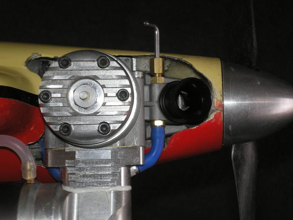

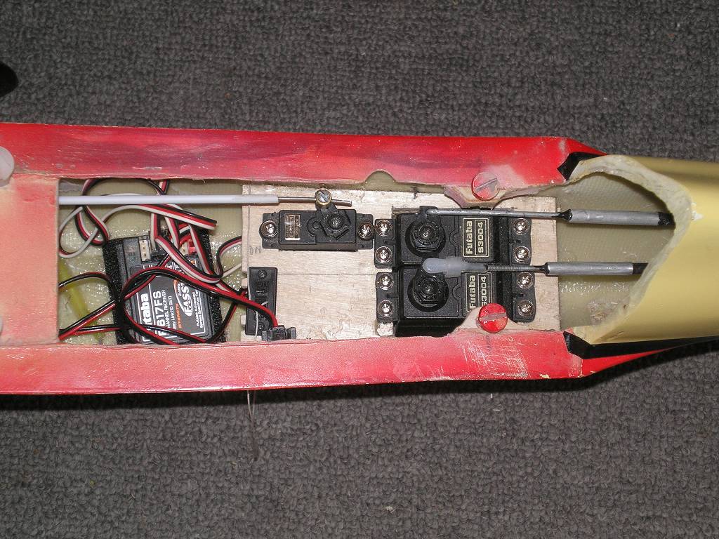

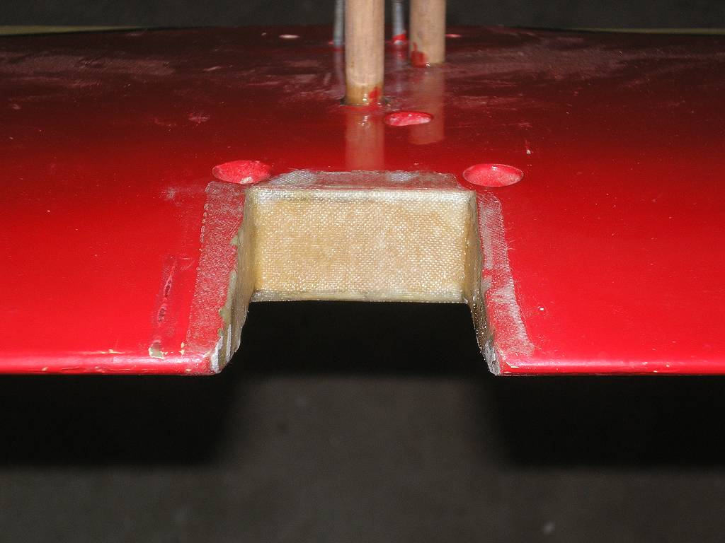

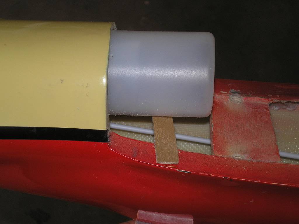

The following show the installation of a Jett Q-40 engine in the Stinger.
A Jett 6 ounce tank is used and is installed in a recess in the wing.

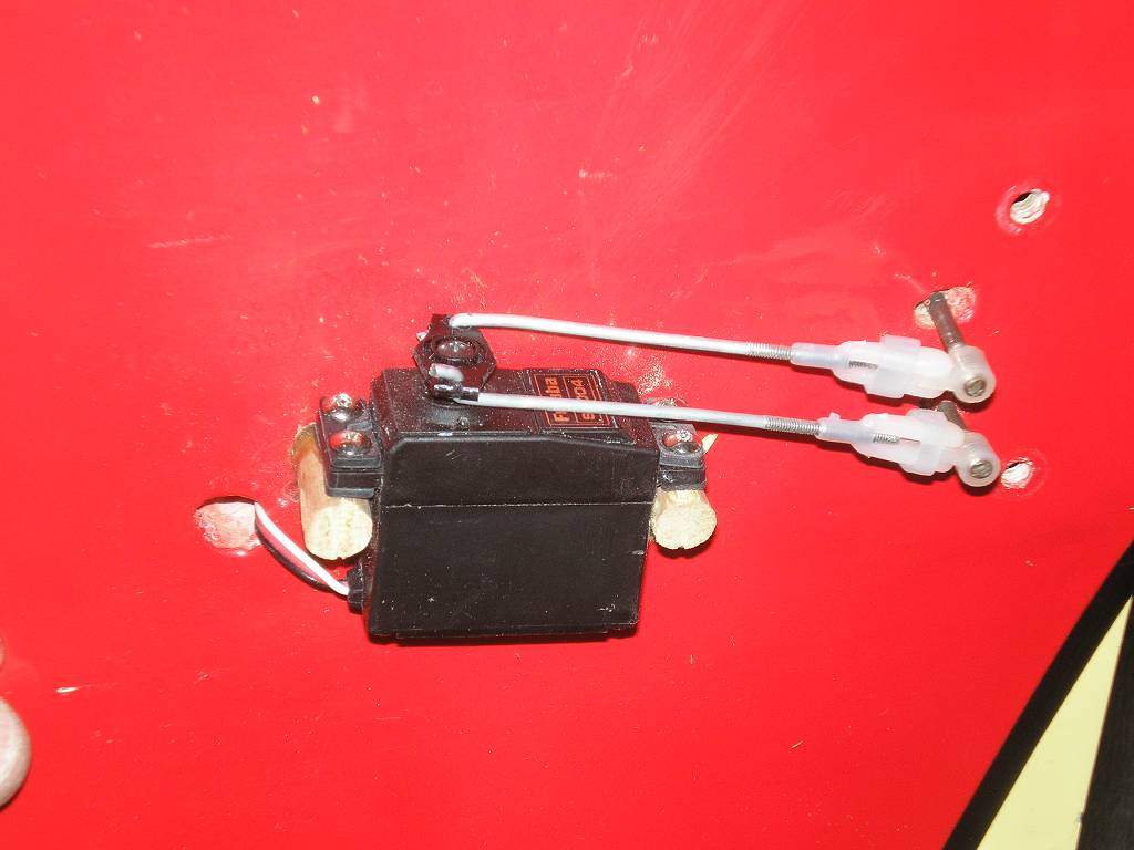

Some full size Futaba servos were installed and seem to be working fine.
There is a slight weight disadvantage (2 additional ounces) compared to mini servos. The model weighed in about 4 lbs. 3 ounces.
The model flies very smooth and is a pleasure to fly.
