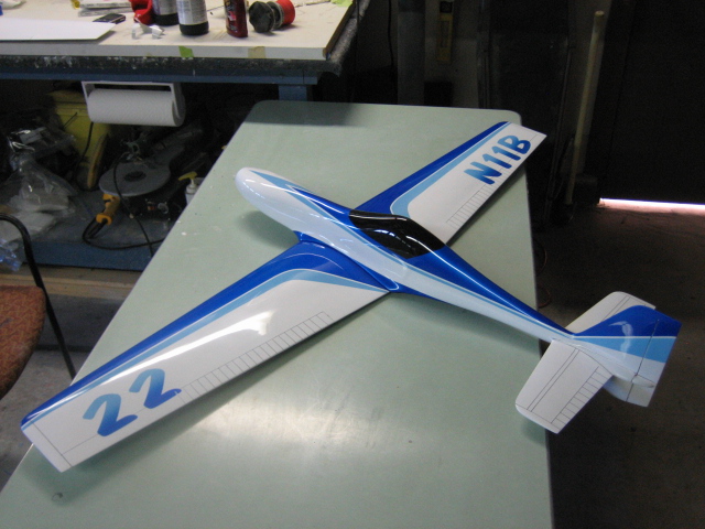

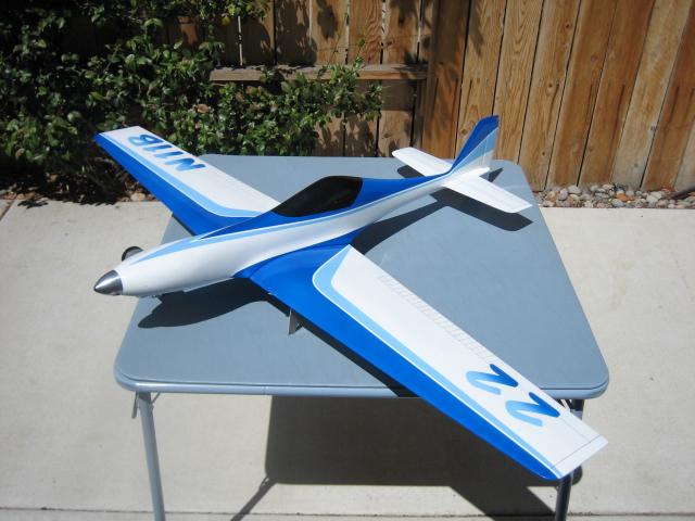

Get your mind out of the gutter I am talking about a toy airplane!
I have had a couple of guys ask me some questions about color sanding and buffing an airplane and since I have to do one ,,, Here goes.
I am going to polish this airplane it is the one John Busse won in the raffle. It is also the first one with a Jett Q40 motor in it. I am also going to be doing the radio install for him but first I need to buff it.

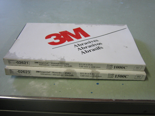

Well the first step is to color sand the airplane, I use 3M 1000 ang 1500 grit paper one sheet of each is plenty.

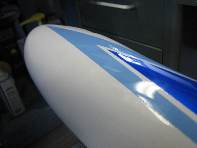

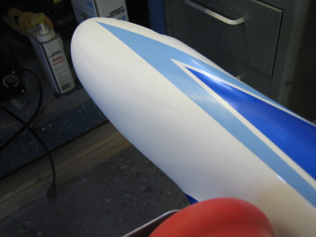

Here are some before pics as you can see it has some small dust particles in it as well as being dry with not much clear. When I used to do paint work on high dollar street rods I would never let the customer see it before it was color sanded and polished because they always looked like crap but on pourpose. Urethane paint if you put it on thick and shiney once you polish it it gets a mottled look to it that if you look down the side of the car you can see. If you put the paint on dry and then sand out the texture and polish it, it is flat as a piece of glass.
On cars you should be able to put a dime on the ground next to the car and tell if it is heads or tails in the reflection. On airplanes simply smooth and shiney is enough. Mine dont last long enough to worry about much more than that.

Here are some after sanding pics, As you can see there is still a slight lip around the stripes but there is so little clear on these that if you sand it all out it will go through the clear and not look very good when polished. On a street rod at this point you would put it back in the booth and put another couple coats of clear on so you could sand that edge completely smooth. That would kill the weight of one of these models.

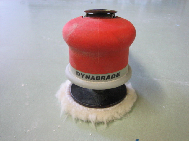

I invested in a little Dynabrade buffer that Jim Allen showed me, It was expensive but very well worth it.

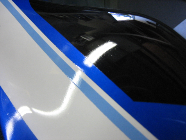

After Glaze apply a coat of hand wax and you are finished!
Here are a couple of before and after shots, I think I see a difference?

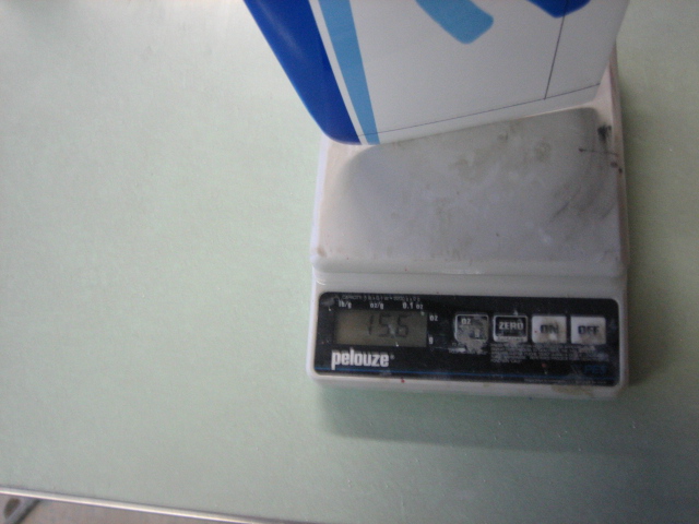

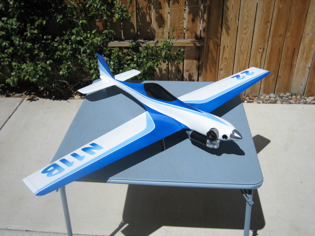

This one is pretty nice, I wish it was mine!!! Aaaa I would just ruin it!
The wing and fuse on scale. Will definately need to add weight!
Enjoy

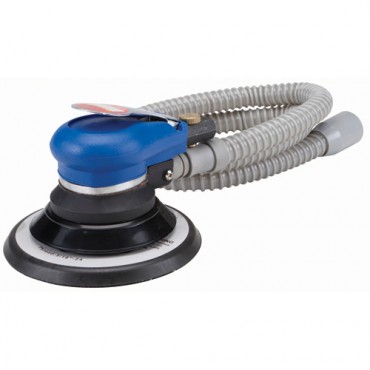

[link=http://www.harborfreight.com/air-tools/sanders/6-inch-self-vacuuming-air-palm-sander-98895.html]Plam sander[/link]
This what I use and cost alot less. $39.99

dynabride is a 2,400 RPM geared, rotary motor, were the 1 I like is a random motion at 9,000 RPM.
Less like to spin the part off the bench.
