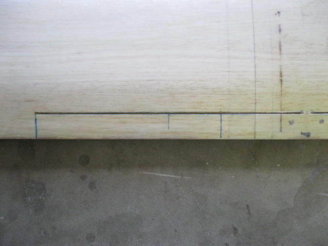

Use the Dremel tool to grind a slot in the aileron.

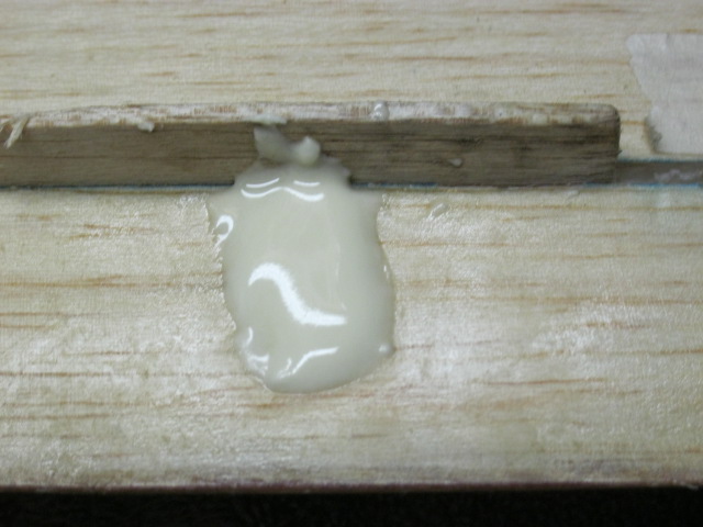

I used a mixture of Skin It epoxy and micro-balloons to glue in the rods.
Masking tape was applied to areas on the wing to keep extra epoxy off.
Balsa wood pieces are used to make troughs for the glue.

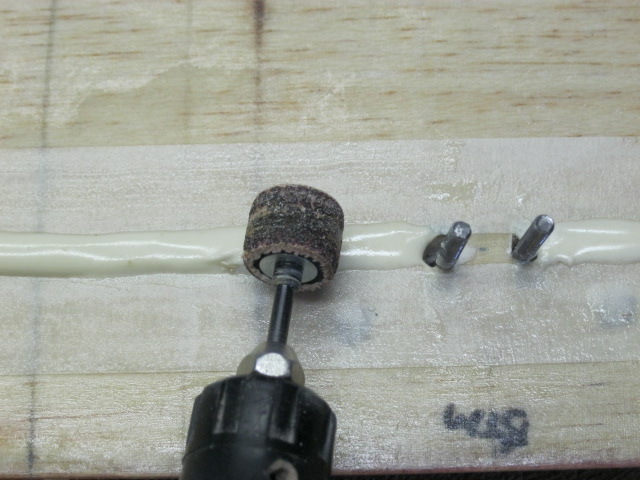

A Dremel tool was used to grind the Skin It near flush.
A sanding block was used to finish the job. Start with coarse sandpaper and then switch to 220 grit paper.

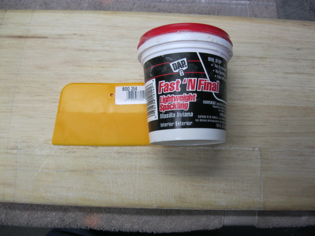

The fabric used for the skinned hinges adds a small amount of thickness. Lightweight Spackle is applied with a squeegee to level that area.
Spackle is applies over the remainder of the wing the same way.
After it dries lightly sand with 220 grit sandpaper.

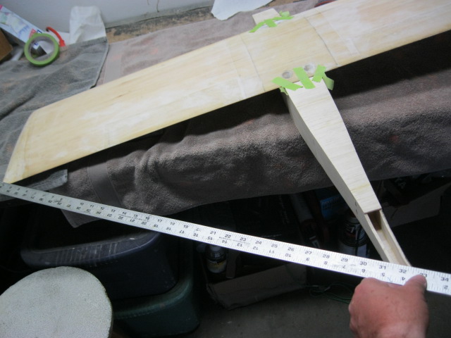

Lay the wing in place and confirm that it is square by checking measurements. They should be the same on both sides.
Tape the wing in place.

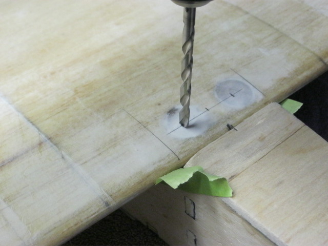

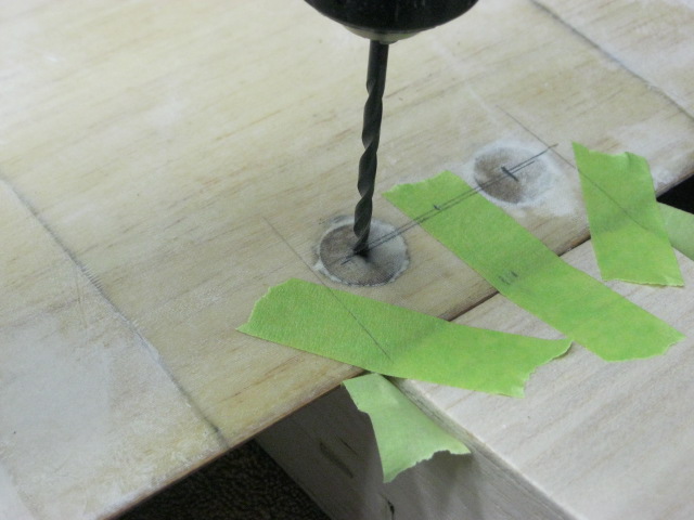

Drill, tap, and install a nylon screw.
Repeat until all screws are in place.
Countersink the heads with a larger drill.

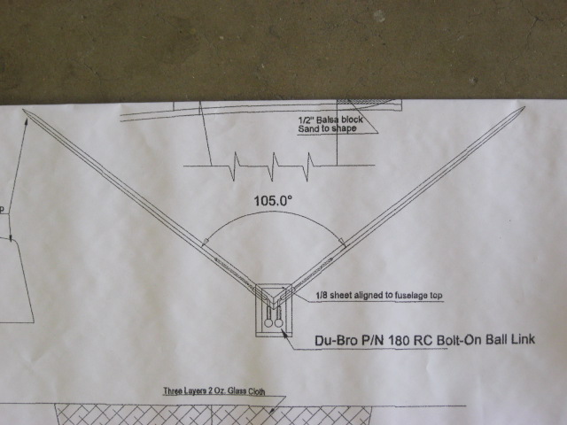

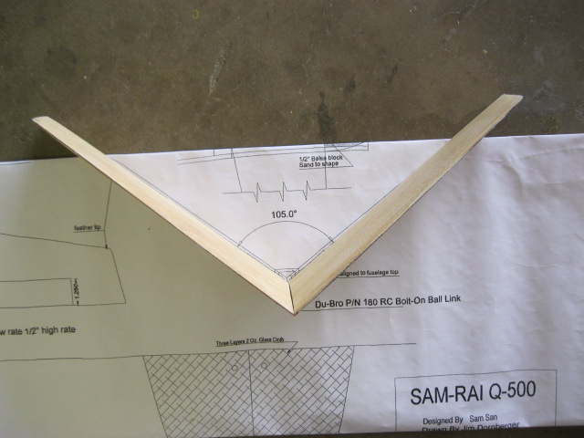

The plans show a 105 degree angle on the tail.

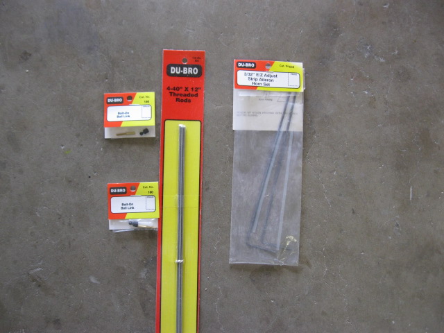

The control horns were made from 4-40 threaded rods and used the tube from a 3/32" aileron horn set.
ID:	1654156   Click image for larger version
ID:	1654157   Click image for larger version
ID:	1654158   Click image for larger version

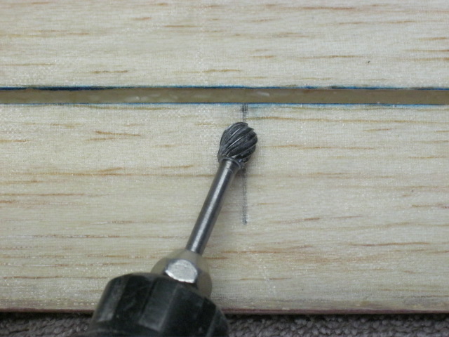

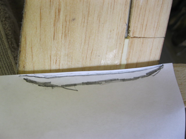

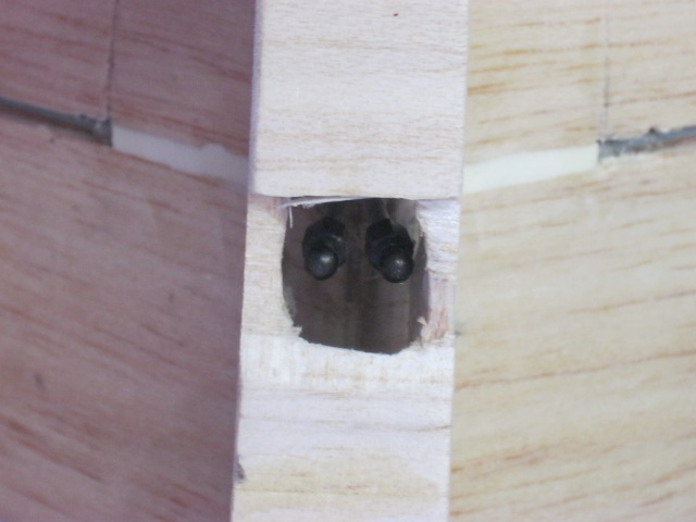

A Dremel tool router was used to cut the slot for the hinge.
Grind out the area for the wire control horn.

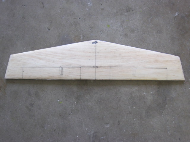

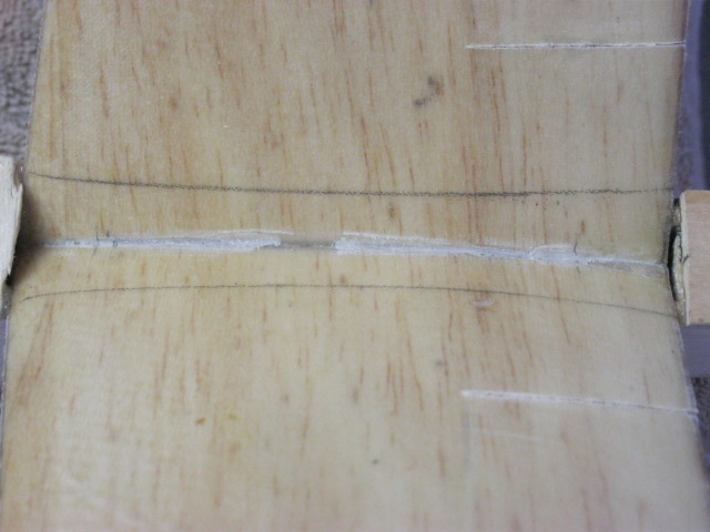

The tail surface was cut in half with a razor saw.
A sanding block was used to sand the angle used at the joint.
The tail surface was tacked together with medium CA glue. After satisfied finish gluing and apply a small amount of baking soda to the CA to fill up the gap.

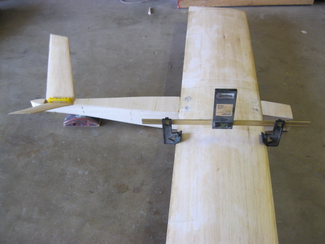

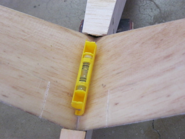

I wanted to find the correct location for the use of a string level.
I found a level area on the floor and checked it with the level. The bubble was in the middle.
The level was then placed in the grove of the V tail. This was placed on the floor and the level was moved around until the bubble was in the middle. This location was marked with a pencil and will later be used when setting the incidence for the wing and tail.

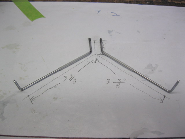

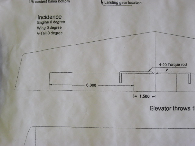

Control horns were bent out of sections of 4-40 control rod.
They were bent to the shape shown on the sketch.

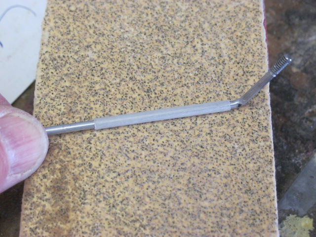

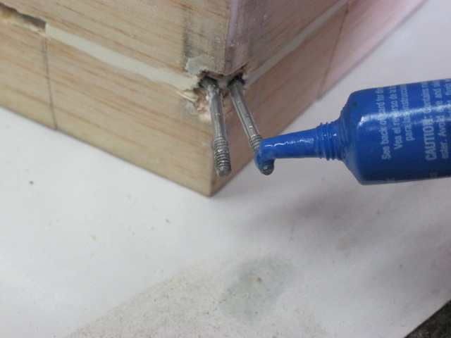

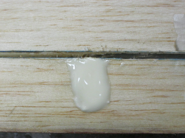

Sand the plastic tube and the end of the wire.
Some Skin It and micro-balloons were mixed and applied to glue in the control horns.
Set this out of the way to dry.

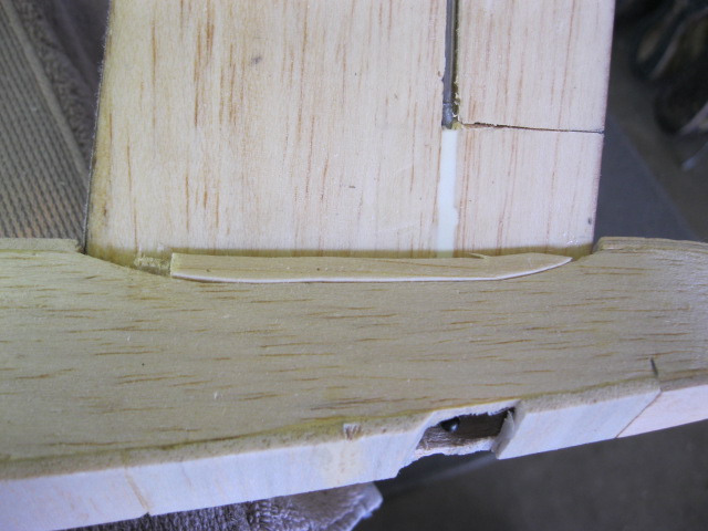

A Dremel tool was used to enlarge the area around the control horns.
I decided to make a hole in the bottom of the fuselage so that the pushrods could be attached later.

Old 08-28-2011 | 03:15 PM
  #73
Joined: Nov 2007
Posts: 2,060
From: Fritch, TX
Default RE: Sam-Rai Build Thread
The model was adjusted until the wing had 0 degrees.
A level was laid on the V tail and it was adjusted until it was also at 0 degrees.
The tail was tacked in place once everything was square.
ID:	1654540   Click image for larger version
ID:	1654541   Click image for larger version

Old 08-28-2011 | 03:20 PM
  #75
Joined: Nov 2007
Posts: 2,060
From: Fritch, TX
The top of the tail was covered with a piece of 1/8" thick balsa wood.
This was fitted and then attached with CA glue.
