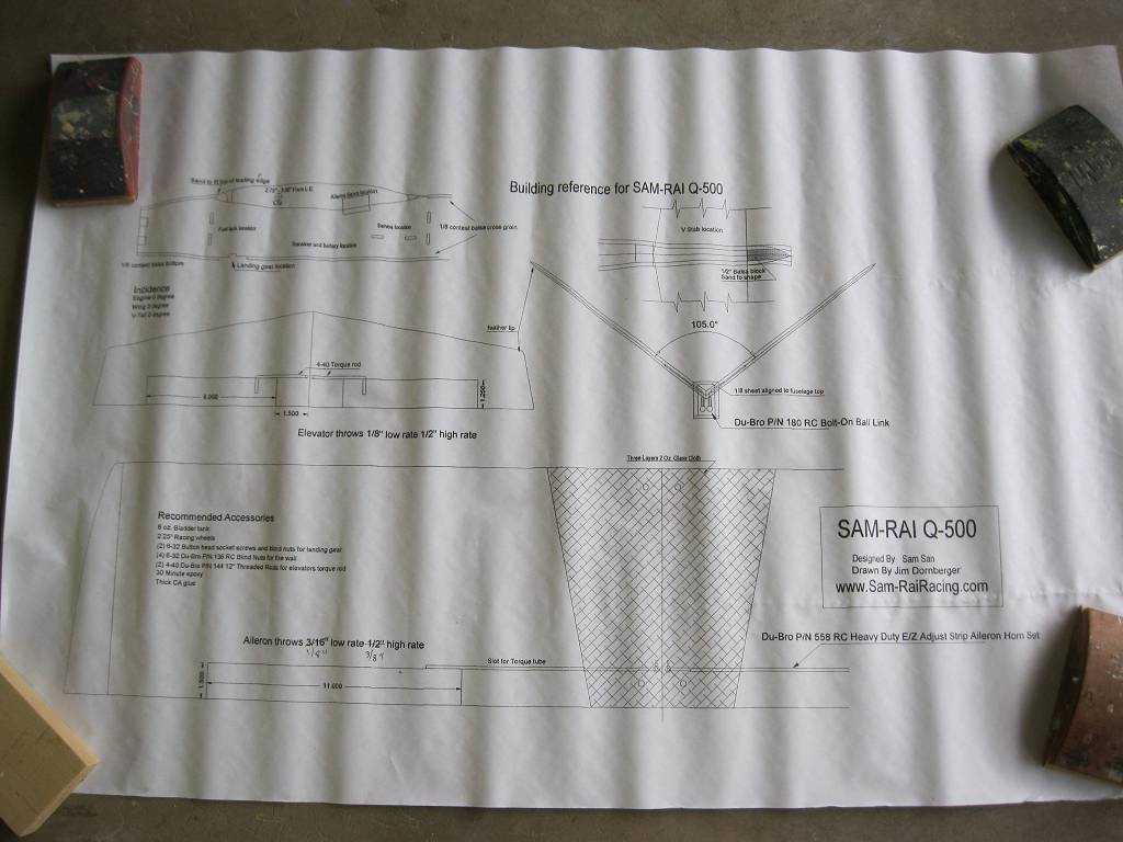

Awhile back I purchased a Sam-Rai wood Q-500 racer kit. I'm now in the building mode so let's get started.
The kit is available at the following site:
http://www.sam-rairacing.com/
It comes with:
1) Plans

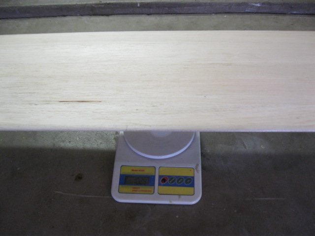

2) Sheeted foam wing - The sheeted cores weigh 10.25 ounces. The airfoil is not a 66012 airfoil. It is thicker on the back side of the airfoil than the 66012. Sam indicated that this airfoil is faster than the 66012 airfoil.

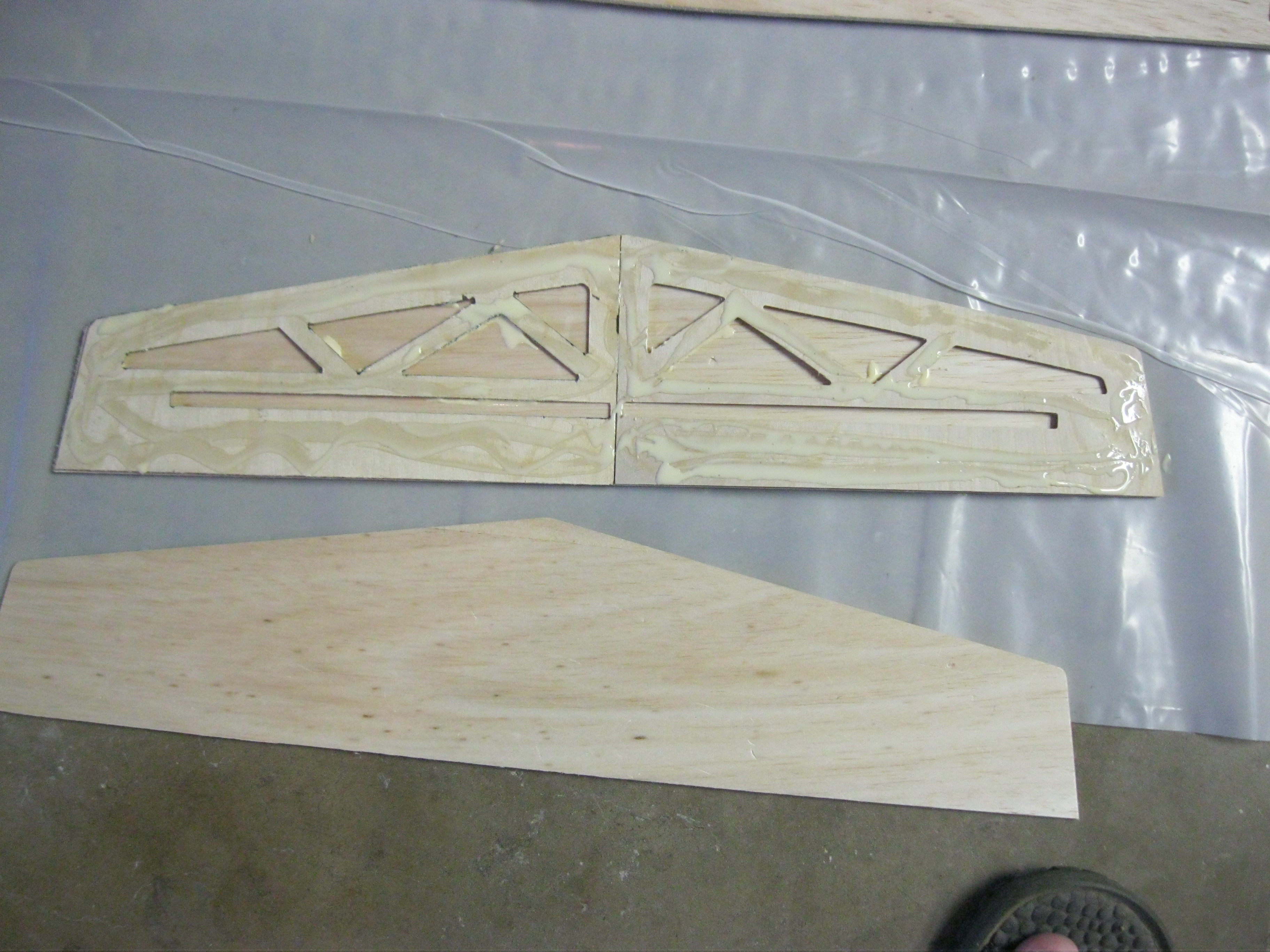

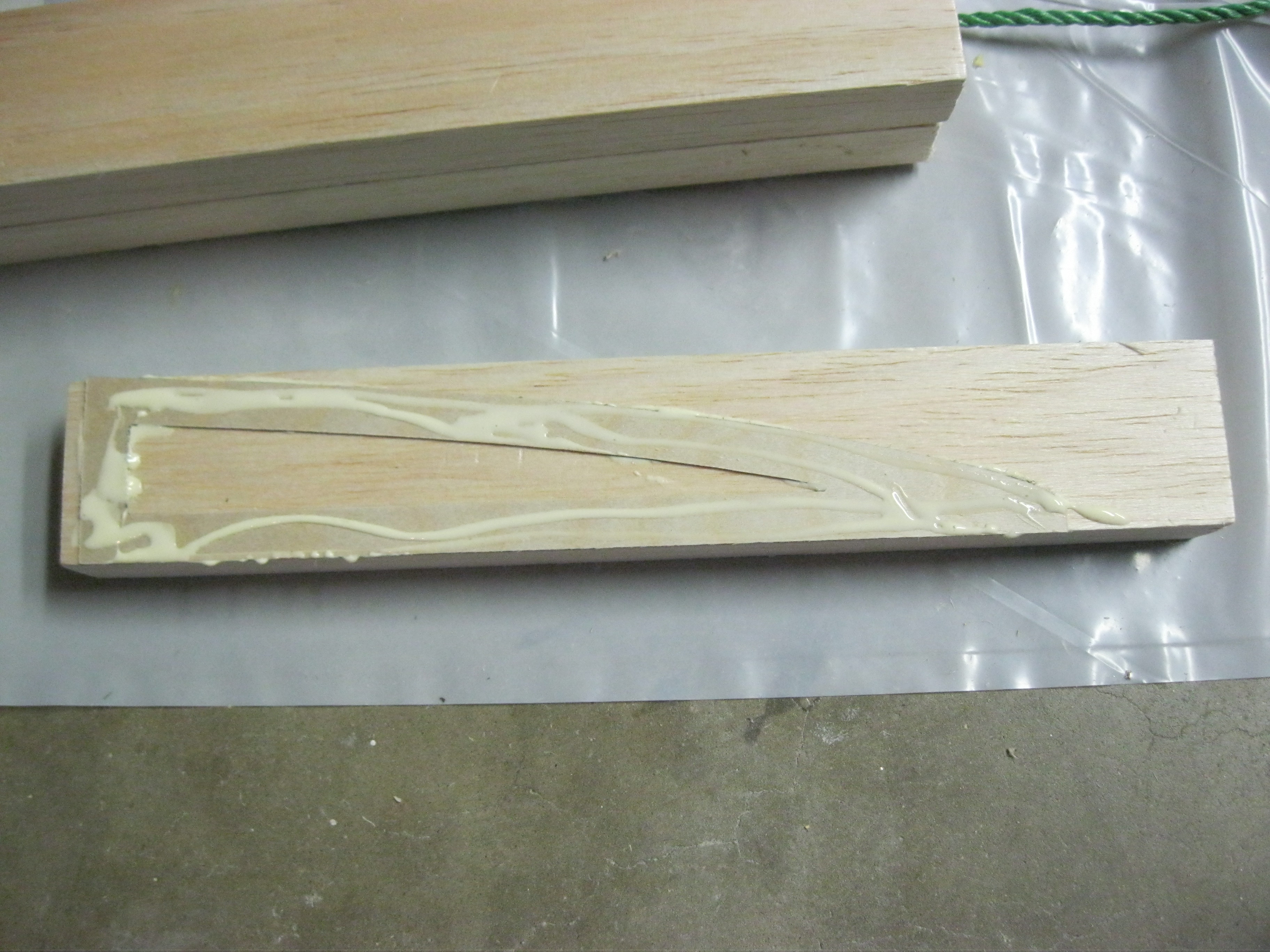

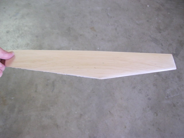

The fuselage doublers were glued to the side using wood glue.
The tail surfaces were done similarly.
The wing tips are made from 2 smaller blocks that are glued together.
A vacuum bag was made from pieces of 4 mil thick plastic tarp. They were sealed together with latex caulking.
The bag was closed and about 6" of vacuum was pulled by the pump.

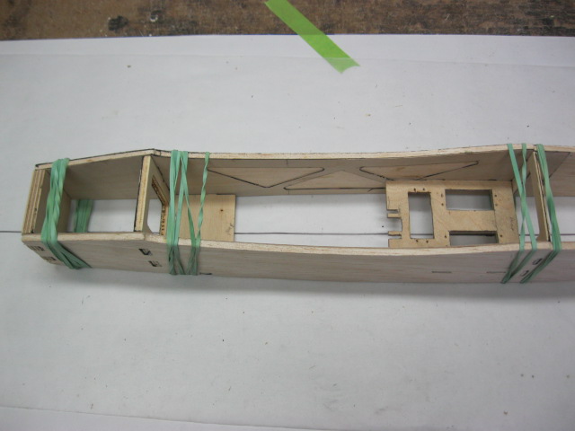

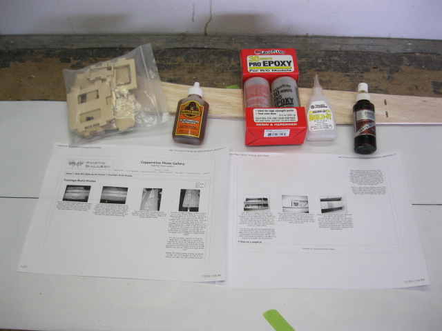

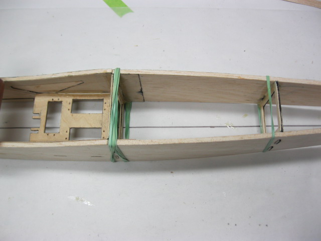

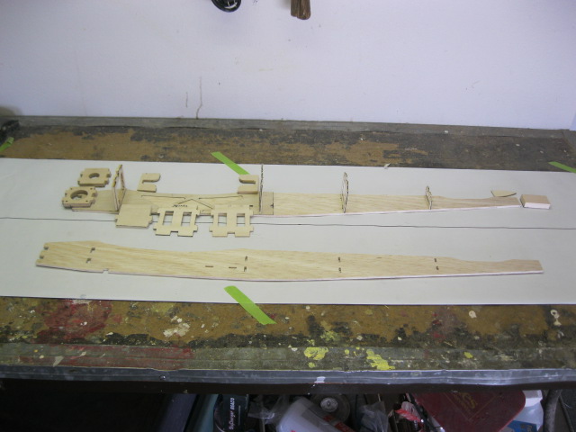

After the doublers are dry you can build a fuselage.
I laid the parts on the workbench to see what was included. The picture (without glues) shows the fuselage parts.
I plan on gluing the body together with "Gorilla" glue, epoxy, and CA.

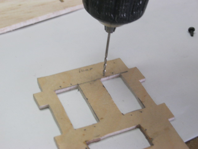

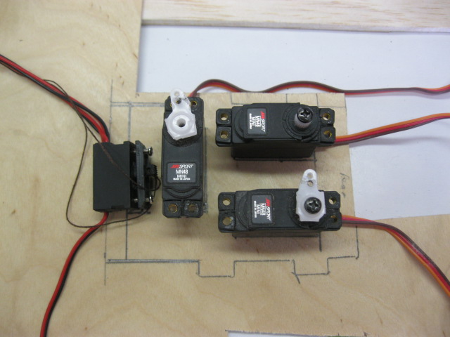

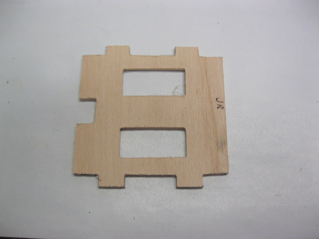

The provided servo tray is set up for two tail surface servos, but does not include the throttle servo.
I am familiar with a three servo installation, so I cut out my own tray.

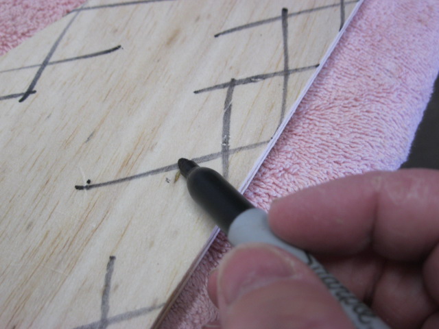

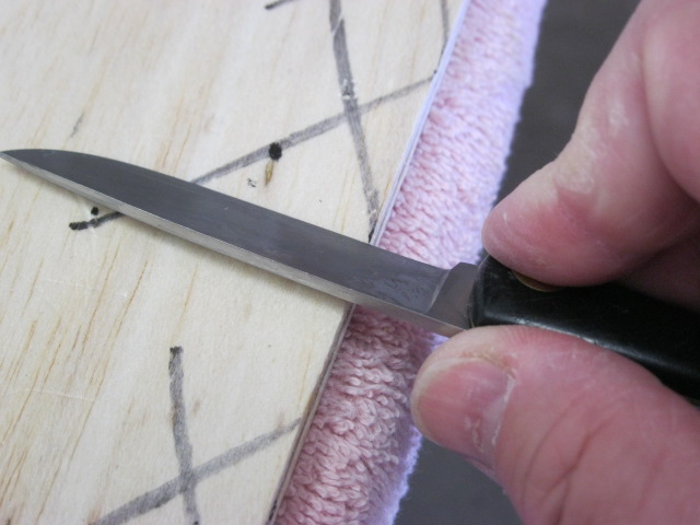

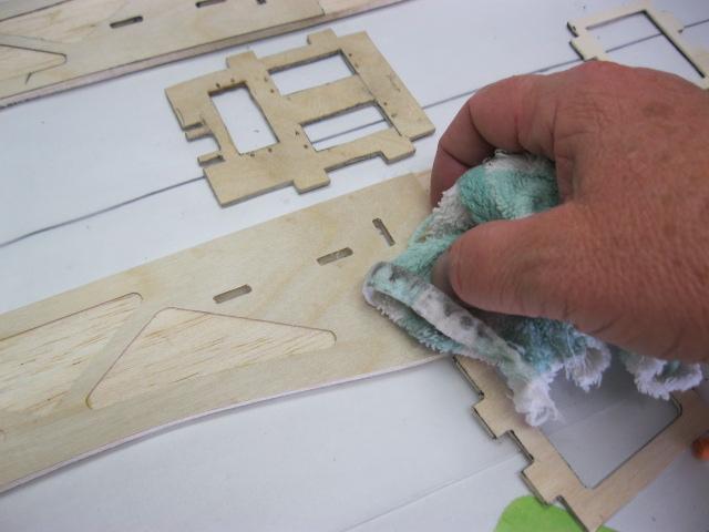

I dampened the surface per the instructions on the "Gorilla" glue. A damp towel was rubbed over the future glue joint areas.

The fuselage was trial fitted before applying the glue. Some minor fitting was required.

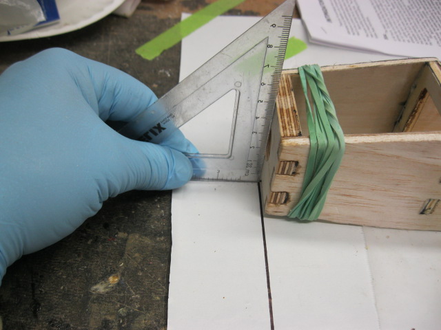

I glued the firewall in place with 30 minute epoxy.
A triangle was used to align the firewall.
Verify that it is true based upon the lines on the paper.

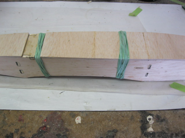

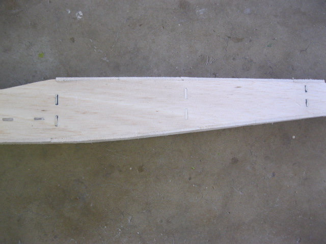

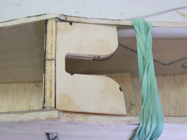

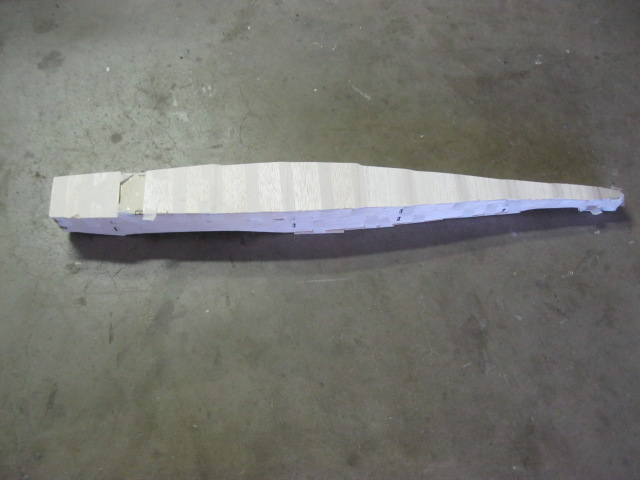

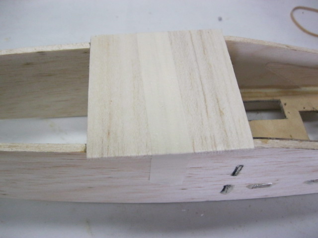

The top and bottom 1/8" thick balsa sheeting was attached with "Gorilla" glue.
Masking tape temporarily holds the sheeting in place until the glue dries.

Old 07-16-2011 | 07:24 AM
Joined: Nov 2007
Posts: 2,060
From: Fritch, TX
Default RE: Sam-Rai Build Thread

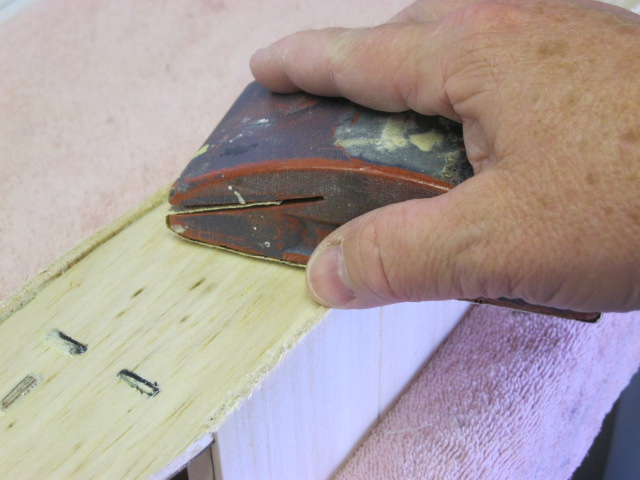

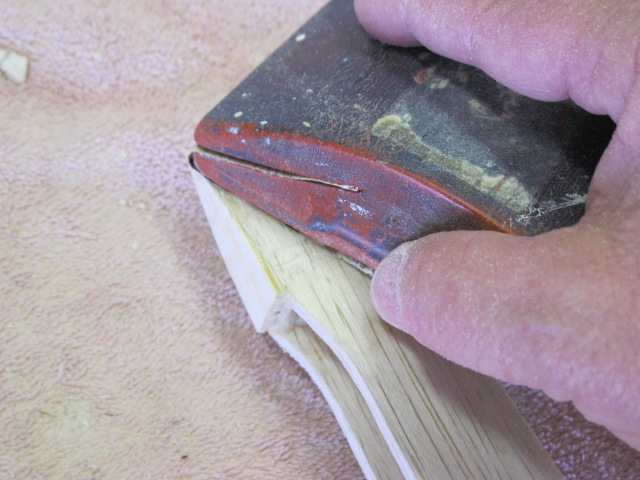

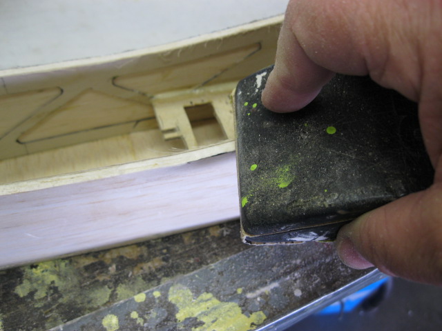

The tape was removed and the edges were sanded square with a sanding block.

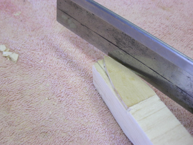

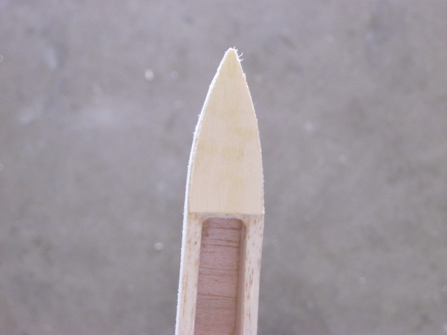

Old 07-16-2011 | 07:25 AM
Joined: Nov 2007
Posts: 2,060
From: Fritch, TX

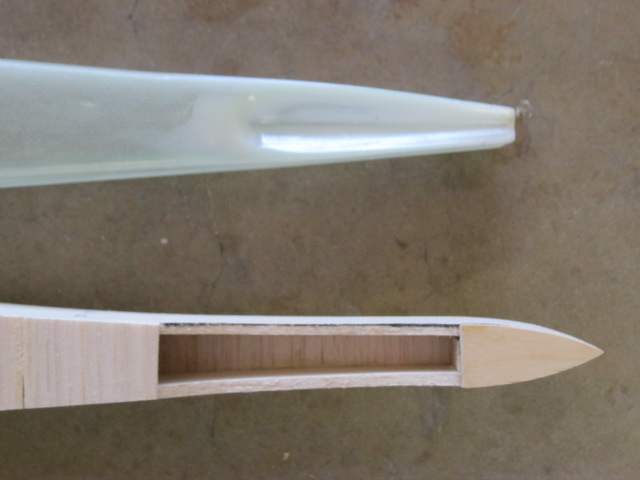

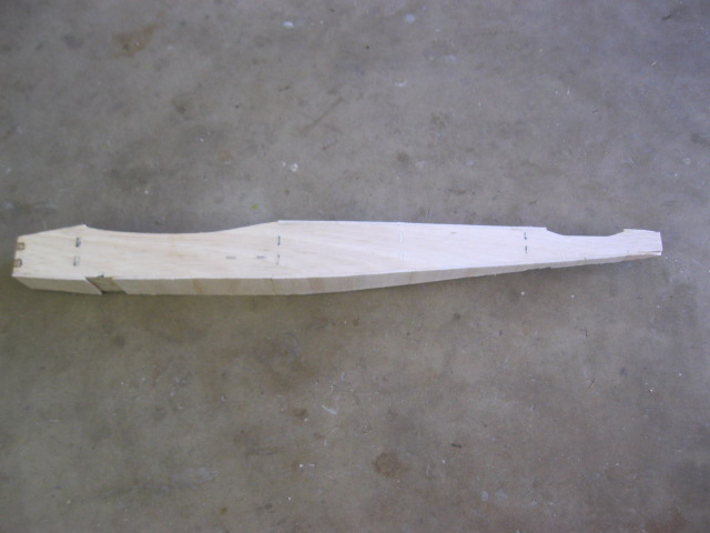

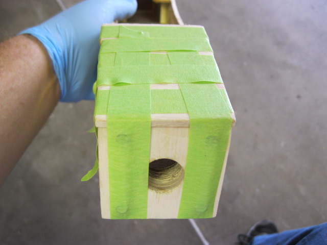

The stinger (tail end) was shaped with a razor saw and sanding block.

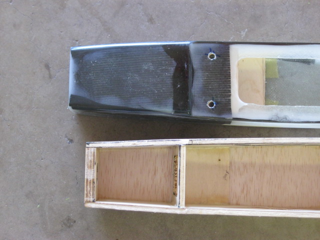

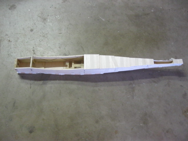

Here are a few pictures comparing the Sam-Rai fuselage with the ViperDog fuselage.
The Sam-Rai has a shorter nose and tail moment (from wing to tail surface) than the ViperDog.

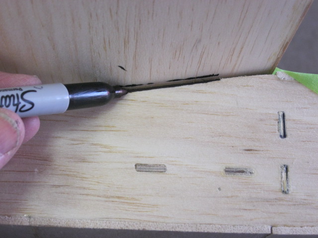

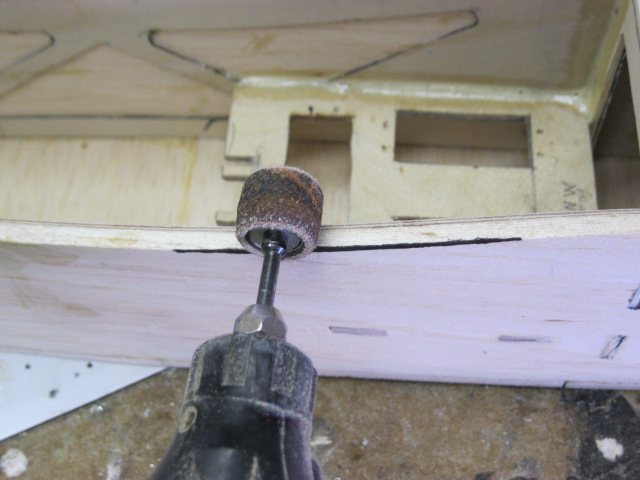

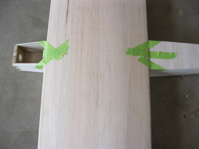

I checked the fit for the wing to the saddle.
The incidence was off and was addressed by lowering the high areas of the wing saddle.
This should be close before gluing the wing mounts in place.

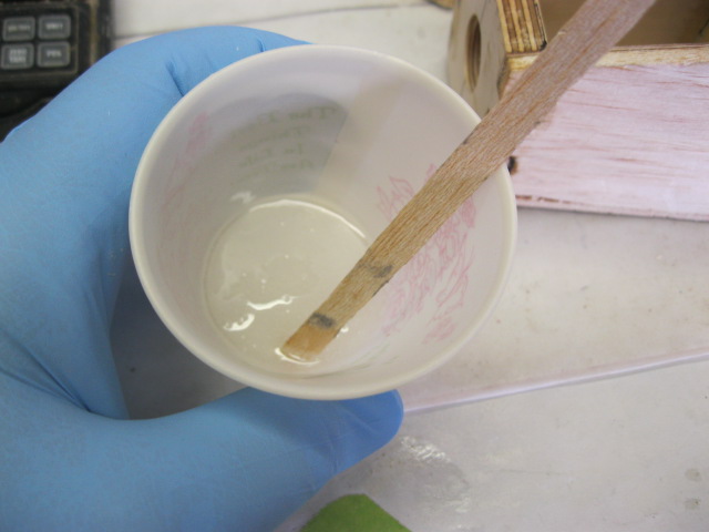

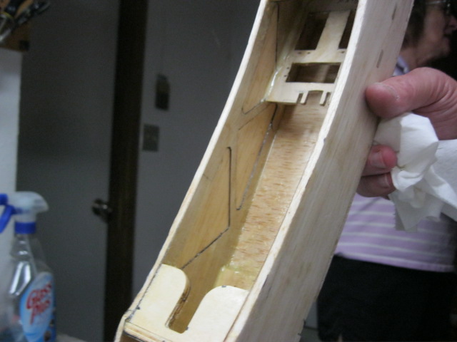

The wing hold downs were glued in place with 30-minute epoxy.
I turned the fuselage over to allow the epoxy to run back in the glue joint.

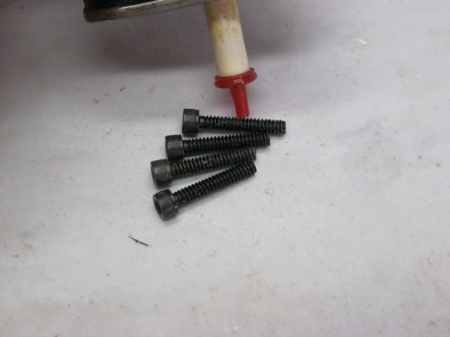

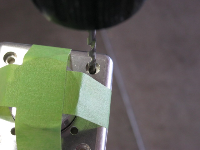

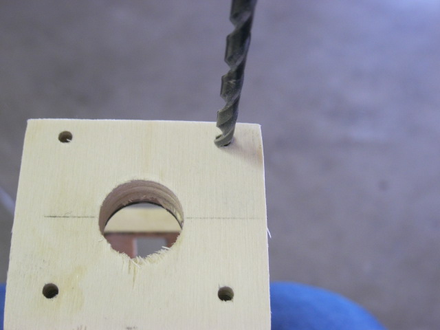

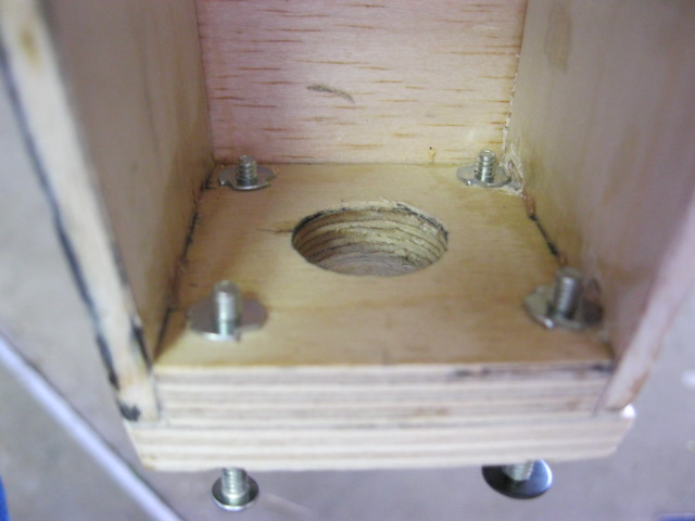

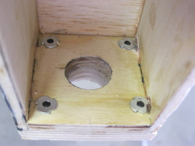

Tape the back-plate motor mount to the firewall to hold it in place.
Drill the holes to fit the mount.
Then drill holes big enough for the blind nuts.
Pull the nuts into the firewall with the bolts.
I then switched to a shorter bolt. Add a drop of oil to the threads to keep glue from sticking.

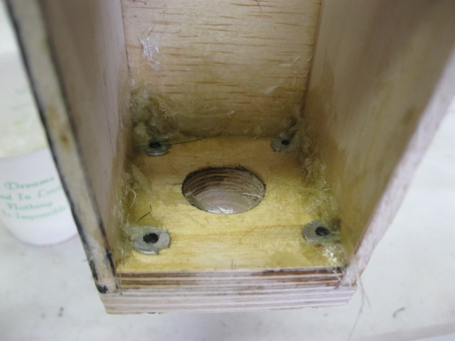

Dab some Skin It epoxy around the firewall, landing gear block, and wing mount blocks.
Sprinkle the cut fiberglass over areas and add epoxy and fiberglass as needed.
Some Skin It was spread over the inner fuselage to seal the wood.

Old 07-31-2011 | 04:08 PM
Joined: Nov 2007
Posts: 2,060
From: Fritch, TX
The top of the fuselage is glued on with epoxy.
I taped parts in place until the glue dried.
After the glue dries the fuselage was rough shaped with a sanding block.

The tail surface was shaped with a pocket knife and sanding block.
