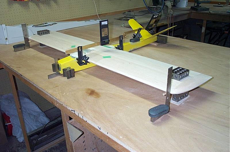

Is it safe to say the pictures speak for themselves? Whether it is a new airplane or, as in this case, fitting/potting a new wing to an existing fuselage the procedure is the same.
Hope this helps somebody.

It's interesting you should post this as I'm about ready to pot a wing... What do you use for potting material? I've used a few things including automotive body filler, epoxy, silicone caulk (just to see if it would work)... It usually takes very little filler to once it's all done so I never thought weight was much of an issue.. Just wondering what everyone else uses...

Lee, I use 30 minute epoxy mixed with a very genererous amount of microballoons. You want it very thick, not quite peanut butter thick, but close.

Nice photos. Are there any complications with not getting the meter on the tail straight to the thrust or center-line?? (ie, if the LE of the meter is Higher than the trailing edge of the meter)
I just knew that was coming. Viewed from the side the elevator hinge line is vertical. It was planned that way. using a set square (Triangle) I draw a line across the tail square to the hinge line. I align the incidence meter to this line.
For filler I use epoxy resin and microballoons.
I have three incidence meters. Once I clamp them on I do not have to take one off to move to another surface to check it.

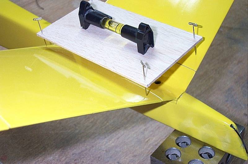

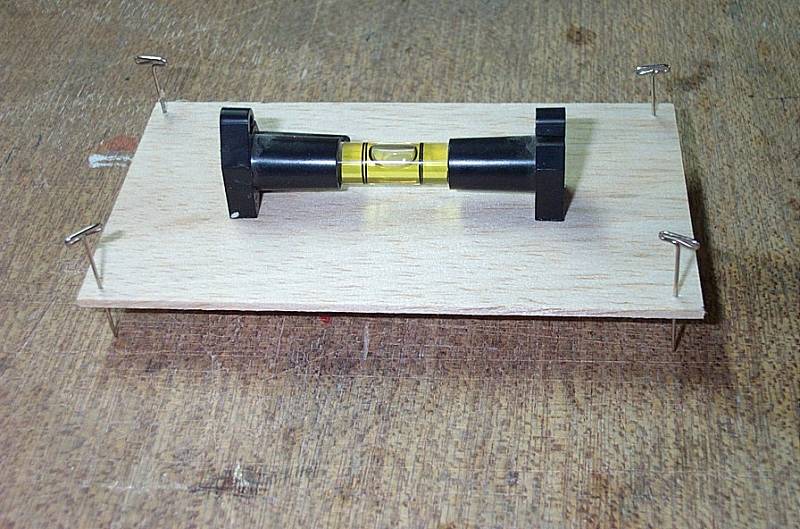

You mean like this? Another little gadget I made up, although not totally successful.
I zeroed the level first on a little platform on a level work surface, then positioned it on the tail. It was a bit fiddly.
Ed S

Old 02-17-2006 | 01:06 PM
Posts: 642
From: Potomac, MD
Default RE: Quicky Setup
No... not quite like that.... being a scratch builder... I don't have that big fillit in the middle when I set the tail on.... I use only the round glass part of the level or a line level works well also. IMHO.... for one of them there $500 composite ARFS.... there should not be a need to align stab incidence.... just align withy wingtips, glue and clamp... if incidence is off... it must be defective... send it back... after the wreck!
How do you stop the level from rocking on the curve of the airfoil?
John is correct. I am not checking a $500 airplane. I am setting up my own scratch built airplane.

I don't know about anyone else but I leave about 1/2" in the middle of my stab that I don't shape... That way after it's cut and put together it's flat.. After everything is set I fill it and shape it. This obviously would be more difficult with a bolt on tail design like Ed's but on the Seekers I fly it works quite well.

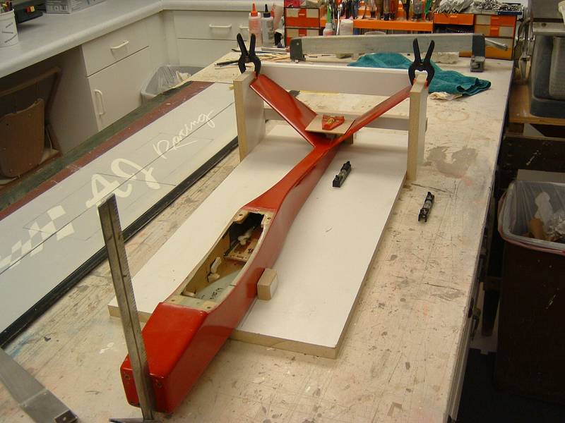

When gluing the tail on my R200 I use a jig I built. My fuselage is fiberglass so all are the same.
See pictures.

Nice jig setup Randy, I can't believe A.J. is using your wings, I feel as though I have taught him nothing
