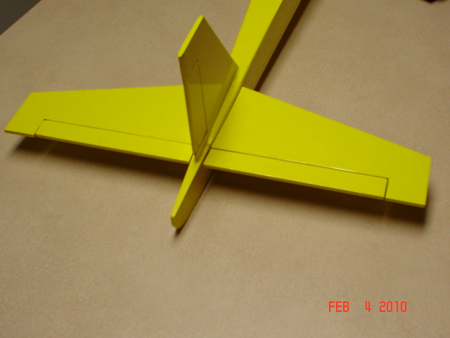

I had an extra Viper fuse that needed repair, so I decided to use it as a test. Pretty simple plug for the rear, epoxied in, the stab still bolts in but I did glue it too. I couldn't figure out how to make it bolt in and be removable except to have some slots in the rudder to screw it in, so it was all permanent. I still need to put controls to it, I will use the stock pushrod location. It will be a while before I finish/test it.

Finally went ahead and put the gear in this one and flew it today. Only took me about a year to do it! Flew very good (to me anyhow) It would have been nice to get a "real" pilot's opinion though... There was not any wind, so it was great to be able to see if there were any problems without fighting it. Now the real test will be wind, and an actual race. It still carries a small amount of up elevator, I set everything at -0- Real happy so far, but the front wing bolts kept coming loose, never had that happen on this one before, or any of my other Vipers. Ready for the Q25 races Sunday, if I get back from Cub Scout camping soon enough!

I'm going to try to be there! Cub Scout camping, I will be cutting it close. I also found more RPM, changed glow plug, and prop, I think the prop had something going on, even though it was balanced, I think it was causing some vibration, losing RPM and shaking bolts loose.
