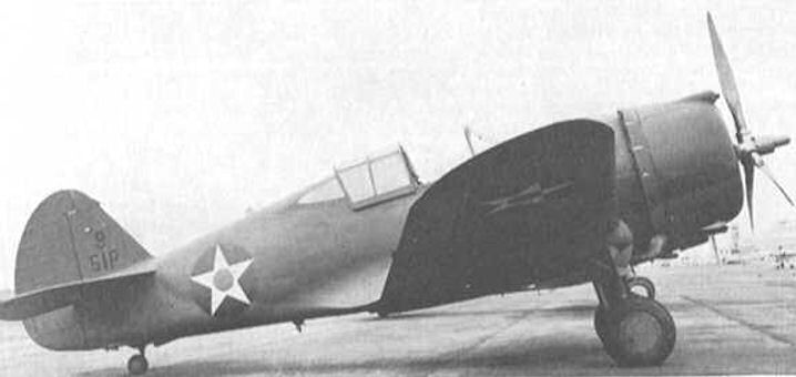

Old 09-30-2010 | 10:34 AM
Joined: Oct 2005
Posts: 11,517
From: Near Pfafftown NC
Default RE: Moving engine forward changes geom'ery?
ORIGINAL: Charlie P.
Some full scale aircraft went from radial to in-line .... As long as the C.G. is kept you'll be fine.
Matter of fact, the P-40 Warhawk was developed from a P-36 Hawk with the radial removed and an inline strapped on.
