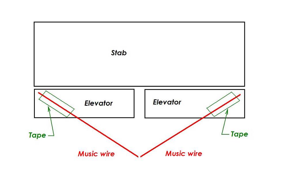

ORIGINAL: Mustangman40
It has an airfoil on top and bottom, it's not flat.
What about this?

ORIGINAL: Lnewqban
What about this?
That right there is the best way in my opinion. I've seen it done with balsa sticks, wire and various other straight objects. Tape them to the two elevator halves so that they don't contact the horizontal and stand behind the plane while you adjust. You'll see every little alignment problem. Works great!

ORIGINAL: Lnewqban
What about this?
The only way this method would work properly is if you got the sticks taped to the elev. at exactly the same angle, and the tips at the exact center of the two elev. halves. This would be extremely difficult because the poster has stated that the elev. surfaces are not flat.

ORIGINAL: tacx
ORIGINAL: Lnewqban
What about this?
His original idea is the best way.
It's not difficult at all. Try it some time.
