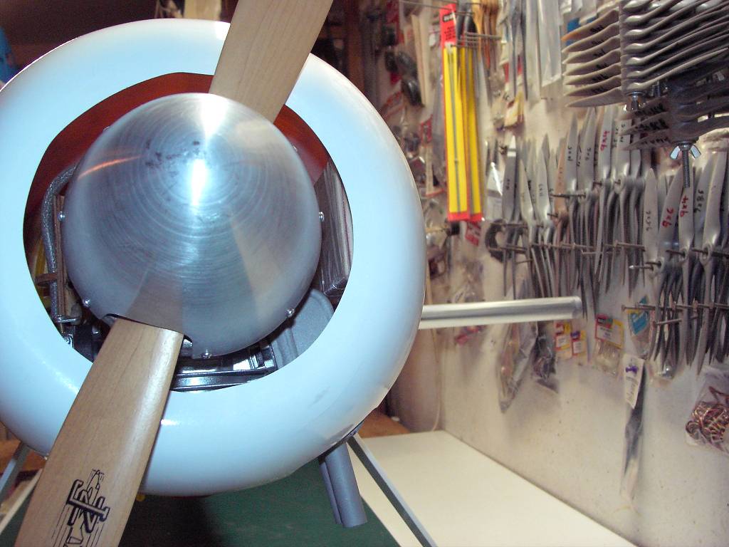

There is one factor though where spinners can make a big difference and that is cooling. On any cowled and specifically a tightly cowled installation the spinner can be an important component of the cooling system.
Here is an example of one of mine that that I beleve the spinner is an important part of the cooling system:
John

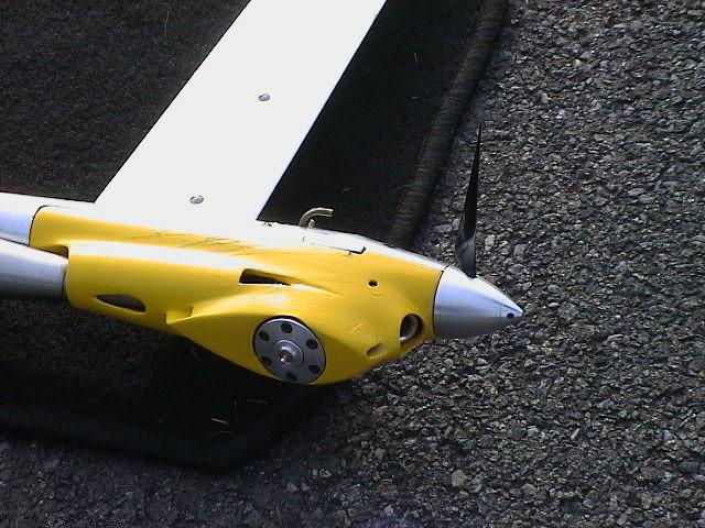

BB I beleve the spinner to provide a stabilizing effect on the air before it enters the inlets and thus allows a greater velocity.
A pressure cowl noted by Les relys on a greater sized outlet than the inlet (usually to the rear and bottom but not always) to cause an increase in the velocity of air moving through the system.
Here is an extreme example (not my airplane). Note the tiny inlet but roughly twice the outlets one on each side to the rear of the cylinder bonnet.

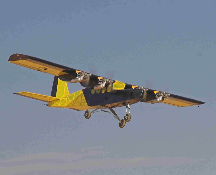

On A sport airplane such as a stick of some sort or one of my multi engine bashs where the engine are completely exposed all of that is moot and I love the simple spinner nuts.
John

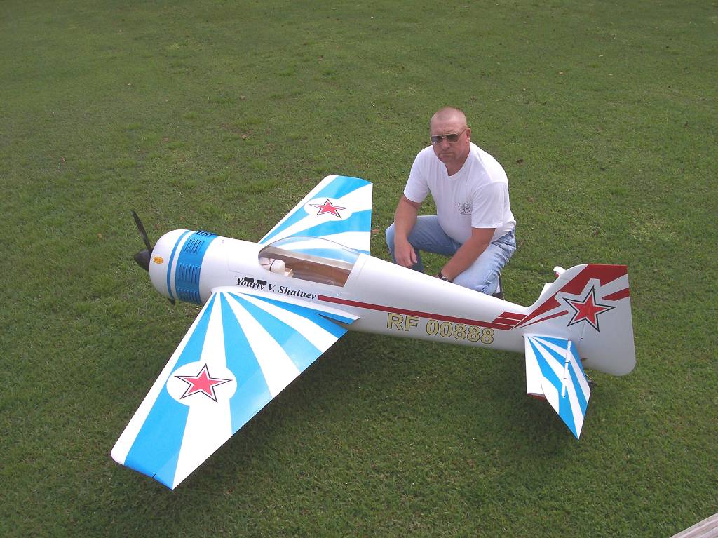

I ran a Carbon fiber spinner (5") on my Yak for one season and during hot days saw a noticable decrease in upline performance. I since have run two seasons with the spinner removed and my motor seems to be running cooler because i dont start bogging down on the uplines. That said, my Yak appears to fly a bit slower with the spinner removed. Here is a pic with it & one with out it....Gene
