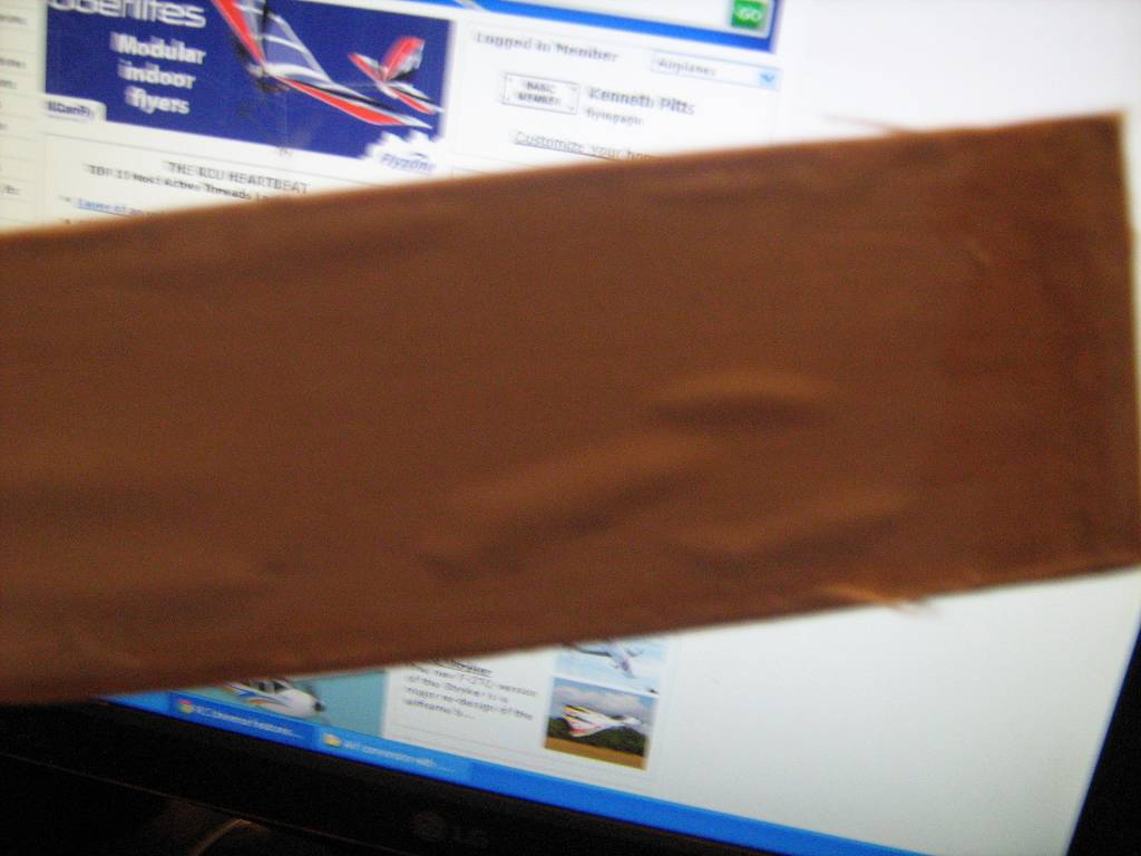

I changed to useing fabric cut along the salvage. Helped a small amount. But what really did it was LOWER TEMP. I turned the iron down to just barely enough to attach the fabric. And that is the same temp I am shrinking with. Now it is working good. For future projects I will continue to use the dress linning. But I may use a purpose made fabric on small surfaces, especially solid ones.

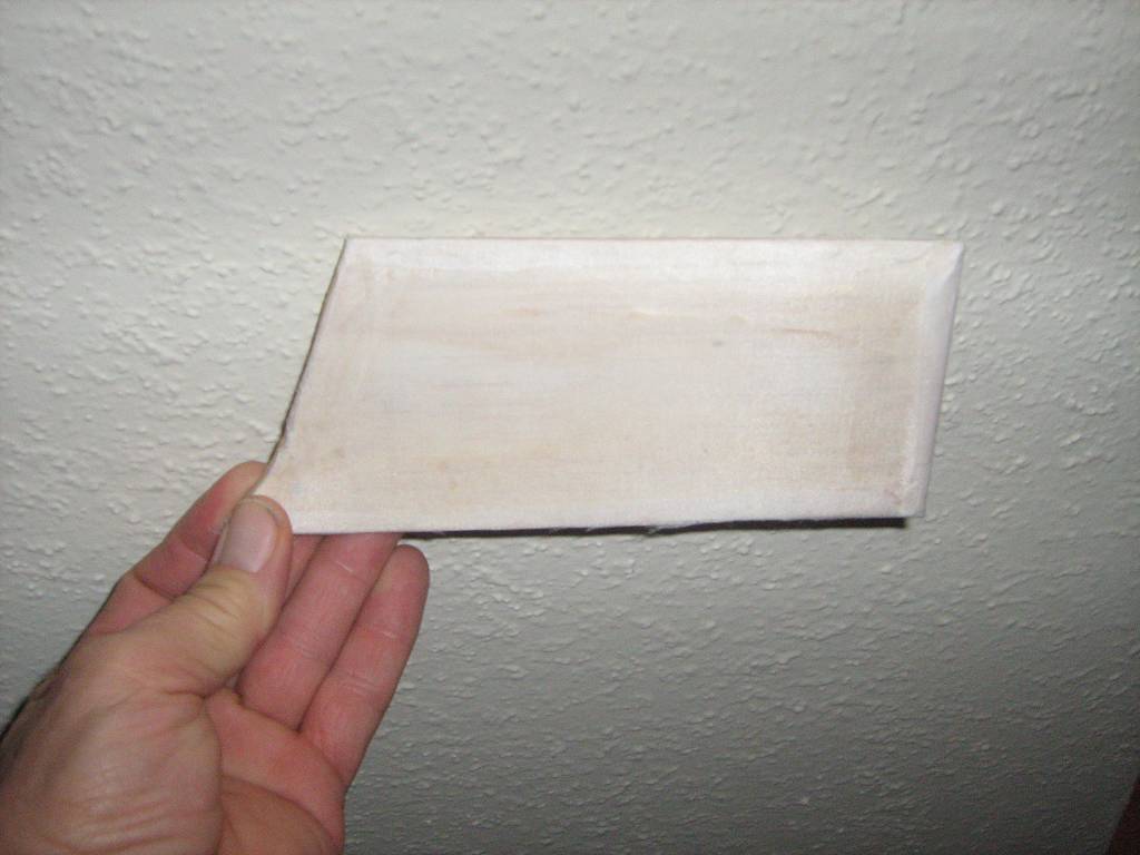

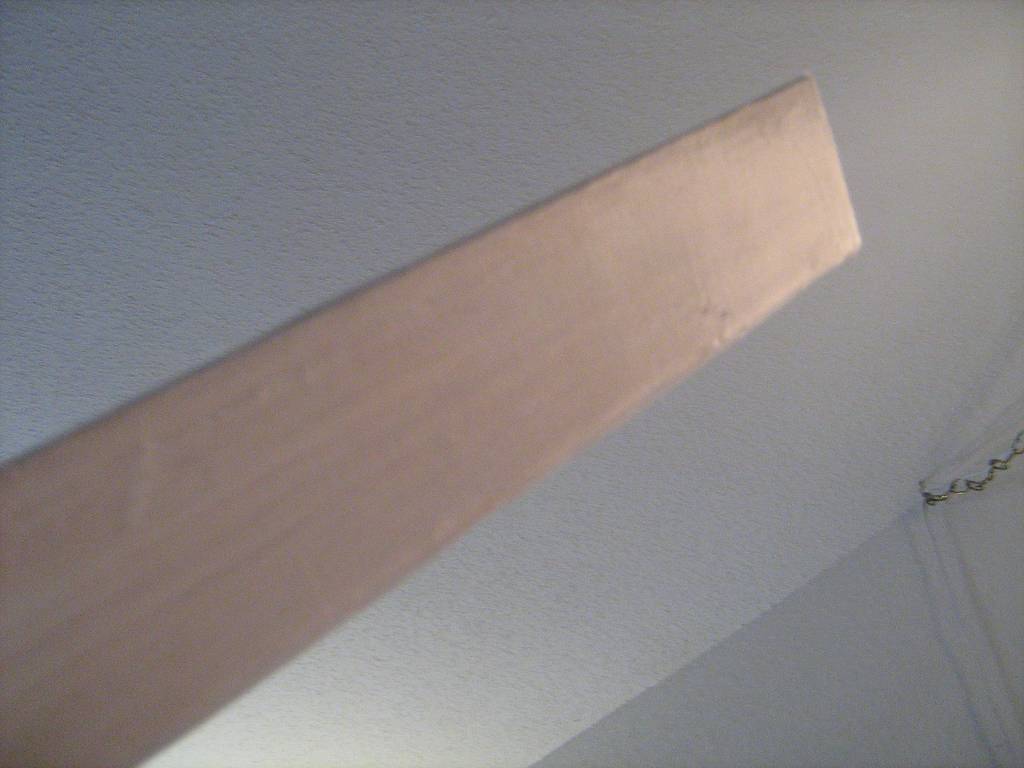

<span class="Apple-style-span" style="font-family: Verdana, Arial; font-size: 13px; background-color: rgb(251, 252, 255); ">I went to Joann's to try and find some linning by<span class="Apple-style-span" style="font-family: Verdana, Arial; font-size: 13px; background-color: rgb(251, 252, 255); ">Sunline. It was not Sunline, but was stiffer and maybe a little heavier, so I bought a yard.
I covered a scrap piece of stock that was actually a little more narrow than the control surfaces. Looks good so far, but will let it be for awile, maybe throw it some place much more humid or something, sort of a worst case test.
