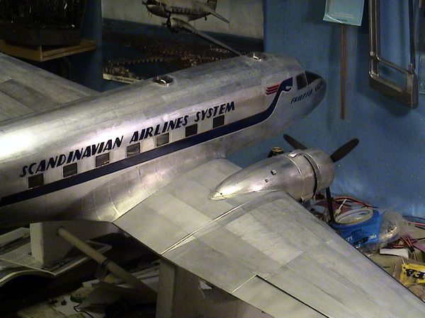

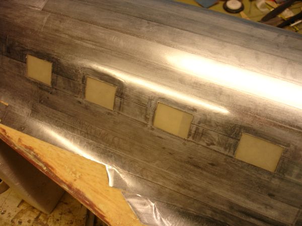

Posts: 7,816
Received 10 Likes on 10 Posts
From: Upplands Vasby, SWEDEN
Default RE: Flite mental, interference or no problem?
Hi!
Had doubts myself when I built the Marutaka DC-3 which were covered with chrome Oracover on the fuselage. But there was no problem at all!
My trusty old (1994) JR X388, 35 mHz radio had it's normal lenght (100m) with transmitter antenna fully collapsed (receiver antenna inside the fuselage).

My Feedback: (-1)
Joined: Apr 2003
Posts: 14,400
Received 9 Likes on 8 Posts
From: Hemderson, NV
Jaka, he is talking about using aluminum tape, real metal. Ultra covering has no metal in it. Here in the states we can get real metal covered tape at hardware stores and plumbing supply places. I have seen people use it on models on places like hatches and doors but never a complete plane. Not only can there be signal loss but the added weight of the stuff??
