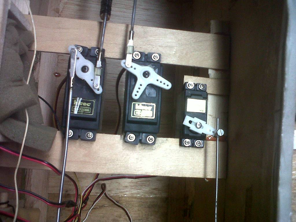

Ok, here is a little more info. They are Hitec ball bearing, HS-700BB is the servo number, and here is a pic of what Ive got and I have a total of 4 of them in this aircraft. The wingspan is 8' and it is a scratch build cherokee.

5 cell is fine and run at least 2000 mah

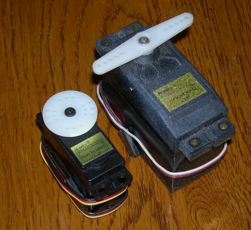

Easy now! I'm not THAT old! I"ve just been doing this since I was 12
Tower used to sell "1/4 scale servos", heck I ripped the output gear right out of the top of one of them with aileron flutter on a giant telemaster. Yes, they were physically bigger than standard size servos. Truth is there's probably mini's today with titanium gears and more torque

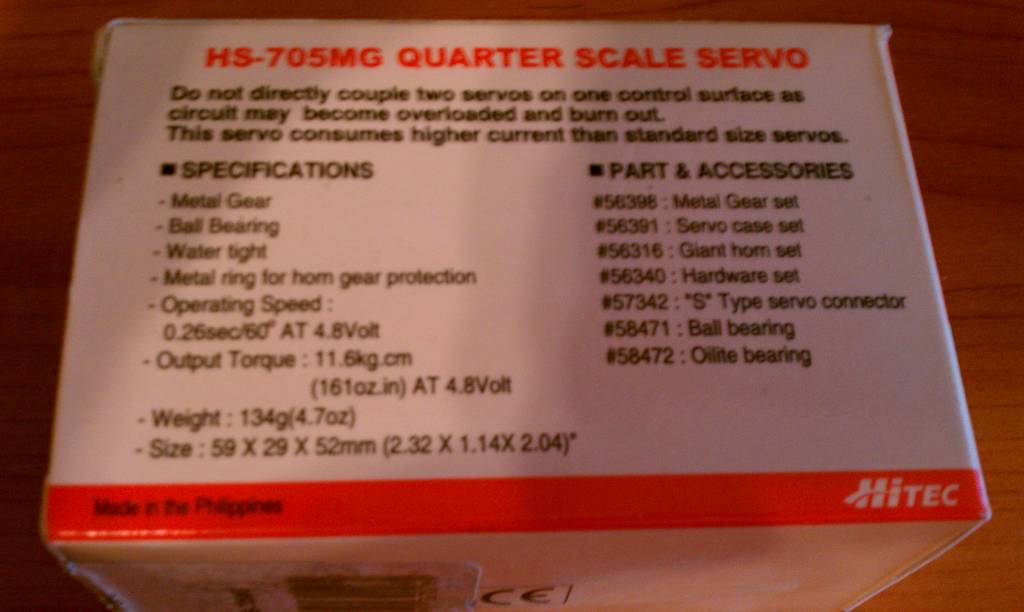

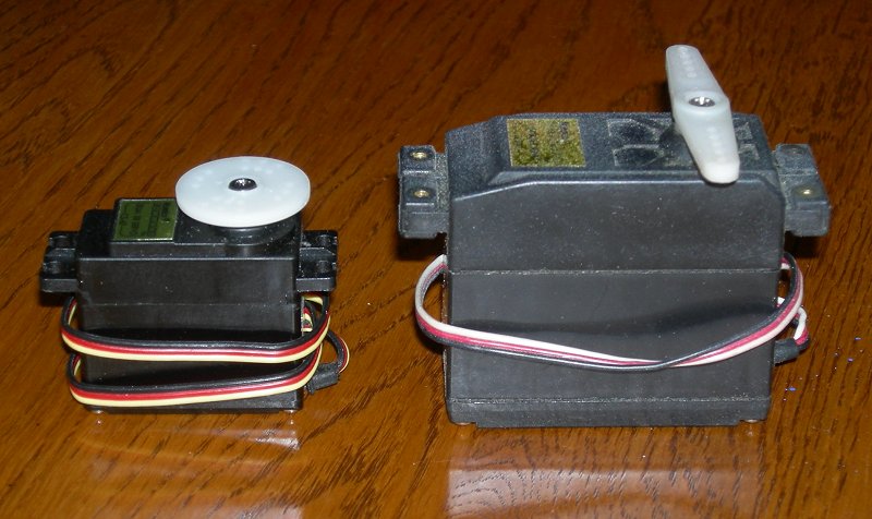

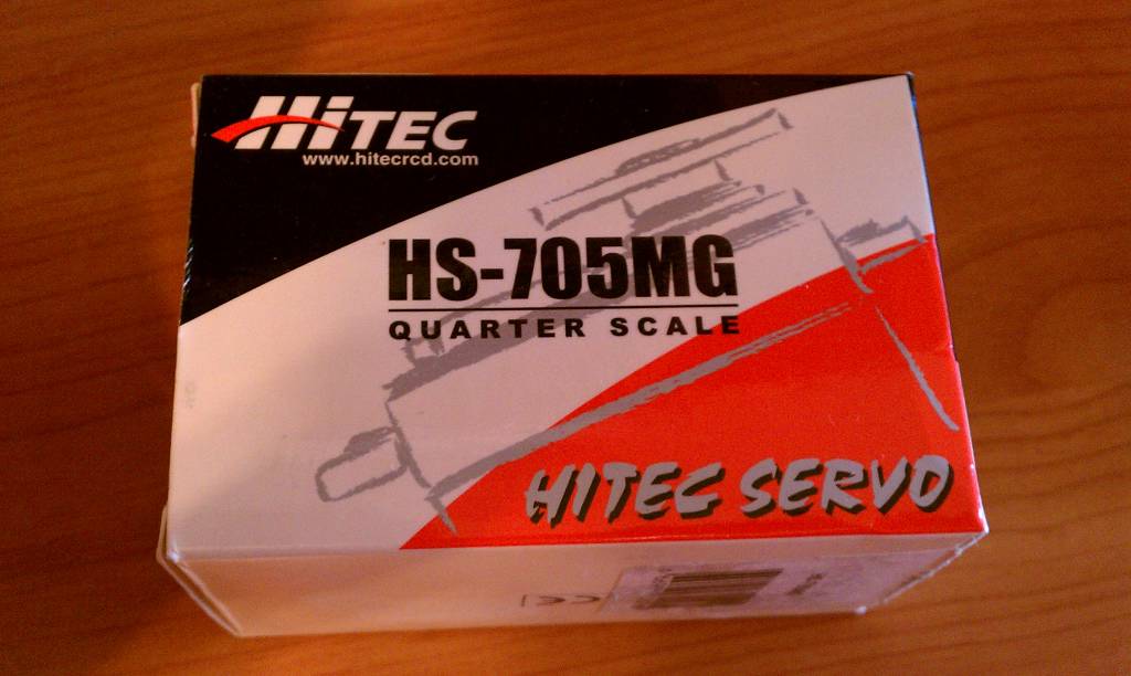

Here's an example, purchased in the last 10 years:
ID:	1710752   Click image for larger version
This page http://www.servodatabase.com/servo/hitec/hs-700bb shows the specs for your servo. And if you need to replace one, ServoCity says use this one: http://servocity.com/html/hs-755hb_1_4_scale.html
