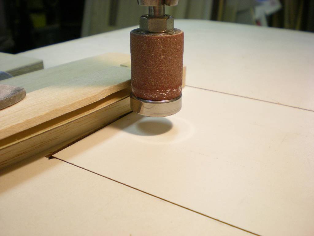

I've used some of the methods mentioned above with good success. Instead of using a router bit I use a drum sander with a bearing on it. The drum sander is chucked into a router set into a router table. Use only a variable speed router at LOW SPEED. You can also chuck the drum sander into a drill press, but the template would need to be on the bottom using that setup. I cut the ribs out to a rough size on the bandsaw first. Sanding drums are available at woodworking supply stores like Woodcraft.

ORIGINAL: yel914
This is actually very cool and easy to do with a drill press. Though I'm not sure I'd use a balsa template. Me and my heavy fist would probably dimple it with the bearing.
Thanks for the tip yel914....

You're right, a balsa template is a bad idea. I just used this as an illustration of the procedure. I usually use a product called Chemetal for templates. It's thin brass bonded to laminate(formica). The stuff lasts forever and I have a bunch in my stash. The main advantage over using a router bit is there is no tearout when climbing the grain. Much more consistant results.
