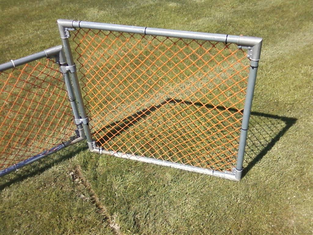

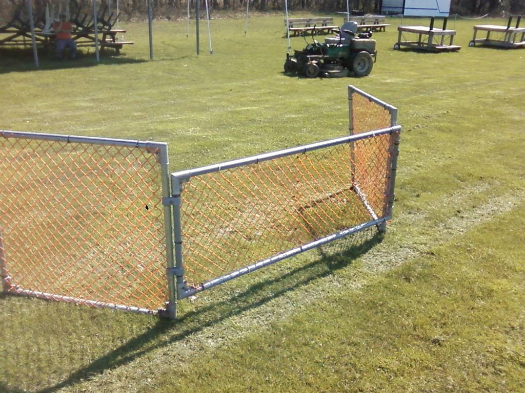

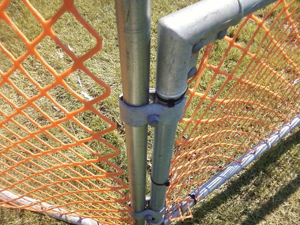

We use chain link fence gate sections,, they fold, just sit there, no staking needed, on person can move them to mow
Edit,, was cutting the grass so I took some close ups for ya

We also use the chain link gate sections. We have two sections joined together, in a"V" shape. No reason you couldn't add more, to make the stations as large as you wanted. They can also be laid down at the end of the day.
