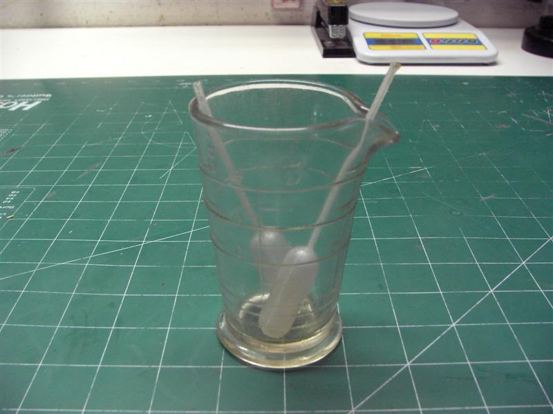

You may want to try abandoning the bottle tips altogether. What is far more effective is to buy large bottles of CA and use the Dave Brown applicators from Tower Here:
http://www3.towerhobbies.com/cgi-bin...?&I=LXB970&P=7
These are keep filled all the time and stored tips up in an old glass as in the picture. The Ca bottle is only opened from the large screw cap to refill the applicators.
These are far easier to work in tight places without the need to lift and position the bottle each time. When the tips of the applicators become contaminated just snip off a bit of the tip. They last a long time and the CA stays fine in the applicators a long time.

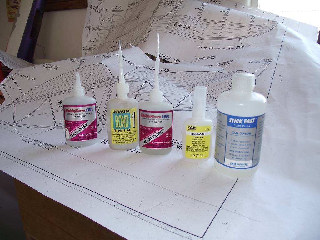

Max, I just save old two ounce bottles and wash them out in acetone, I have never been brand loyal, I have never seen a nickles worth of difference between glue brands. I buy a bag of tips for the bottles, usually at Hobby Town or Hobby People, then I buy my CA at the Wood Workers Supply Store in 8 ounce bottles and just refill the old glue bottles as needed. I have a bottle of acetone and if a tip cloggs up I just toss it into the acetone and put on a new tip. If I don't feel like changing tips I just clip off about 1/8 inch of the tip to clear it. I'm in the habit of squeezing the bottles sides a little to clear the tip when I'm going to set the bottle down for any length of time. They stay clear that way. I use mostly thin CA so I only buy my thick CA in two ounce bottles.
