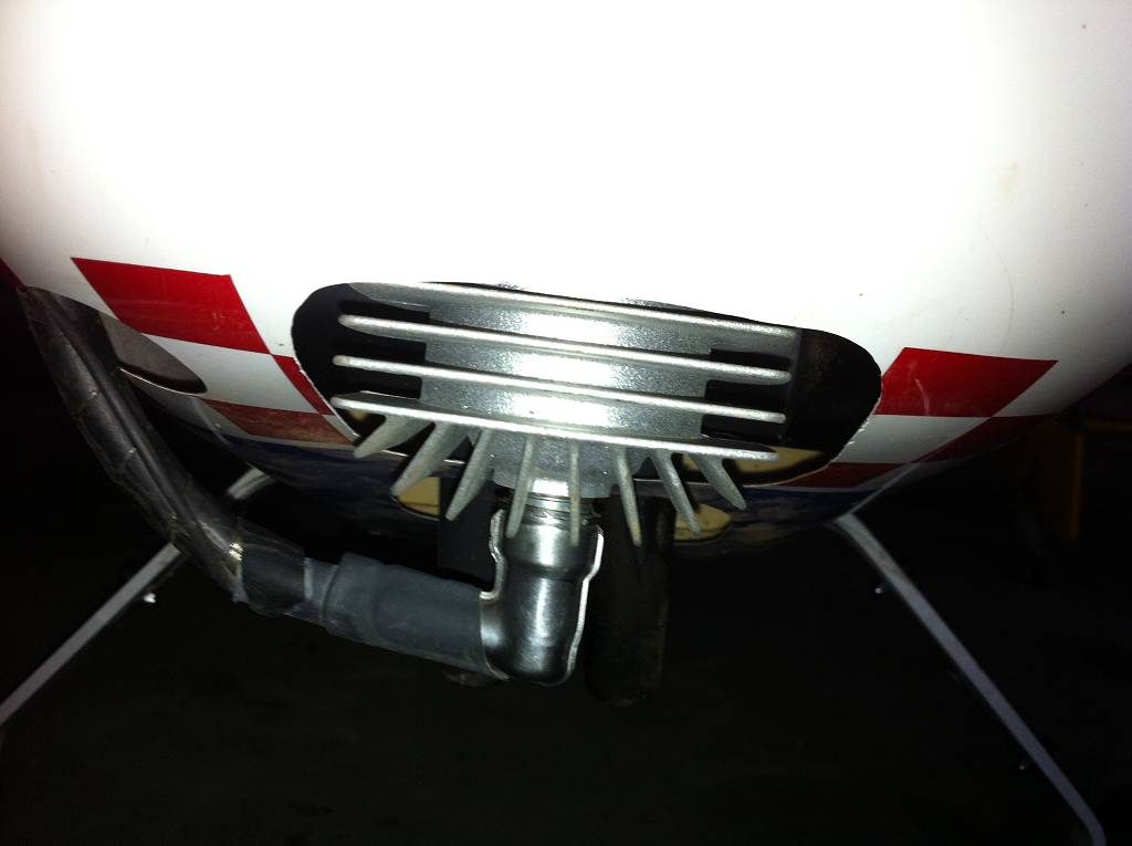

hi
last weekend
took my extra 260 27% with the evolution 50 cc gas engine.
this was the third flight with this engine.
i am still running gas with 1:30 oil mix, which came with engine
was able to start engine and had to play with HSN and LSN.
got engine to turn the 23 x 8 prop at 6400 rpm.
once i felt engine was warmed up, about 3 minutes i would say.
did one final throttle up and down, checked engine could idle and would not turn off
then took off
plane was up in air maybe 2 minutes, or less, then engine cut out. had dead stick landing with damage to prop (35$) and then landing gear broke (carbon fiber).
i have fixed everything since then, and took airplane to back yard and turned engine on again.
LSN is 2 turns out
HSN is 1 3/4 turns out
then after about 5 minutes, of me running engine TWO, then engine started to cut out.
the ignition batteries are lipo, and they are fully charged.
the fuel is new, not old.
i figure something is happening once engine reaches certain temperature. I dont want to say it is overheating.
outside temp here is 88 degrees
and the airplane does have a cowel on, but it has adequate opening and exit is even bigger for airflow.
any one have any suggestions?
BTW, i did remove the spark plug, and the recommended gap is between 0.6 mm and 0.7 mm
the gap i measured was about 0.3 mm
i did regap it to 0.65 mm
will turn it on again tomorrow
however, does anyone think this is the problem?
or any other suggestions?
thank you

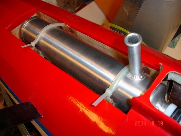

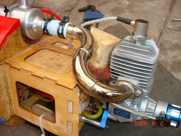

Hi!
How does the engine behave without cowl?
Having a cowl with entrance and larger exhaust opening isn't enough, you must duct the air so it goes true the finns on the engine! That is very important!
What exhaust system do yoy use? I guess it's small silencer as the rpm is soo low (6400rpm wih a 23x8 prop).
In comparance my MVVS .45cc (Evolution in the US) turns a 24x8 Mentz prop at 6500rpm using the MVVS small cannister silencer.
How does the front ball bearing feel like? Do you have much play in the bearing?

Old 06-02-2012 | 04:50 AM
Joined: Dec 2011
Posts: 1,047
Received 36 Likes on 31 Posts
From: shreveport, LA
Default RE: evolution 50 cc gas engine troubles
these are pics. do you believe maybe not enough air in?

Old 06-02-2012 | 07:40 AM
Posts: 7,816
Received 10 Likes on 10 Posts
From: Upplands Vasby, SWEDEN
Hi!
With the cylindersticking out like that I see no problem with cooling. But what kind of silencer do you use? I recommend a cannister typ silencer like the one I showed above. Much more quiet than a small silencer and you get more power. I modified my Hi-Model Yak-54 so I could use the MVVS No 3206 cannister.

Old 06-02-2012 | 08:17 AM
Joined: Dec 2011
Posts: 1,047
wow
that is nice.
great job!!
so the cooling is not an issue
do you beleive the spark plug gap could be the problem?<br type="_moz" />

update
just got back from flying plane
engine did not stall this time.
flew plane for about 12 minutes
still had 1/3 tank of fuel left.
i did open up the LSNsome, and regapped the spark plug.
i will open up the cowl some more, just in case!!

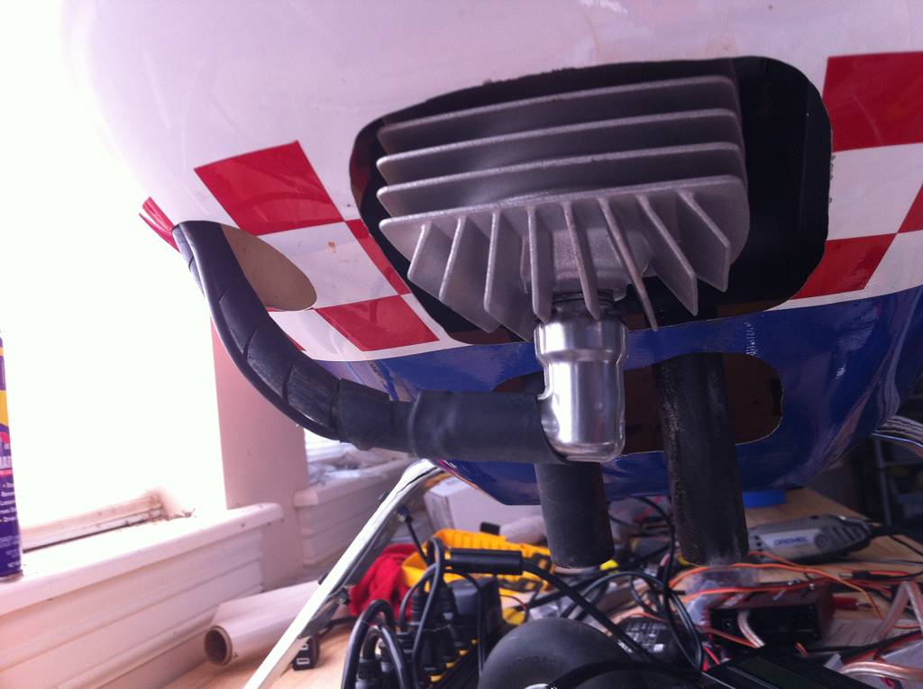

Can you snap a picture of the bottom of you cowl? You should have a bigger hole in the bottom them you have in the front. Hot air needs to get out. 1:1 is not enough, need more than that.
Old 06-02-2012 | 01:56 PM
Joined: Dec 2011
Posts: 1,047
ORIGINAL: scooterinvegas
i love your signature, BTW!
tell me what you think, should i open it up more
i appreciate your advice.

Old 06-02-2012 | 04:43 PM
BarracudaHockey's Avatar
My Feedback: (11)
Joined: Jul 2003
Posts: 28,268
Received 443 Likes on 362 Posts
From: Jacksonville, FL
Is that ignition rated for 8v? Most run fine on a 4 cell pack.

Old 06-02-2012 | 07:18 PM
My Feedback: (15)
Joined: Oct 2011
Posts: 281
From: Spring Hill, FL
Check how you have your ignition module mounted. They all seem to require an air gap. If it is mounted flush to the motor box, (or wrapped 100% with foam) the ignition may be overheating causing the cutting out.

Watching the video, nice landing btw, and reading the caption below it, the engine did sound rich. Unlike glow engines gas engine are not suppose to be tuned rich for breakin. That is accomplished by oil to gas ratios suggested by the manufacture.
A gas engine is to be tuned for max performance, i.e. set the hsn for max rpm then back off slightly, and lsn set for best throttle advance from idle.
A breakin period usually is a 24-32:1 oil mix  then switch to 40-50:1 oil mix after a specified amount of runs with the engine.</p>
