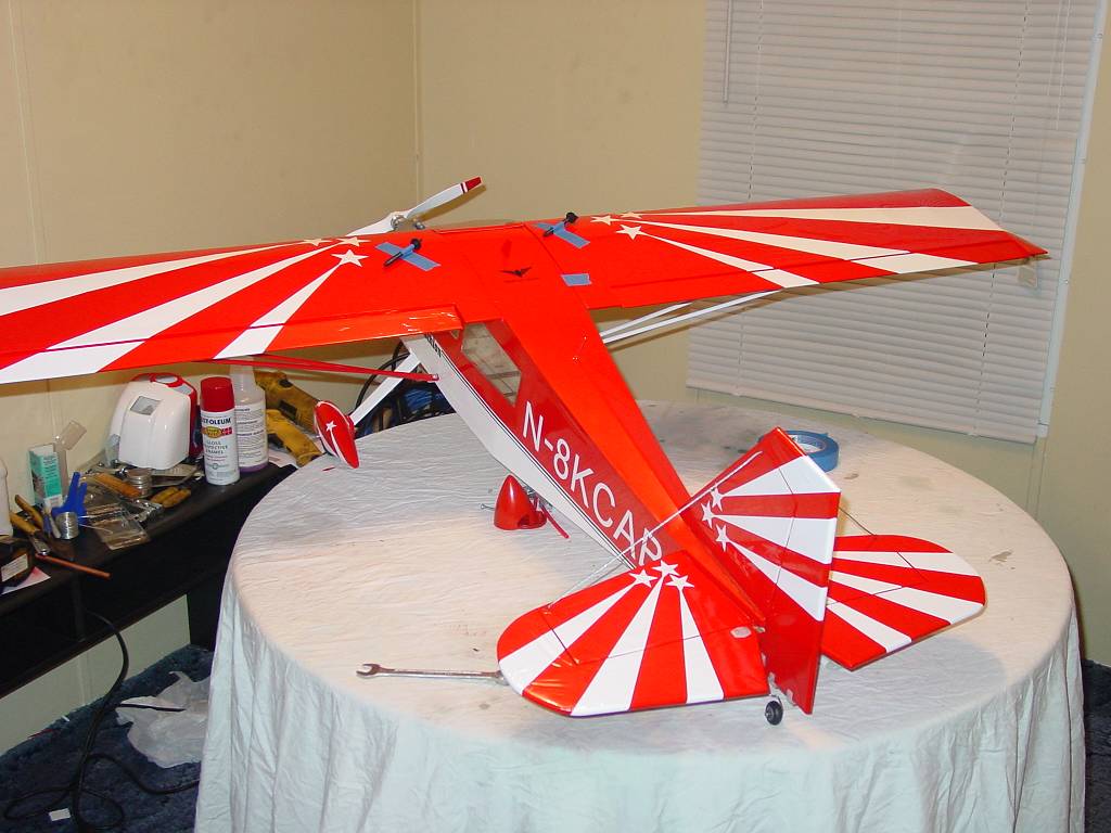

Which IsBetter On A Ar600 Spectrum Receiver The Videos Iv Seen Shows The Full Lenth Of Both of the antenna's Being Placed inside the fuse is this fine for the dsmx or would it be better to place the long antenna out the fuse make sure the short antenna is still 90 degrees from the position of the other inside or outside is the big quetion thanks

Both inside

Ok Thanks Thats what i wanted to hear I didnt want it outside of the plane

Putting them outside is really only a factor with a carbon fiber fuselage. The CF is a pretty good blocker of the 2.4ghz signal, so you need antennas outside of it to get good reception.

Like the guy before me said, on a balsa or foam plane, just keep it inside. 2.4 Ghz is a beautiful thing. Years ago we had to run the antennas outside , or loose your plane. Unless you have a lot of cf in your plane, just run them where it's convenient for you. I usualy run a satellite receiver down to the tail as I'm building the plane. BTW, nice looking decathlon. Who makes it? I just picked up a seagull super decathlon 120, and a DLE 30 to power it. Good luck, Steve
