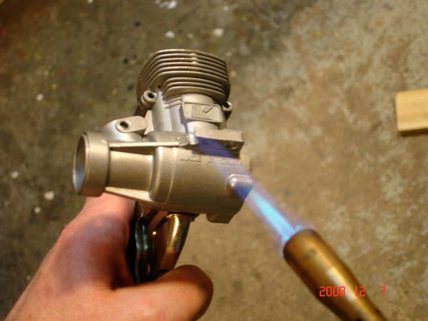

Old 05-13-2013 | 04:53 AM
Posts: 7,816
Received 10 Likes on 10 Posts
From: Upplands Vasby, SWEDEN
Default RE: Changing bearings
Hi!
Same here, a propane torch
ID:	1881145   Click image for larger version
ID:	1881146   Click image for larger version

Old 05-13-2013 | 06:31 PM
ewormm's Avatar
My Feedback: (36)
Posts: 69
From: indianola, IA
Thanks for the info! I will try torching the case and pushing the bearing in on the crank. Sounds simple.

A torch can warp the case by over heating an area more then another. I have done it but I just drop the case in a pot of boiling water to get the bearings in and out these days. Never have had to freeze the bearings to get them in. Oven, water, torch, what ever works for you, it isn't a hard thing to do.

Back in the oven for 10 minutes at 300 worked like a champ for installation. That's will be my routine in the future. I agree with the suggestions above that a torch would work but unless you have no other way, why risk uneven heating or too much heat?

Why you ask?
Mainly since the oven heats the whole engine, including the cyl bore. I really don't want much distortion going on there other than what is induced while running. Using the torch keeps the heat very localized to where the bearings are and not moving the rest of the engine.
It may or may not make a difference but in my work I use heat for straightening shafts often and have a good idea of what heat can do and it just makes sense in my small brain.
