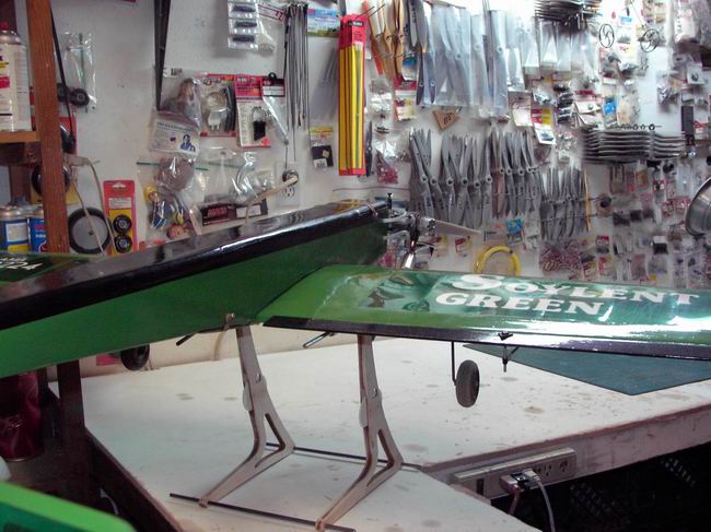

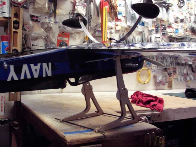

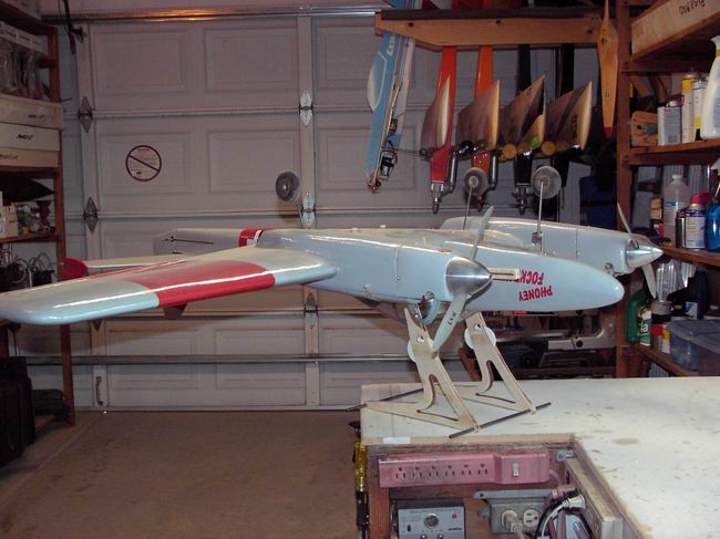

For those who balance on simple pivoting device (store bought or homemade) here are some examples of different airplanes that were either checked/balanced right side up or inverted as needed. The device here is the old Sig kit balancer currently discontinued which has ball bering pivots.
Each of the airplanes are stabile enough to be unsupported in the pictures and most cases its easy to see that there is sufficient mass of the airplane below the actual pivot point to allow it to balance without holding.
John

John, thanks for posting those pictures, they do show a nice way of establishing where the current balance point is and one can easily shift the CG point and verify the new location. Personally I am not hung up on what device to use. If someone wants to spend 300.00 on a custom rig then that's his choice to make. I just don't want to mislead anyone into thinking that an expensive rig is needed. We all seem to agree that CG is something we need to verify before flight but my goal is to let guys know that CG is a trimming tool and can be used to improve the performance and make an airplane easier to fly.
