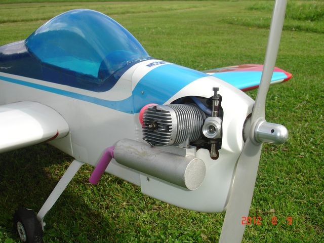

Hi!
Come on guys! The best and easiest way of balancing a plane is using the your fingers!
Been doing so since I started flying R/C 40 years ago.

Hi!
come on Jaka! Your claim that the "best and easiest" way is using your fingers. Well now fine however that completely leaves out the individual and the airplane so your claim that there is only one best and easiest method is totally invalid.
For example I will use my self as an example. There is no way I could ever even reach the balance point on both sides with my fingertips from my wheelchair nor is there any way I could ever lift that much weight anyway on my fingertips with some of my airplanes. No sir there are many ways to acheve the goal and its a disservice to diss all methods except what works for oneself.
Threads like this are vary helpful to many and those seeking the various methods that may serve them better than what they were formerly using.
John

Hi!
I understand that there are some people that cannot do what I say but to most of us there is no problem lifting a 0-15kg model airplane with our fingertips.
What I want to point out is that you do not need any fancy gadgets to balance a simple thing as a model plane.
And further more...I get the impression that some people think that balancing is only done once. Which is certainly not the case.
To have a good (perfect) flying plane you have to villing to adjust the Cof G perhaps many times (moving the servo, bttreries ) untill you get the balnce point as you want it.
And the rule of thumb is to get it as far as back you can without having the plane behave badly in any way.
