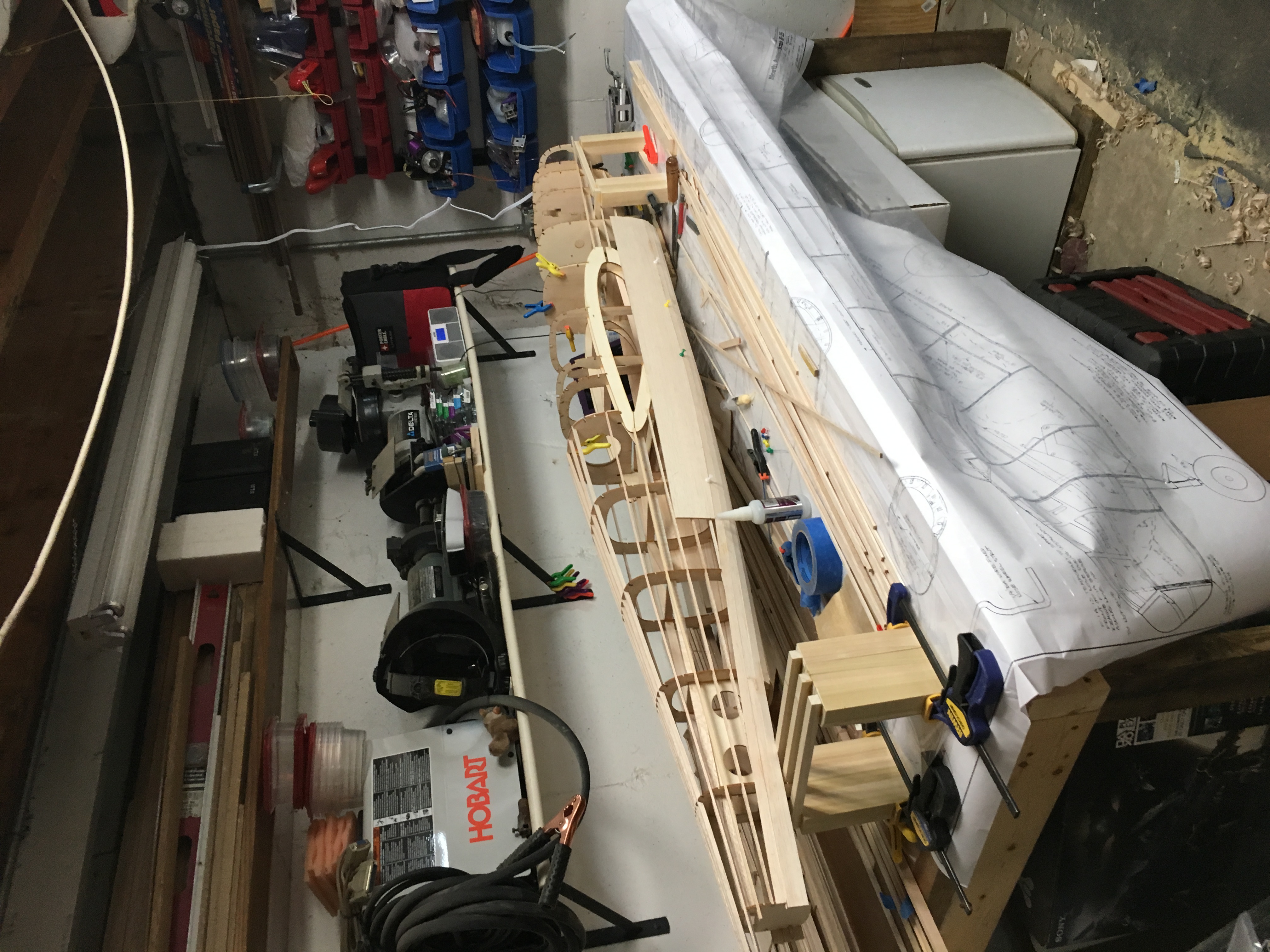

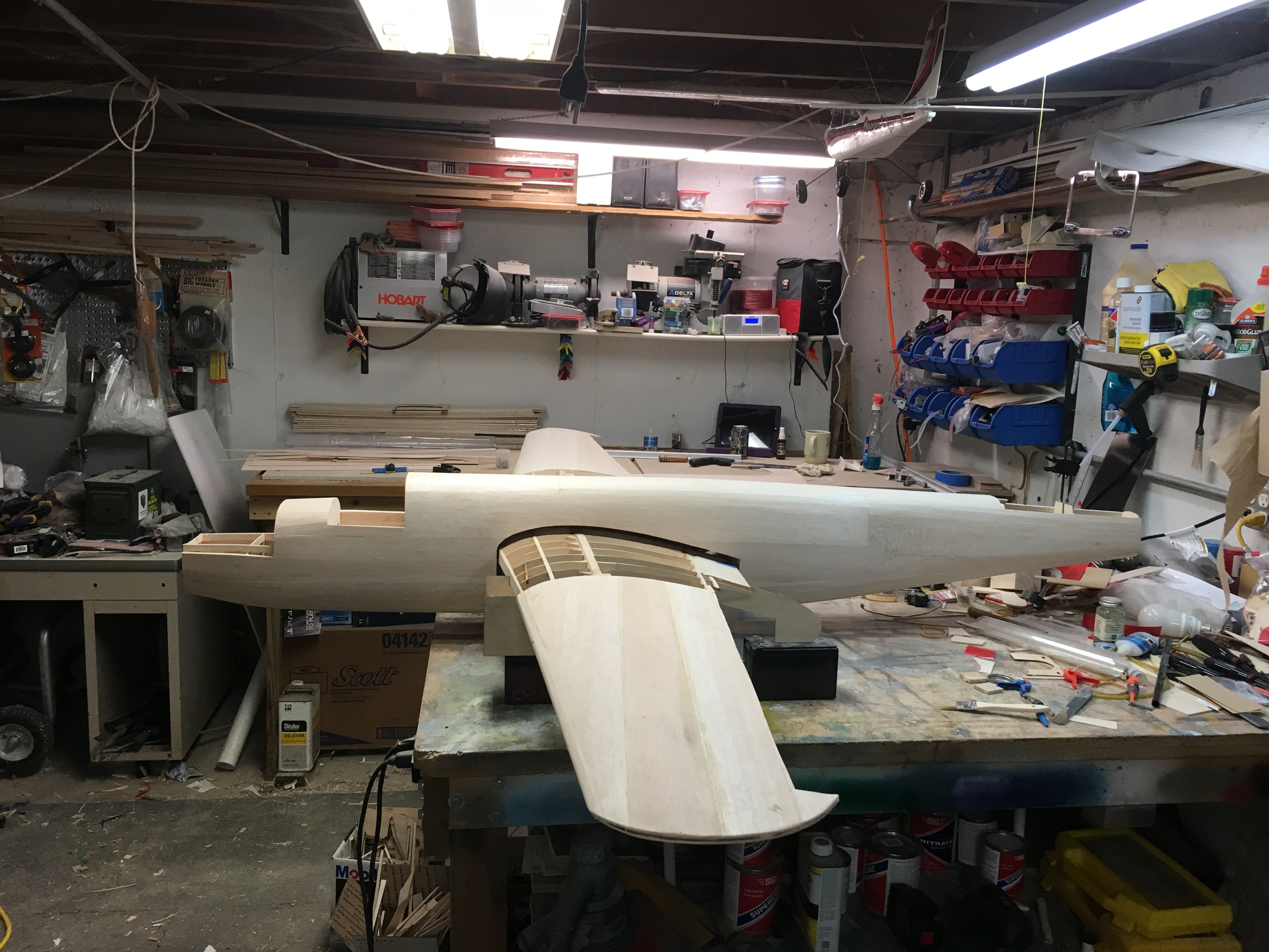

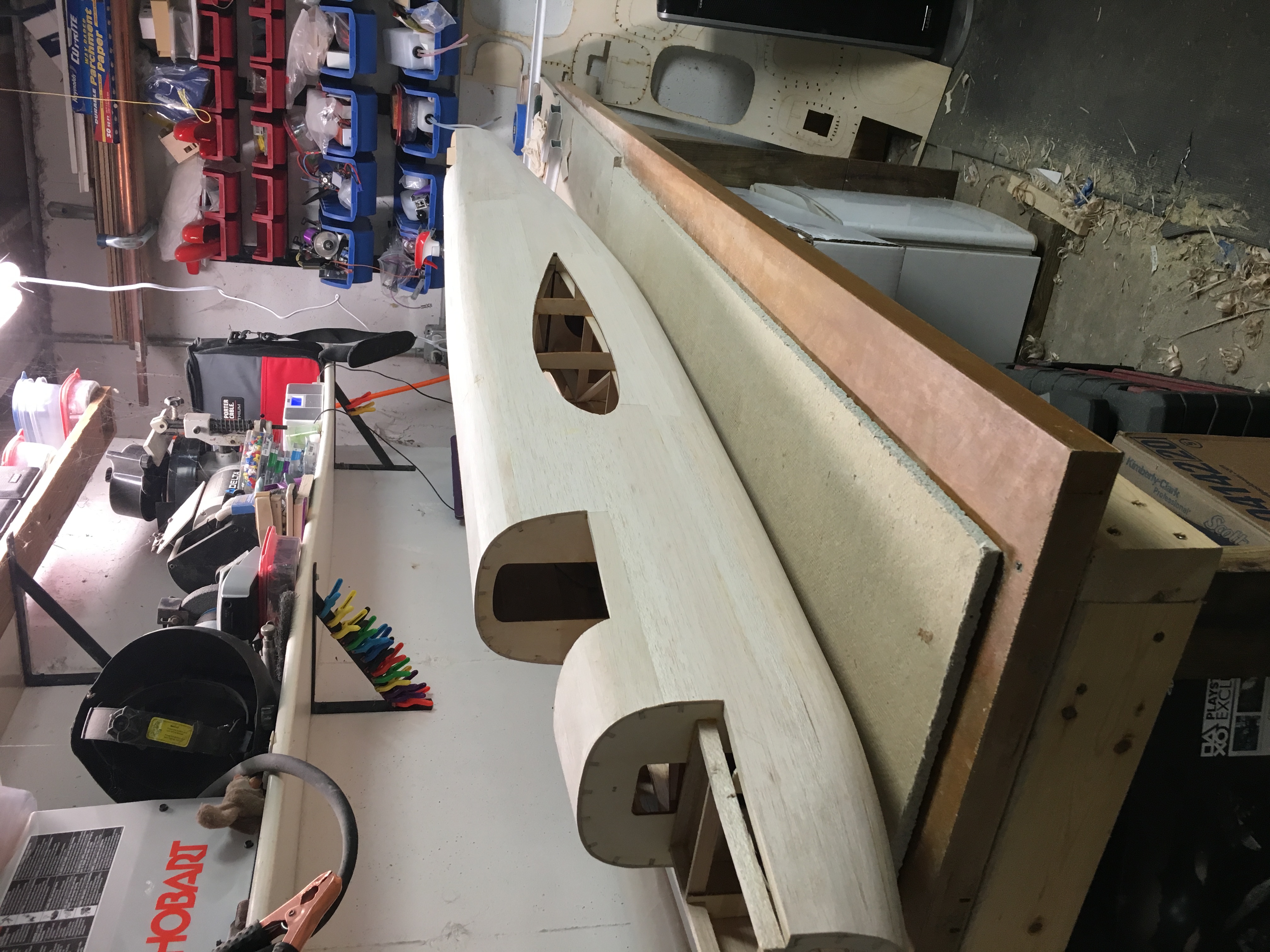

Old 12-11-2016 | 07:51 AM
Joined: Jan 2011
Posts: 10,075
Received 108 Likes on 96 Posts
From: Capron, IL
What I got done so far using the two glue method. The only place I needed to pin was the large sheet on the side.

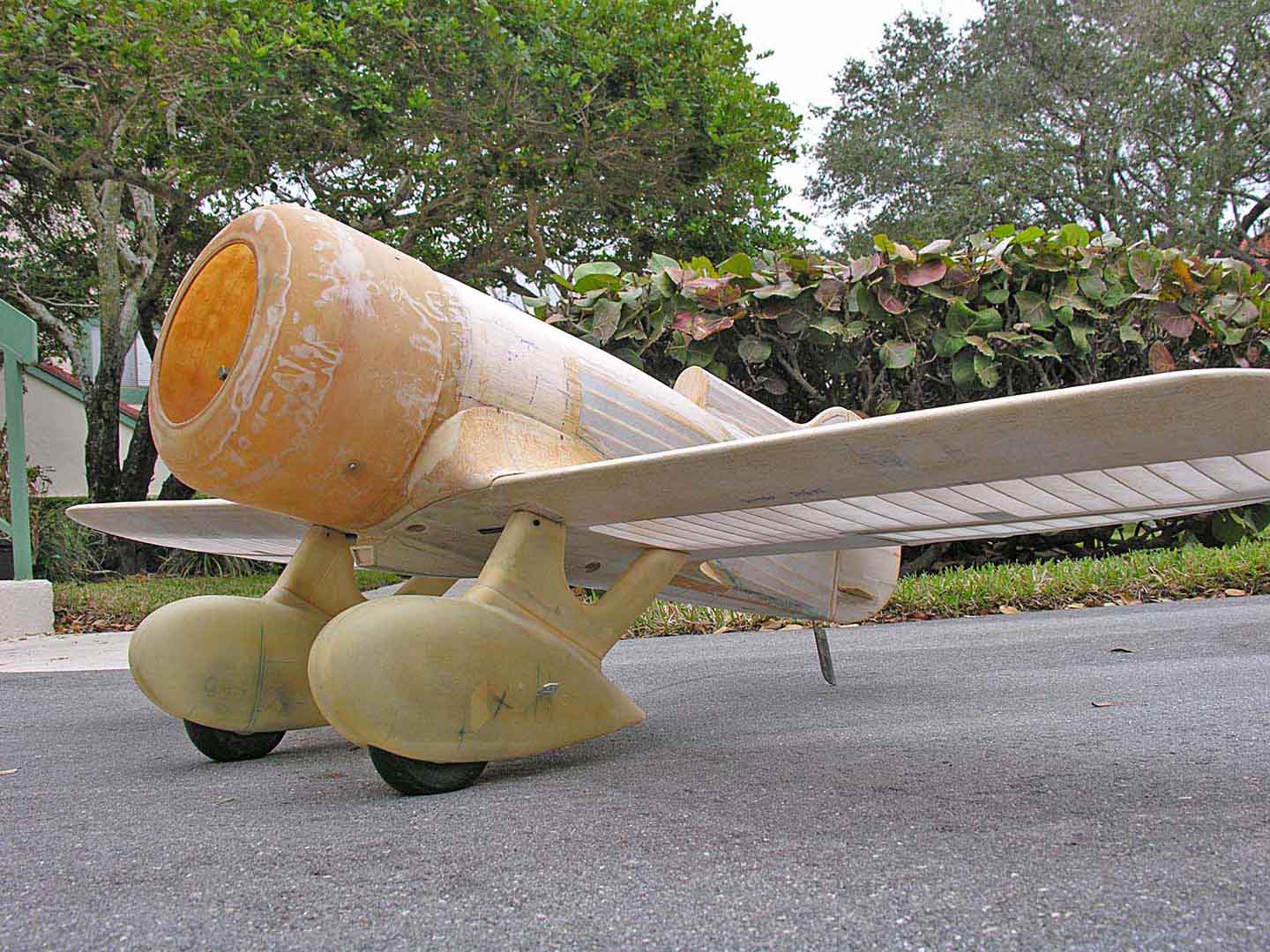

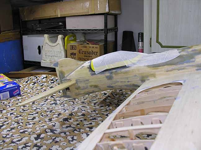

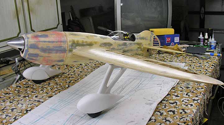

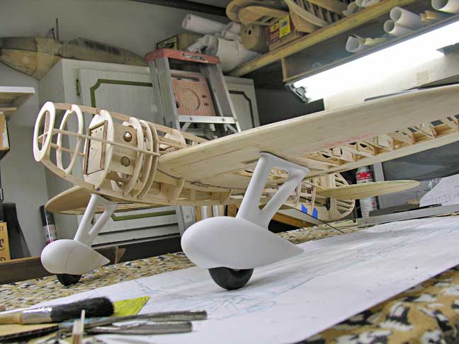

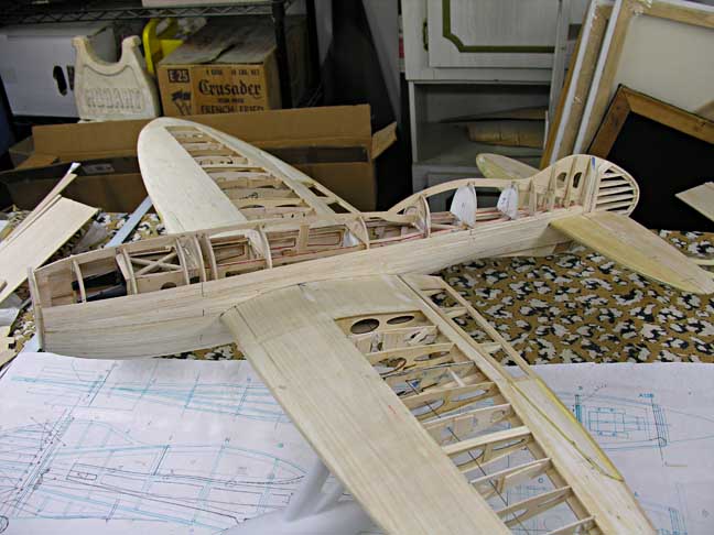

Old 12-25-2016 | 08:30 PM
Posts: 3,157
Received 6 Likes on 6 Posts
From: Jupiter , FL
acdii,
I've planked a few models in my time.
Here's the latest and it's current, in fact I started prepping it for silk covering.
Believe it or not all I use is CA. I put a dab here and there on each applied plank. The fit is key.
Charles

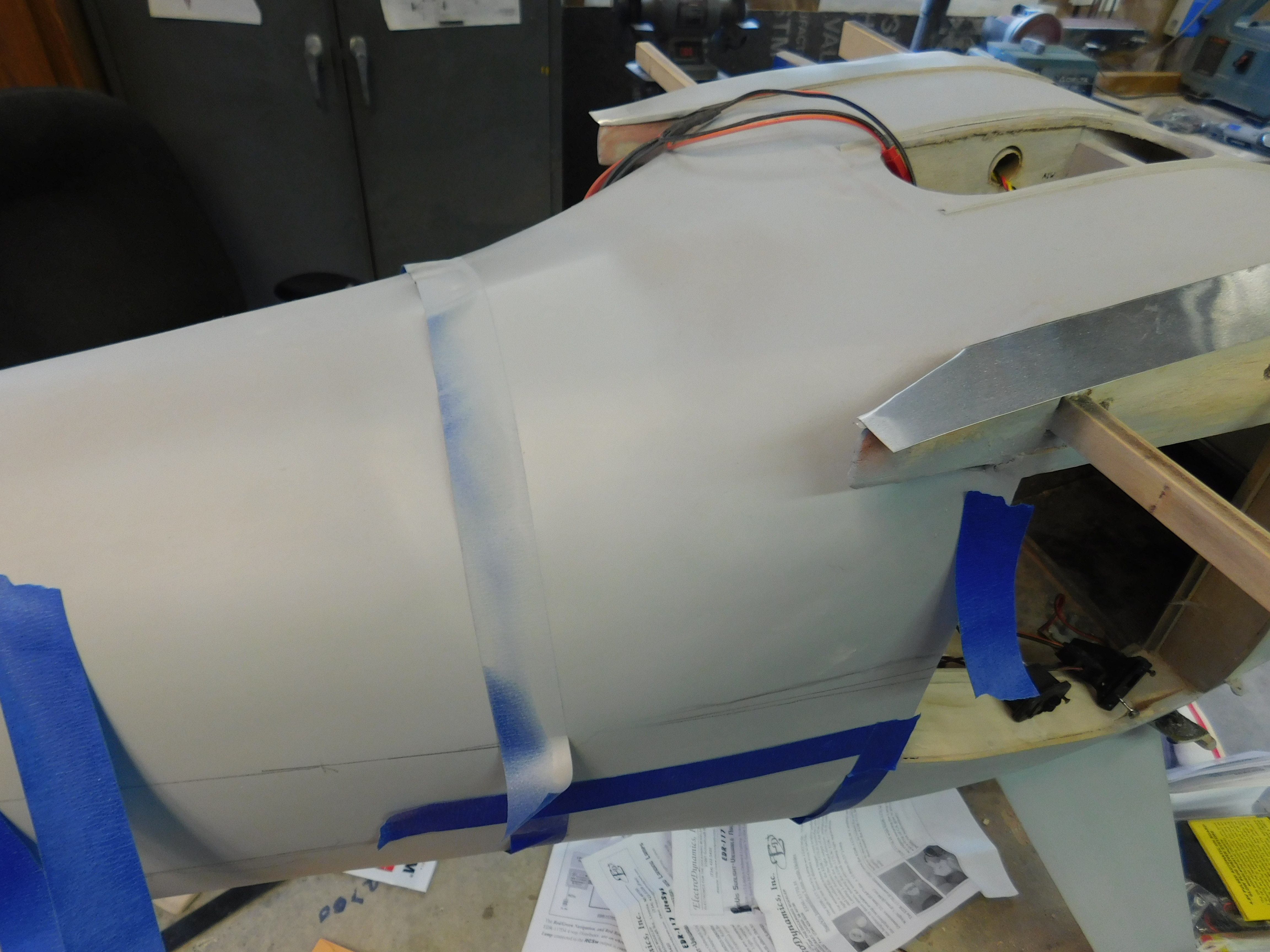

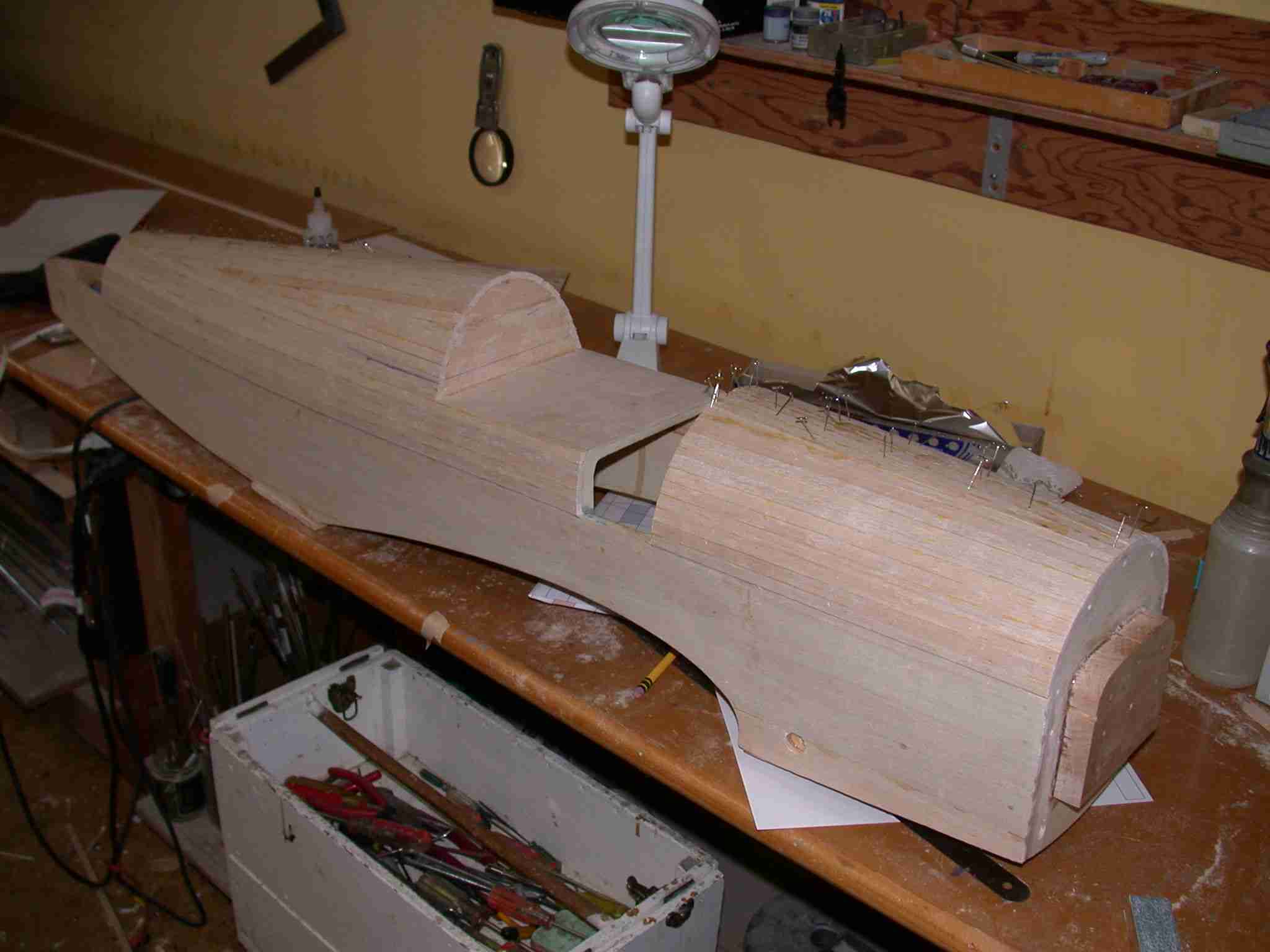

Old 12-25-2016 | 08:36 PM
Joined: Jan 2011
Posts: 10,075
From: Capron, IL
Got the fuse planked, no different than doing a boat hull, only much bigger and easier. Could have used my proportional dividers to make it easier, and my ships curves, but they were put away.

Old 12-25-2016 | 09:58 PM
Posts: 3,157
From: Jupiter , FL
Dan,
Really nice planking, and that is planking.
Charles

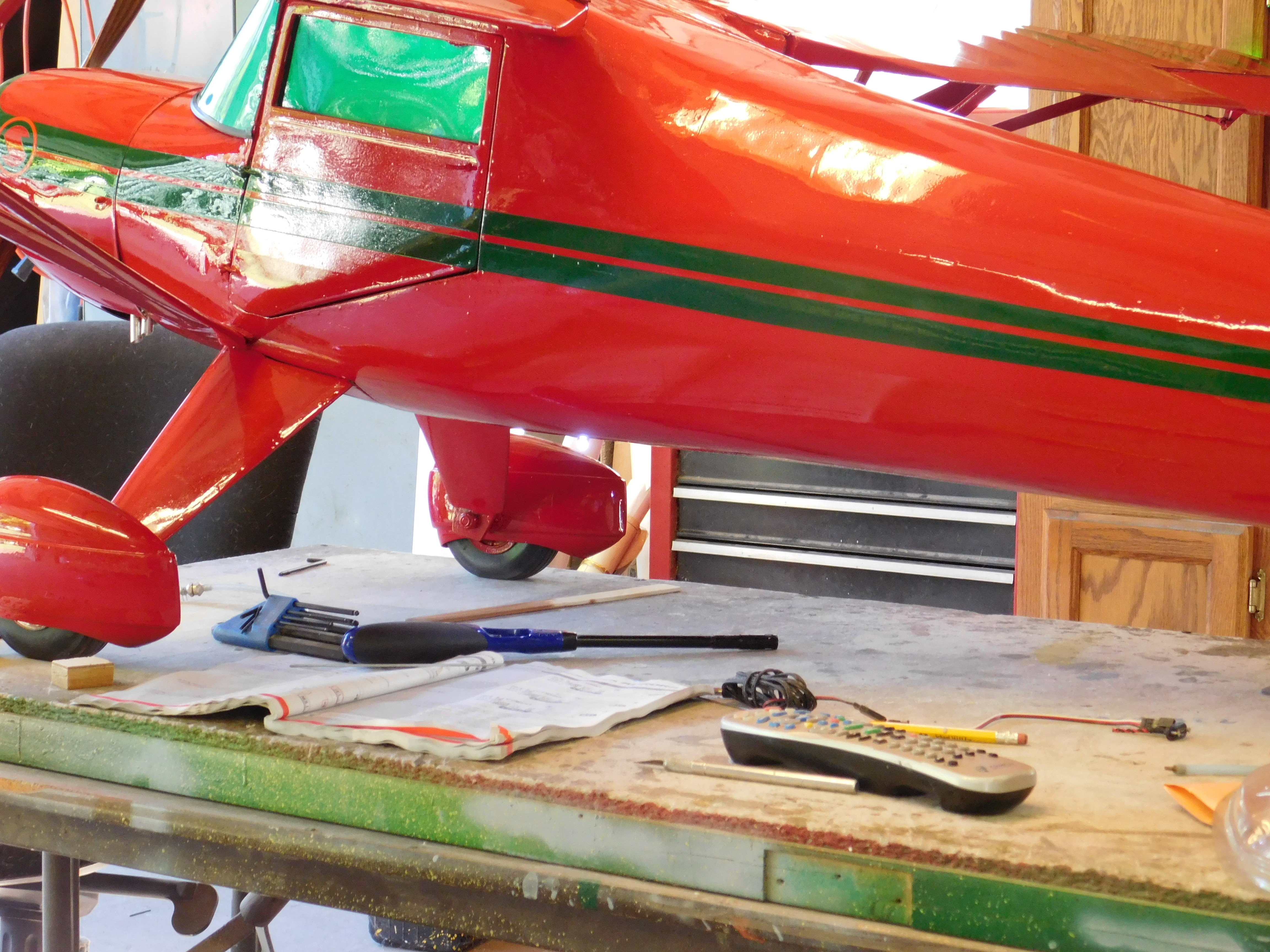

Old 12-26-2016 | 04:21 AM
TomCrump's Avatar
Joined: Apr 2003
Posts: 7,614
Received 5 Likes on 5 Posts
From: Traverse City, MI
I use CA, too.
ID:	2194330   Click image for larger version

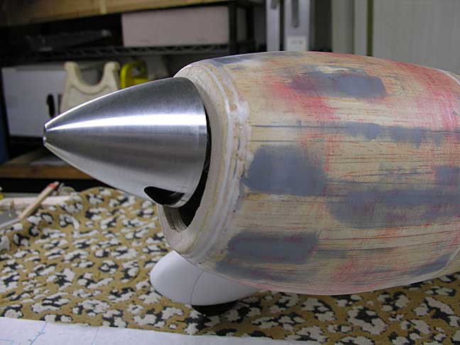

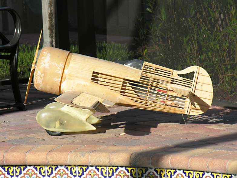

Old 12-26-2016 | 07:53 AM
Posts: 3,157
From: Jupiter , FL
Tom,
Nice work, nice finish!
I posted to be a member of the Brotherhood. Do I get a Brotherhood number?
I've been using a white primer out of an aerosol can.
This GBZ is planked.
Charles

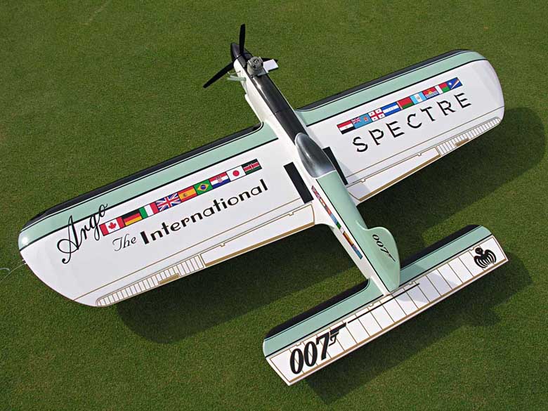

Old 12-26-2016 | 12:09 PM
Posts: 3,157
From: Jupiter , FL
Originally Posted by TomCrump
Mike will issue your number when he gets a chance.
Tom,
I see #1 and #2 are taken. :-(
Think I can have #0? Yes I'm kidding.
Maybe #007
That could work.
Here's one reason why.
Charles

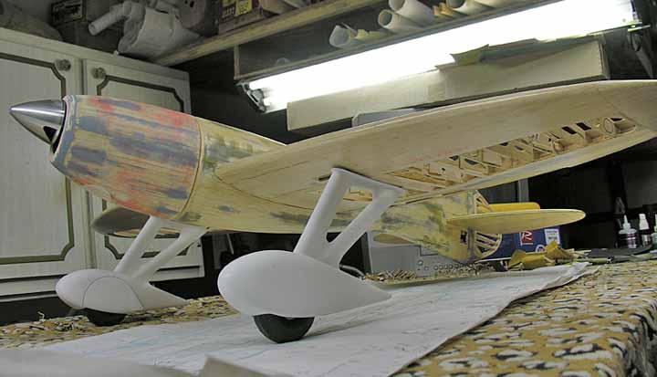

Old 12-28-2016 | 04:17 PM
Joined: Mar 2003
Posts: 1,249
From: Mt. Pleasant, OH
I use old fashioned model airplane cement. Sigment, currently. It dries reasonably quickly and sands very well. I run a bead along the plank, use a drop of medium CA to hold it to the former at the beginning, then pin the strip about every two inches or so.

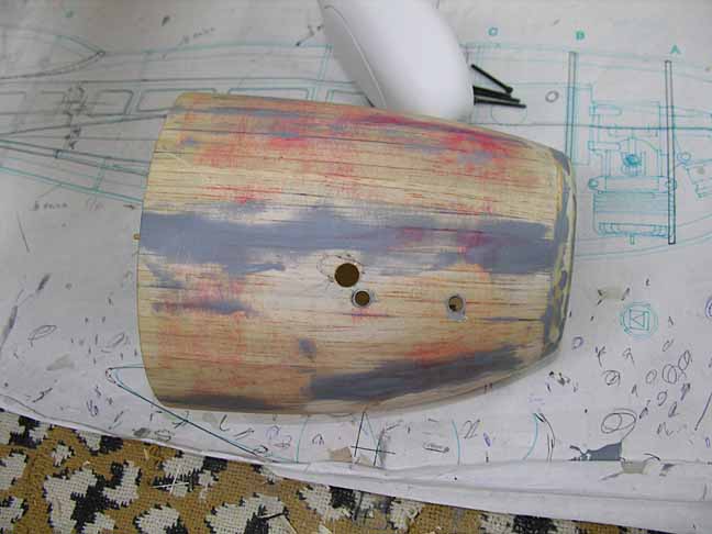

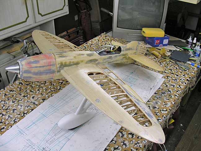

Old 12-28-2016 | 05:36 PM
Posts: 3,157
From: Jupiter , FL
OK,
There's more than one way to skin a cat. I know, terrible expression..
I've never used anything but CA and I never used a single pin.
With CA, as I said, I use a dab here and there so sanding the thing round becomes easier.
I use .125" contest grade balsa only. Planks can vary but .25" or just a tad thinner is what I have found to work well.
I hand sand/bevel so each piece is tight.
CB
