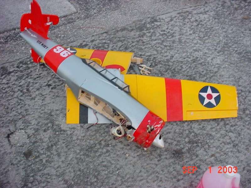

Joined: Jul 2003
Posts: 216
From: Jackson,
TN
Snapped my GP T-6 during test op flight never got to enjoy it. CG was set to spec w/ a O.S. 52 Surpass in the nose (it was about 3/4" forward). The club expert said I had too much elevator throw. Watch your control settings and keep them MILD as possible.
