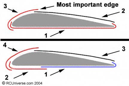

Ditto, I like to wrap the top covering around the LE so the seam is facing with the airflow.

I usually cheat:
