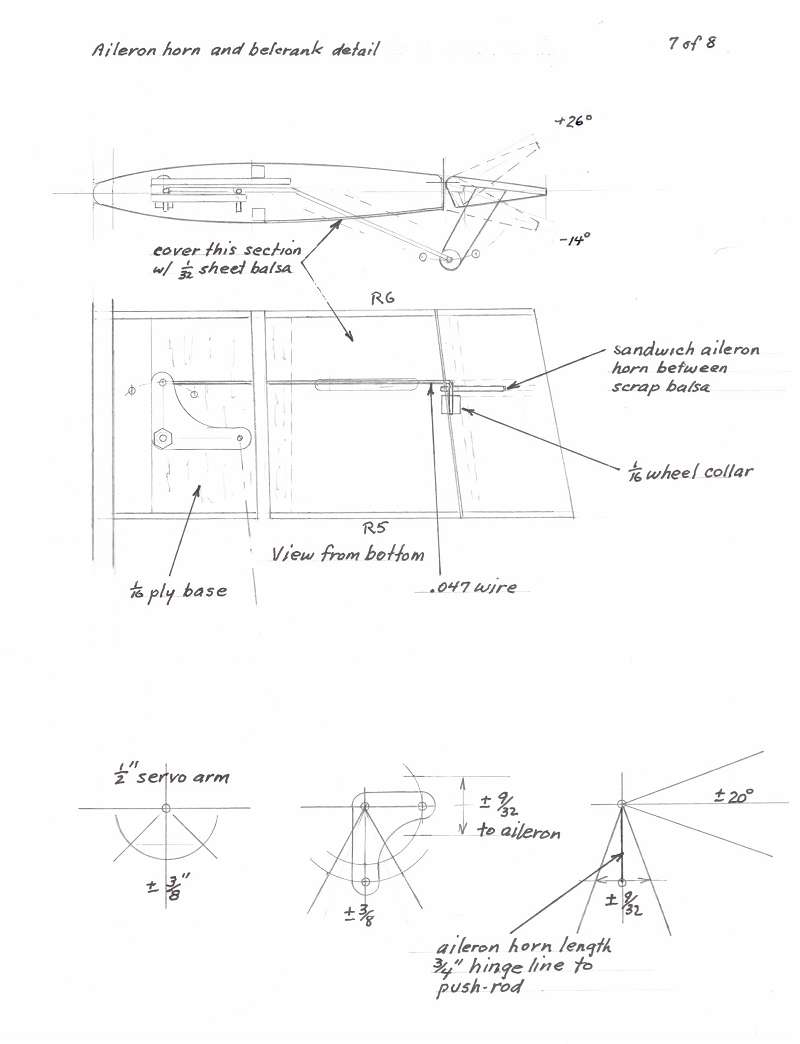

Perhaps a picture is worth a thousand words - so, see the attached pic which shows how to translate rotational degrees to linear throw and linear throw back to rotational degrees. I assume by now that you know how to set up your servo for stop to stop degrees of rotation. In the case below, I have set the servo for +/- 45 degrees ( 90 deg total throw) and a standard control arm hole of 1/2"; this translates into 1/2" linear throw. The belcrank in the wing acts as a throw reducer to accommodate a smaller aileron control horn. By drawing in the +/-20 deg aileron (or whatever deflection you want) and locating the linear throw, the control horn length from the hinge point to the pushrod point is determined to be 3/4 inches. A slight offset of the aileron horn causes the differential throw for adverse yaw correction.
You can use this same concept for determining and adjusting your flap control.
If you need further help, then you will have to give me specifics - such as your servo degrees of rotation, servo arm length, and what kind of output throw or rotational degrees you want. I assume you have decided on your mechanism for the fowler flap movement and just want a particular throw.

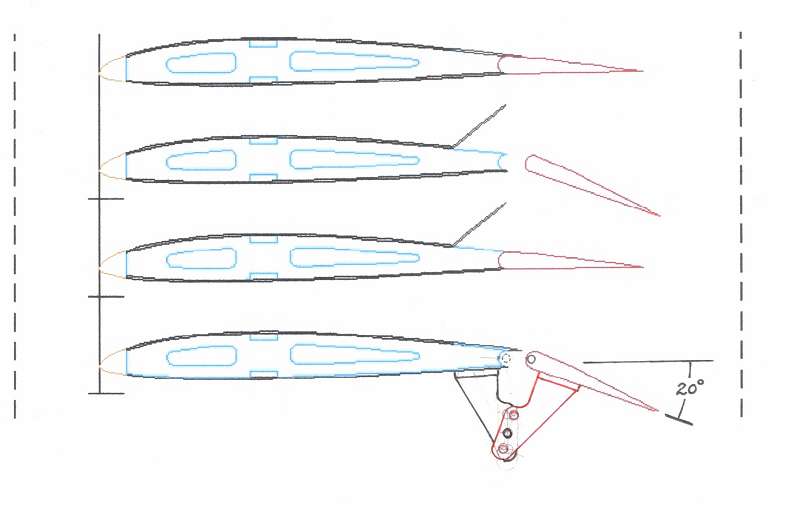

I have two competing ideas, one uses the track idea where the flap follows two grooves cut into a rib. The other uses a linkage to turn the flap down and a groove move the flap back. One of the issues is only having about .3 inches to work with for total height. It's a 25% of chord flap on a 6 inch chord with a 25% of chord airbrake starting at about 60% of chord. There is a .5" overlap of the airbrake and flap. Like I said, pics to come...

feihu,
I am designing the mech now, which is the problem. You're pic is exactly what I have been struggling with, namely, "How long are arms and 90 deg control horns?" I can handle the math part (AutoCAD 2004 rules!), but I need to know how to apply it for my needs. I figured out a curve that would seem to be correct based on the chord as it would rotate when the flap is extended. Without building a small test setup, I can't tell if it would work. Let's say that I plan on buying some plywood and making some test ribs this weekend...

Ha! Picture!
Here you can see all open, all closed, brake open and flap open. Barring that, you can see the basic path I hope to get out of the flap.
[link=http://homepage.mac.com/mikejames/rcu_flaps_site/highlift_images/thunderai_meridian/flap3view.jpg]This article[/link] is what I was basing my idea off of. I had thought about using push rods to do the rotation of the flap.
Dang wheels... They're all in need of improvement.
