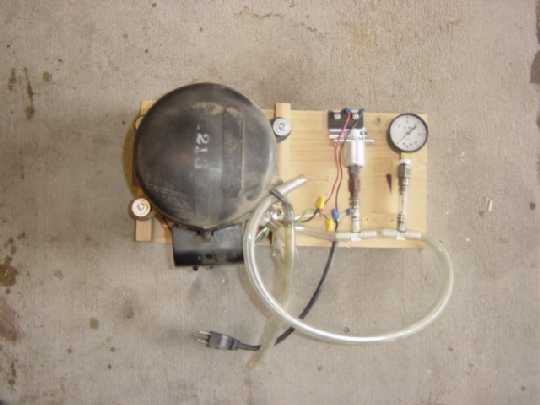

I built my own out of a refrigerator compressor, a schedule 80 PVC chamber. The parts were picked up from an old surplus shop in San Jose, Ca. (Including the adjustable vacuum switch and solenoid/check valve)
I did purchase a few parts from ASC in San Leandro, CA. (Tube/sleeve bag material, peel ply, hose, hose/bag fitting, bag sealing clips, and vaccum gague.) They are a top notch shop in my book. Professional and quick. Prices seemed pretty reasonable. I wouldn' t hesitate to deal with them again.
I will post a few pictures of my system later tonight when I get home.
It took me less than a day to assemble the entire system.
Everything combined was under $120.00.
Ted

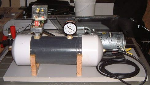

Posts: 1,642
From: Nederland, Tx.
Default Vacuum bagging system recommendations
Here is pic of my home brew vacuum system. The pump is an old refrigerator compressor. The gage is a cheap auto vacuum gage. The adjustable vacuum switch is from a United Electric industrial vacuum switch.
Vince

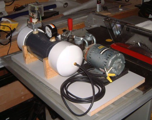

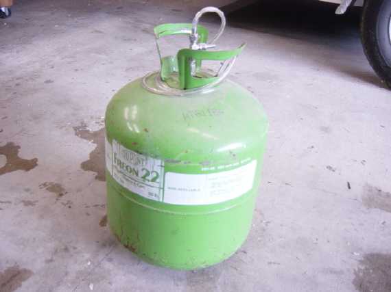

Old 07-16-2002 | 07:16 PM
Posts: 1,642
Here is a pic of my vacuum reservoir, it's just an empty 50lb freon cylinder.
Vince

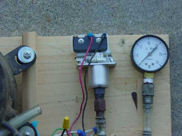

Old 07-16-2002 | 07:36 PM
Posts: 1,642
A close up of the switch and gage.

Old 07-17-2002 | 01:25 AM
Posts: 332
From: Greenville, SC
Hi Vince, thanks for the pics...not to complain, but the last picture didn't get attached for some reason. Very helpful and I'd like to see the switch and gauge close up. Thanks again!
Old 07-17-2002 | 05:32 AM
TRP
Posts: 234
From: Bay Area, CA,
Here is a shot of my system from the front...

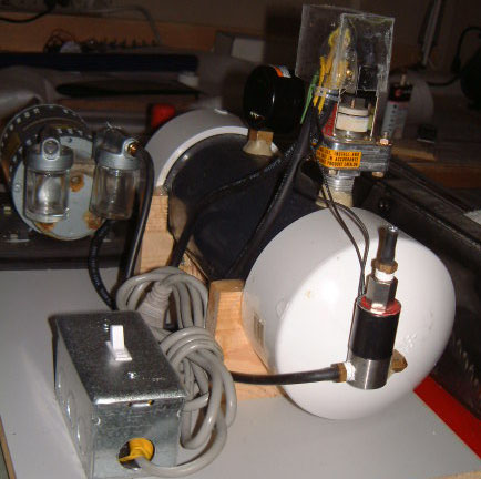

Old 07-17-2002 | 05:38 AM
TRP
Posts: 234
From: Bay Area, CA,
Here is a shot of my home made system from the back..
In this shot you can see the on off switch. When the system is turned on it will operate to the pressure you have dialed in on the pressure switch (funny thing with the lexan box on top of it.) The pressure switch then shuts off the pump and closes the check valve / solenoid. Once the pressure drops below a desired setting... the whole thing will kick back on and continue to operate until the desired setting has been reached again.
The the entire process starts over again - for as long as you leave the system 'on'.
The system has been tested and so far it looses about an inch of pressure for every three hours it is in use. Pretty respectable - I should track down the leak.... but it only cycles every 5 or 6 hours (give or take) so I am in no hurry.

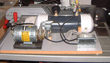

Old 07-17-2002 | 05:40 AM
TRP
Posts: 234
From: Bay Area, CA,
Here is a shot from the side...and a bit behind it.
You can see the coil of rubber hose that leads out to the bag and bag fitting.

Old 07-17-2002 | 06:16 AM
TRP
Posts: 234
From: Bay Area, CA,
In the shots you can also see that I mounted the pump on some solid rubber mat to keep the vibration down to a minimum. I also mounted the entire system on the solid mdf and screwed 8 rubber feet on the board.
The end caps on the tank are schedule 40 and the tank body is schedule 80 pvc. I mounted the 'tank' to the board using some 1 by stock that I cut to form a saddle so it rests in there really nice. I then epoxied the tank to the saddle and screwed the saddle to the base from the underside.
I have since cut two handles in the base so I can pick up and move the entire contraption with ease.
It shouldn't take more than 3 or 4 hours to assemble your own system once you have all the materials together.
Special thanks to Luvara racing and Gordon McSomething or other for help with locating some of the materials to complete this project.
